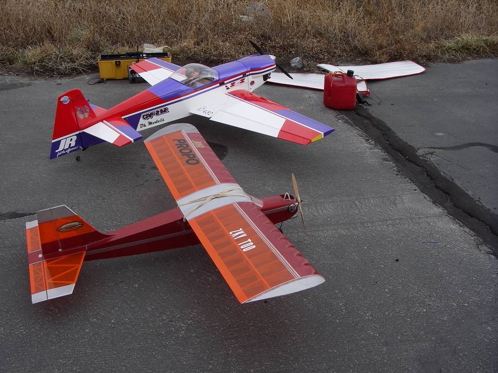

Hope, just won't do the job. The Cap in the picture is 13+pounds and 1100 squares with a 40ccengine and a carbon fibre tuned exhaust-and 7075T6 cystom made gear - it has solid foam panes on all surfaces and an all balsa fuselage it LIGHT by any standards.
That construction was done for again-best strength to weight - The model is an all out 3D /pattern setup
I mention this to show the different approach-for different tasks
