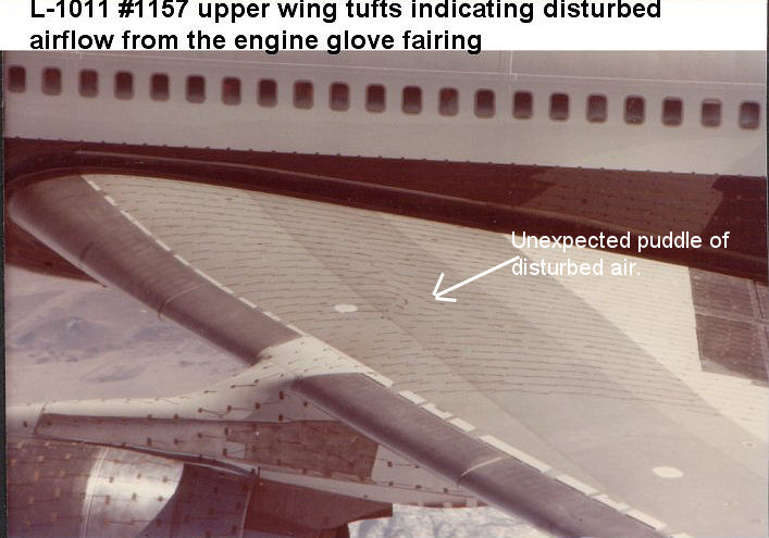

Tufting for airflow studies on the L-1011.

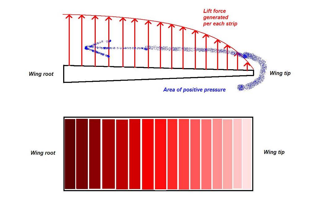

Tom,
This is how I understand the phenomenon:
ORIGINAL: tomfiorentino
1. How is the angle of attack across the semispan different (particularly hard to understand on the rectangular wing)?
The wing forces its path through the air, creating a disturbance with its shape.
That disturbance is no accident or chaos, it is meant to create an acceleration and deceleration in the flow of air, which produces pressure imbalances, as we all know.
That pressure imbalance sucks the air that is some distance in front of the leading edge upwards (upwash), and also pushes the air that is left behind the trailing edge downwards (downwash).
The stronger the disturbance, the higher the pressure differential, the lower level respect to the LE and TE the upwash and downwash reach.
Upwash makes the wing hit the air that is moving upwards; hence, the real AOA (or induced AOA) is higher than if it is measured respect to the geometrical direction in which the wing is moving.
The high pressure under the bottom is pushing the air into the lower pressure above the top of the wing.
The easiest path is around the wing tip, and the second easiest path is around the LE.
However, the stream of the downwash makes that path around the TE difficult for a vigorous stream, and no so difficult for a weak stream.
Now, let’s take the top surface of a right half wing for example.
Let’s divide the semi-span in several narrow strips running between LE and TE.
Along the chord of each strip the air is accelerated and its pressure is reduced as it should.
The left side of each strip sees lower backpressure from the strip on the left than from the strip on the right.
This happens because there are infiltrations of air coming from the bottom of the wing and around the wing right tip.
This infiltration kills the “vacuum” or low pressure above the top surface as we move toward the wing tip, and it does it in a non-linear pattern.
In terms of lift, the strip that is closer to the tip is unable of developing as low pressure (or “vacuum”) as the strip closer to the center of the wing (I don’t say fuselage because this also happens for flying wings).
As explained above, the upwash for each strip is a function of the low pressure above the top surface; hence, the strip closer to the center produces an upwash more pronounced than the strip closer to the wing tip.
Then, the strip closer to the center sees an AOA that is higher than the AOA that strip closer to the wing tip sees.
For a rectangular wing shape, what strip sees the critical AOA, the one that leads to the stall, first?
The strip that is closer to the center of the wing.
2. If the rectangular wing has the highest AOA at the root and the elliptical AOA is constant across the whole span, then why is the first region of stall for both the same....at the trailing edge root?
What happens to the air stream above the top surface just before the stall happens?
The air stream becomes slower and slower, using its dynamic energy to create more and more “vacuum” and adhesion to the top surface.
Because of this reduction, air from the bottom infiltrates around the TE, bursting the low pressure bubble that was sustaining lift.

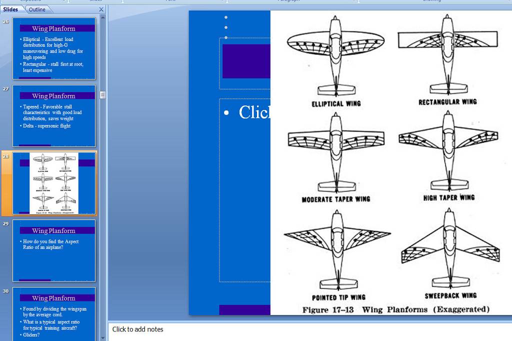

OK...thank you for taking the time to write that up.
So, not too oversimplify, but is it safe to assume then that the differences in stall sequence relating to rectangular, tapered and elliptical wings is in turn related to the differences that exist in the way each of those wings generate vortices (and other disturbances)?
It's because of many things. For example, since tapered wings experience lower Reynolds numbers as the chord decreases... etc.
But if you're looking for a generalization, it's because of the shape of the wing.

I don't think that elliptical wings stall at the TE of the root first, and the picture showing stall tendencies shows that.

ORIGINAL: victorzamora
Mechanical twist is LITERALLY twisting the wing to LITERALLY vary the angle of attack of the wing along the semispan.
I'm betting you'd rather say that "Mechanical twist actually twists the wing from root to tip to actually vary the angle of attack of the wing along that semispan."
Also, if you look closely at the elliptical wing and compare it to the rectangular one, you'll see that the rectangular one definitely shows the stall originating at the TE at the root of each halfspan. Compare the arrows that show how the stall migrates out from one specific location, the TE @ the root, to the similar function arrows showing the migration of the stall on the elliptical planform. That elliptical stall's arrows come from along a significantly wide span of the wing's TE. You are correct, elliptical wings do not stall at the root TE, however the picture doesn't show that happening.
No...but the book says that elliptical wings stall at the root TE.

You are welcome, Tom.
I have just added two schematics to Post #10 above for clarity.
I believe that the differences in stall sequence is a simple problem of area and pressure gradient above that area.
In other words, those differences relate to where the cross section (referred as strip in my previous post) that is creating the lowest pressure (on the top surface) is located along the wingspan.
As your book explains (I have one), if you consider each of those strips as a wing with no tip (there is backpressure in both ends or tips), then the area that contributes to lift is directly proportional to the chord (since each strip has the same width or “stripspan’).
From experimentation, we know that the lift force produced by the half-wing decreases exponentially from the root to the tip.
We also know that the lift force produced by each of those strips is proportional to the area of the strip and to the square of the speed at which the wing is moving in the air.
Since all the strips are moving thru the air at the same speed, there are only two things to change in order to obtain different lift from each strip: area and coefficient of lift.
The efficiency of the elliptical wing comes from the fact that it has the surface necessary to create the minimum lift, no one inch less or more.
In order to achieve that ideal, the coefficient of lift of each strip has to have the same value (minimum L/D point).
Then, is the area the only remaining thing to play with.
Because of that, moving from root to tip, the area of each strip is reduced in the same proportion in which the lift reduces itself naturally (due to the infiltrations of air from the bottom of the wing and around the wing tip).
This is achieved only by reducing the chord of each strip, because each of them keeps the original width.
By doing that, and then putting together all those strips, the resulting shape of the half-wing is half an ellipse.
According to the book and other references, an elliptical wing stalls over the whole span at the same time.
The detachment bubble moves from trailing edge to leading edge.
http://www.faatest.com/books/FLT/Cha...ngPlanform.htm
