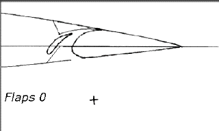

Hi everybody,
I'm doing a little science experiment in a few weeks, just for fun.
Many of us have done slotted flaps on our models, most easily built with a simple Robart hinge point, where the hinge hangs below the wing.
I wanted to experiment with double-slotted flaps, and eventually triple-slotted flaps, simply because I haven't seen anyone else do it.
So, if you're interested in following along, the article is at http://www.nextcraft.com/j46_highlift01.html
I'll be using the flap design in the attached image, and we'll see where it goes from there. This model will also use spoilers (slot-lip ailerons) for roll control, and have a T-tail... Why not?

Very good! Liked your high-lift page, and the reference to Andy Lennon.
Your "double-slotted" flaps are similar to those used on the deHavilland Otter and Buffalo. Martin Rousseau has some drawings of these flaps at his site:
http://www.mraerodesign.com/buffalo/BUFFALO.HTML
I have a Bruce Tharpe Flyin' King that I'm doing STOL work with. I have an extra wing that has fixed LE slots, slotted flaps, hoerner wingtips, and other low-speed enhancements. This is in-the-works, I have the wing basically framed up but not completed.
Eric Kler has an STOL page at his FUBAR site: http://www.fubarhill.com/ .
I'll be following your project with interest.

Thanks Bill,
I had seen the Martin Rousseau page when I first did some "Google" searching for flap info, but hadn't seen the Fubar page until now.
Why don't you (and anyone else who is interested in STOL) jump in here and add their photos and info? It would be nice to collect a lot of this information, and the results, on one thread, rather than spread out over several.

It _would_ be a good idea to take more photos to document the STOL wing construction. The outer wing panels do not have the fixed slots sheeted (just "framed up"), and this would be a one-time opportunity to show that construction.
I'd do the slots differently the next time-- these built-up slots are too labor-intensive and will be a nightmare to repair if there is ever a mishap. I'll use a different method on the next STOL plane (a scale Storch).

Seeking information about the "Bugatti R100" I found the detail of the original design of its very special flaps, patent by Bugatti in 1942. They were and are very original.
Down I enclosed an image of them.
Greetings, Angueto

Hi Angueto,
Thank you for posting the image.
For those of you interested in the Bugatti, here's an informative site, at http://home.uni-one.nl/bugatti/baa/
