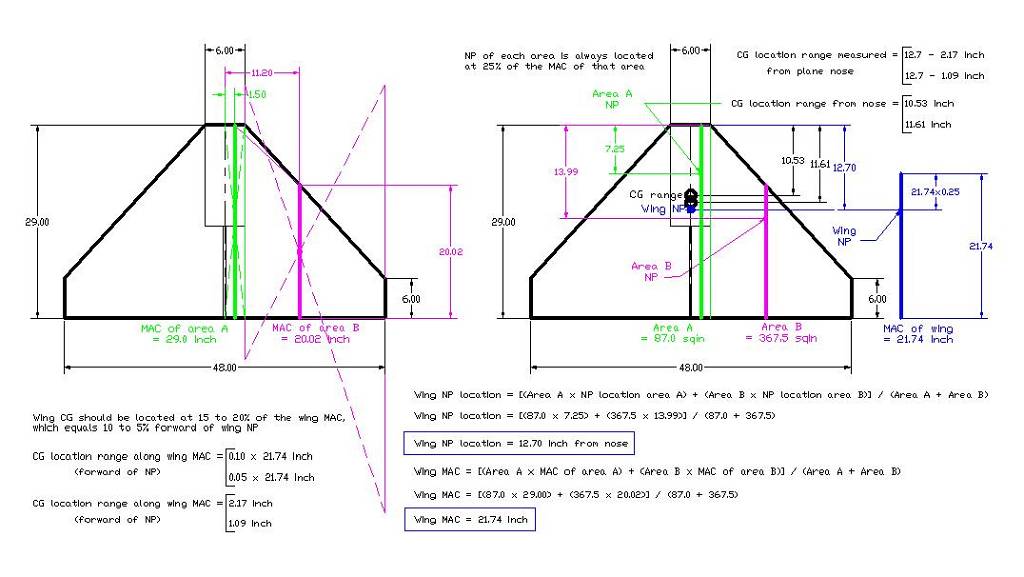

Will someone please help me find the CG and MAC for my delta, I tried doing it on my own, have looked at all the explanations on how to do it, but i am still have a lot of difficulty. The model sizes are as follows"
29' length
48' wingspan
6' tip chord
6' wide where the motor mounts
It would be extremely appreciated if someone to do the math for this. And if it is not too much trouble, show me the formula. Also, the trailing edge is straight, no sweep. Thanks soo much to anyone who helps.

There's online graphical input calculators in the Aerodynamic Resources and Online Tools sticky thread at the top of the thread titles page. You can easily input the numbers into one of those. Once you have your MAC length and location your CG should be located at between 18 and 20% of the MAC.
Also this ' means feet while this " means inches. Unless this is an actual man carrying model I suspect you used the wrong mark....

Shape A or shape B?

Shape B, Thanks!

skater_719,
Study the attached calculation and ask any question if the explanation isn't clear enough.
This will serve you for any future delta wing that you build.
Regards!
File Type: pdf
Old 07-17-2010 | 03:28 AM
Joined: Oct 2003
Posts: 518
From: Burlington, WI
Default RE: Finding CG
Wow, thank you so much, very appreciated. Did you draw that up, or is there a program to figure that stuff out?
Old 07-17-2010 | 06:09 AM
Lnewqban's Avatar
Joined: Apr 2007
Posts: 4,057
From: South Florida
You are very welcome, skater_719
Yes, I draw it using AutoCAD.
As you asked, I wanted to show you the process and formula, so you could use them for future projects.
It is not that difficult.
1) Divide the wing shape in simpler shapes.
2) Find the centroid of each shape, over which the MAC runs.
3) Divide each MAC length into four equal parts.
4) Select the 25% closer to the LE for each shape, that is the neutral point (NP) of each shape.
5) Calculate a mean location for the total wing NP from any reference point by computing individual NP locations and areas.
6) Calculate the total wing MAC length.
7) Select the 25% closer to the LE for that total wing MAC, that is the neutral point (NP) of your delta wing.
8) Balance it so the CG is located ahead of that NP.
9) Go flying!
The attached PDF can be read more clearly.
You can download it into your computer by right clicking on the icon / Save target as
Best luck with your project!

Just did download the spreadsheet and did verify that the numbers match.
Good calculator.
