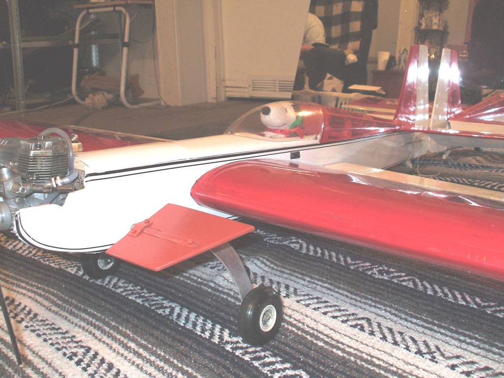

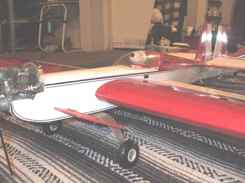

I had a plane that was damaged in a bad landing and when in the process of repair I had a weird idea. I had wacthed a video of a Russian jet tha had front canards and thrust vectoring that really impressed me. Thinking along those lines I started wondering if a canard type wing on a conventional propped plane would add some manuverability. The plane I am putting this on is a Sig Something Extra and have installed a small canard type wing right behind the prop and mixed it in with the elevator. The idea is to have a type of thrust vectoring on a front propped plane. The front wings or canards as I call them are slightly smaller than the prop. I am curious as to what effect they will have on the airflow over and under the wing. I am still in the process of the final covering it and still haven't decided as to the final size of the front wings yet. I have made them to be removable and to be swicthed from stationary to mixed at a % to the elevator. Just wondering if any-one has seen or tried this before.

Well, I finally got the fuse covered and the front canards in, linked and mixed. Almost ready to fly her. Still need to paint the engine compartment so dis-regard that in my pictures. Itook a couple of pics with up elevator and down and neutral. I have the radio set so I can let them move with the elevator or not, and I can move them independantly. The whole front set-up is also removable if I want pretty quickly. I did take some advise and moved the CG forward a little and went with my ole' faithful AX-55 for the power. Just a little nervous about the test flight as my spotter, co-pilot is in the hospital till at least Monday. I think it will wait till Wednesday, the weekly gathering of our group at my club. Plenty of advise available on Wednesdays, like it or not! Thanks again for all the help and in-sight. You all make it a little more fun and alot less confusing. I will let you know how it does. I think I will even tape it. Having some problems with the pictures. I will try on another post.

I think I got it now. Got to load them one at a time.
