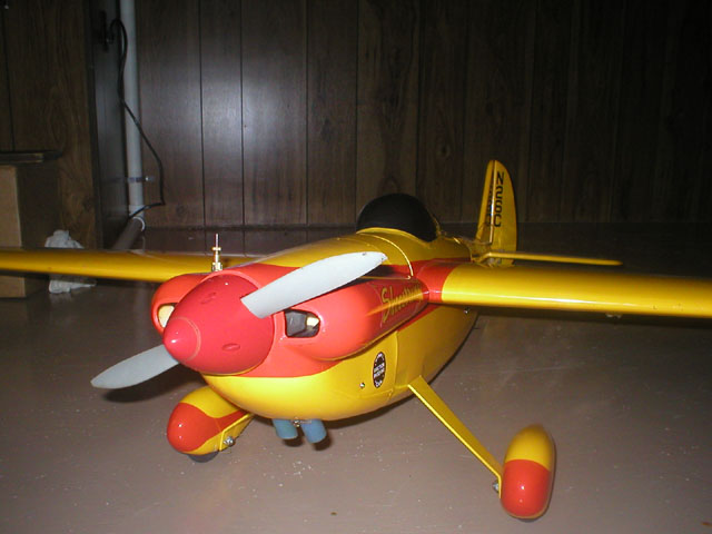

Mine Has a SuperTiger .61 in the nose....balance is perfect....never noses over....Smokes the Shoestrings with the Saito 100's in Them.....Just a overall Great flying plane....looks kool.......goes fast.....seem to do aerobatic with the rest of them....how could u ask for more?.......i give mine 2 thumbs up
