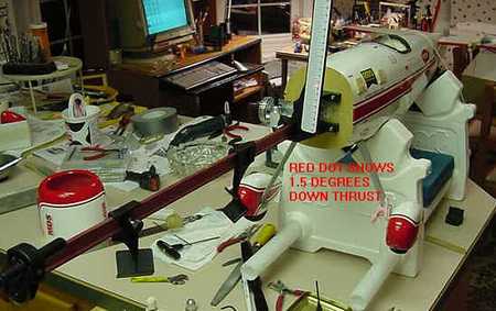

After checking Bob's web page and noticing his "how-To" on building an incidence meter I want to suggest the Great Planes Laser Incidence meter.
I originally built one similar to the one Bob described and used it for a couple of years with moderate success.
My only real complaint was having to level the plane on the bench to the datum line before setting all the incidences and thrust lines.
The first time I used the laser incidence meter was a revelation.
You don't need to actually level the plane. Just keep it at the attitude you start with while making the adjustments.
When I assembled a Kyosho Stearman Bipe I purchased a second GP laser incidence meter and this made accurate setup of the wings so easy I only wished I had these devices years ago.
To setup my Stearman I used rubber bands to strap the fuselage down to a Robart cradle that was in turn fastened to my bench.
Then I attached a meters to the stab which I had aligned to the Datum line at 0 degree incidence.
Simply "Zero" the meter while mounted on the stab. This becomes your Datum line. Whatever surface you then move it to "Zero" on the meter is o degrees incidence. . You can then adjust your wings to the needed incidence. I used one meter on each wing.
Another handy feature is you can bolt the laser meter to the engine's prop bolt to set your thrust correctly. Side thrust is set by turning the plane on it's side, "Zeroing" the meter on the rudder and then move it to the engine and again start from "zero" on the meter.
Hope this helps
