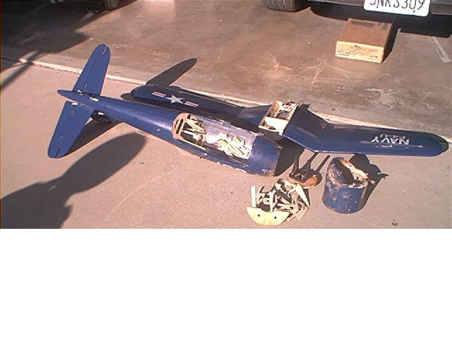

just to let you know. Check the wind mounting dowels and even reinforce them, the wing came off on mine when doing a roll. Its a great flying plane, the retracts arent to bad, the bellcrank is a little weak. just have fun with it, good luck and ohh yes i almost forgot, if the retracts break send them to airborne and they will send you newones.
