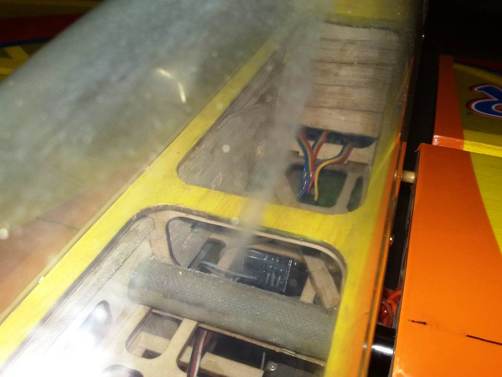

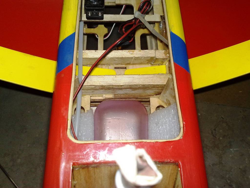

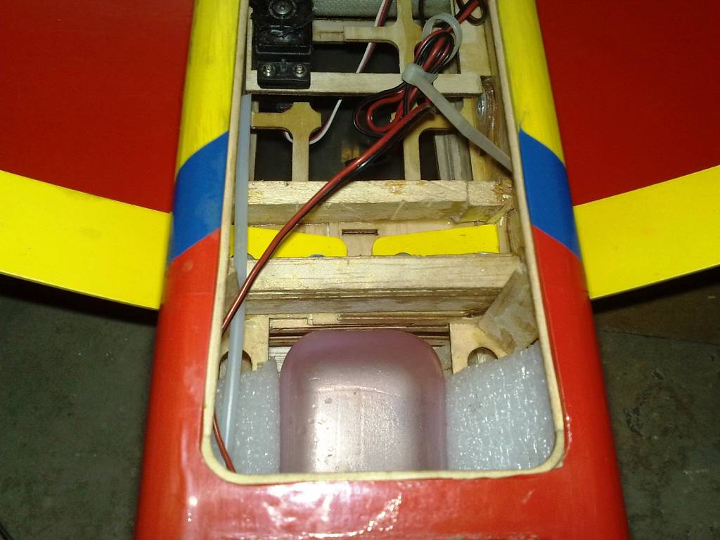

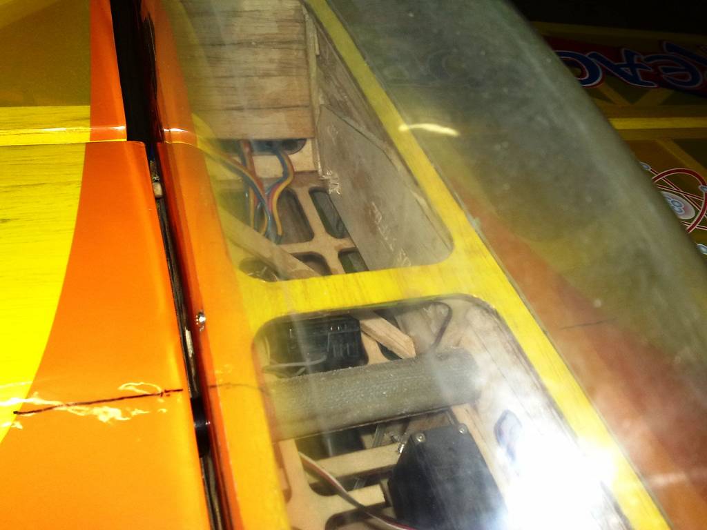

Well, I did weigh it. The scale I am using isint very accurate (it doesent have markings between 2 & 3 kgs) but the weight minus fuel and prop is 2.6-2.8 kgs which is 5.7-5.9 lb. So I guess it a bit heavier than stock.
I am posting pics of my repair (it has the effect of birch beams or I beams under the LG. Yes, I am a mechanical engineer). I am proceeding with taking off the engine though. Havent installed the wing bolts when taking this pic
