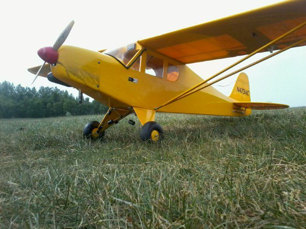

Yeah i have a worlds models cub, iv had nothing but issues all the way through assembly. i noticed there is not a sign of any glue in the fus of it. heres the link to my story and problems with the same company http://www.rcuniverse.com/forum/m_10350724/tm.htm

Well the cub i have has airlerons in each wing, looking into the wing i can see a big blob of glue about 10mm big in the very center of the sheeting and main spar. and same on the other side. i bet they are just tacked in place like spot welding but with glue instead. All i can say about the cub is after all the **** iv gone through geting it right and geting its aerodynamics right i hope it flys as good as it now looks. Its definatly geting stripped at the end of the flying season and a very thorough inspection of the airfraime and some seriouse strengthening to be done, thats if it sees end of the season. I dont think i will buy another arf after this latest experiance. Going to stick to building from kits, least we have control of what glues is used and how its applied and in what quantity.

as soon as i find my lead for my phone il be able to upload some of the photos of the construction. sadly when i came accross all the faults i lost intrest in taking photos of it and concentrated on fixing them., il find the lead out at some point later and get them uploaded.

well i found the lead and have since test flown the model. it flys very nice but second flgith was cut short due to cowl and cannopy failure. heard vibrations on second flight and strange noises so got it on the ground nice and easily to find canopy cracked and cowl disitigrating. cracks all over it. i new it was very soft plastick for a cowl but it certainly takes the biscuit. emailed world models about this now awaiting for a reply. il take some photos of the damged windscreen in a short while and get them posted. those photos where taken after 2 sucessfull maiden flights of my cub and friends thunder tiger. We both had issues with our engines that day too. as you can tell by the pil streak mine is caput. Just rebuilt it with asecond handcrankcase off fleabay. cost me 5gbp to fix the engine.
