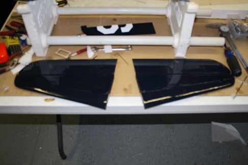

Ok guys. Glad to see a few people are looking into this thread. Here are some pics. The plane looks great out of the box and I have yet to find any defects. I will however be changing all the hardware as I am not fond of the ESM supplied hardware. I think I will also be able to scab the tailwheel fork assembly off of an old broken robart retractable tailwheel and make the tail wheel look more scale in appearance. It still will not retract but I think it will look better than the cheesy wire setup. Progress may be a little slow as temps here are well over 100 deg. and I won't hit the garage until 9:00 or so to beat the heat. Sorry for the focus on a couple of the pics. I thought the camera was on auto focus.
