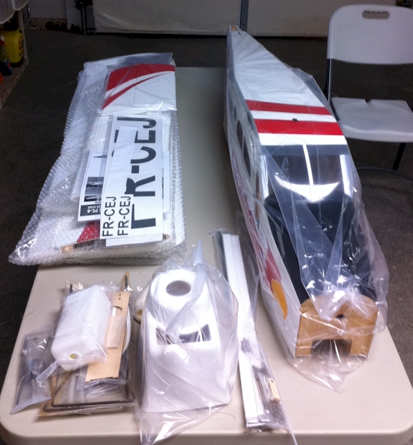

Recently completed build of a Pilatius PC6 Porter, the TopModel 150 scale. Can see pics and specs of it here.
http://www.espritmodel.com/index.asp...D&ProdID=13858
Contrary to their pics.. the plane does NOT include a spinner or fuel tank. It does include the hardware for a tow setup if thats what you're looking to do.

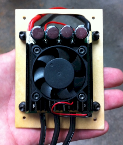

Hacker A60-14L
Hacker Opto-80 ESC
2 Turnigy Zippy 5C 4000 lipos
APC 22x12E prop
Using Fromeco 5200 li-ion to power the servos, passing through Fromeco Badger switch to Fromeco Sahara regulator.
The product is well packaged, includes a few bags of hardware but no main wheels. The covering is okay, had quite a few bubbles though. I did remove the 'eagle head' motif from the fuse and wing, prefer just the white with red accent stripes. Flying surfaces are corrugated and appear to be made from plastic. First interesting thing you'll note is the manual is in french, and its for the sport model, not the scale offering. No biggie. There are photos, but don't expect them to be a huge help. If you've built a few ARF's you shouldn't have any major problems figuring it out. I used the pics for occassional reference, throw numbers and CG. Beyond that the manual is basically useless.
I started with the wings. The wings/flying surfaces are drilled but not hinged so began by adding hinges to the wing. The include hinges are similar to Robart, an OD color with brass hinge and a bit smaller than Robarts' 3/16th product, which is what I ended up using. As have done in past, used Zpoxy 30 min. epoxy. Next day epoxied ailerons to the wings. Following day was checking them, and discovered I could put aile's from the wing without too much effort. Cleaned things up a bit, mixed some more epoxy, this time using some milled fiberglass, and got a more successful result. Then attached the flaps. Dropped in HT 635MG servos, (used these on all flying surfaces). Since its a bit of a run from aile servo to rx, the aile servo extension cables have a signal booster. Next added control horns, which are very similar to Sullivans steel horn, with the plastic bushing. The horns attach to flying surface via 4 wood screws, they do not mate to anything on the other side of the surface, but it is possible to screw them thru the other side if not careful. I have visions of them giving and pulling right out of the wood , but we'll see how it goes. Included linkage is a threaded rod with clevis on each end, with a spring and nut behind each clevis. Myself, using these I had some problems getting correct geometry. In the end I ditched the includes and went with Dubro 4-40 ball links.

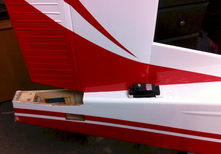

Next up is the tail feathers. Again started off by using Robart 3/16th hinges and hinging the stabs. Now it starts getting a bit tricky. There is a removeable plate on the bottom which exposes a servo mount for the rudder. There is an included metal bar, which has a 90 degree bend at the top, which is to be epoxied into a slot on the rudder. Then when the rudder is attached, the bar extends to the bottom of the fuse supplying a means of tail wheel steering. But... before you do any of that, included is a small plastic control arm molded around brass, which slips onto the metal rod and tightened with a set screw. This is to be the arm for the pull-pull for the rudder. You will not see any directions or pics for this in the manual. Long story short, its a soup sandwich trying to construct a viable 2" long pull-pull unit in a very confining space. Built it 'dry' 3 times and still no joy. Understand that once its built and installed, there is no getting back to it if something gives, those openings are now covered by rudder and horiz. stab. So... canned that notion, got out the dremel, located a space on the top next to the rudder and mounted the servo there. I absolutely recommend doing that for anyone looking to build this bird. I had to build it up a bit to get the geometry right, but well worth it and what I should have done to start with. Then dropped the 2 ele servos in. The rudder and ele servo extension cables also have signal boosters.
Next up tail wheel. The included unit has a metal tab with 3 holes in it. The tab fits into a slot on the very back of the fuse. You're left to make a guess on exactly where to drill those holes in the fuse, and can only work from the outside. The odds of me drilling a hole thru fuse, hitting one of 3 small holes on a tab, and then continuing out the other side of fuse, x2, is not likely to happen. Did it tho, only to find out that there was way too much slop and movement. Went tailwheel shopping, found a set I liked, cut some ply and reinforced that part of the fuse bottom and bolted it on. Ok, good to go there. Now to setup steering. Remember that rod I mentioned that comes down off the rudder? Well it exits the fuse bottom, and you're supposed to attach another plastic/brass control horn to it via set screw. Problem was that the set screw in the horn was a bit gimped and would not get a bite on the rod. After trial and error with fabricating other horns and attachment methods, gave it up and decided to let the wheel castor. I'll be coming back to the tailwheel later.... The horiz. stab is designed to be attached with 2 bolts. I'm not a fan of removeable tail feathers, so added some ply reinforcement and
fixed the stab permentantly. To attach the rudder, a plug is inserted into the bottom of it and then fit to fuse. Problem is, the plug is 8/32nd balsa, and the slot for the plug only had wood on one side to 'grab' on. Of course I did not realize this until I had epoxied the plug into the rudder, or I would have made one of sprue. It was basically impossible to do anything with the plug slot by virtue of the design, so pressed on with install using epoxy and fiberglass. Then same as wings, screwed on the control horns and attached 4-40 ball linkage.
