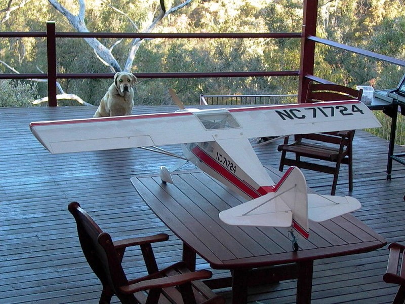

Old 08-25-2003 | 10:58 PM
apalsson's Avatar
Joined: Jun 2003
Posts: 2,306
From: Coffs Harbour NSW, AUSTRALIA
Default Some pictures
Some pictures attached
Old 08-25-2003 | 10:59 PM
apalsson's Avatar
Joined: Jun 2003
Posts: 2,306
Default 1/4 Taylorcraft
And another

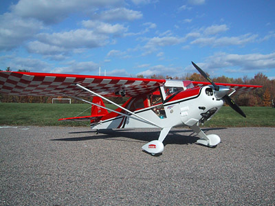

Old 08-27-2003 | 09:25 AM
My Feedback: (20)
Posts: 2,249
From: Clayton, NC
Default H9 Taylorcraft
I have a Taurus 2.6 gas enigne that will be installed along with JR 811 Digitals
The box measurement is 14"X17"X531/2"
The picture is not of my plane but a good looking Taylorcraft!!
Doug
Old 09-13-2003 | 03:21 AM
apalsson's Avatar
Joined: Jun 2003
Posts: 2,306
Default RE: H9 Taylorcraft
Here are a couple of more pictures of my Taylorcraft.
As you can see, there are subtle differences between this version and the Hangar 9 version. Look at the wing tips for different shape.
ID:	61022   Click image for larger version
ID:	61023   Click image for larger version
