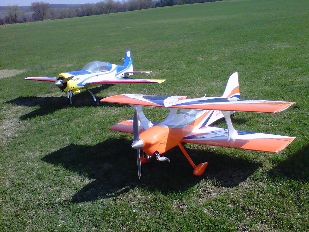

I have just got down to putting together a GP Reactor Bipe. I was quite dissapointed when I looked at the fuse structure. The thing is essentially a 2mm ply frame with holes that have been sheeted over with balsa. There is almost no tristock anywhere, no stiffning balsa, nothing! Everything is just interlocking ply, even the bulkheads are not reinforced in place. Even the LG block is just a ply former. Its likely to break soon on our rough field and I will need to reinforce before I do anything else.
Now, I am planning to convert the fuse side into a box structure by gluing balsa strips (1/4"x1/4") on the inside to form a truss like structure and then sheeting over with balsa ply for additional strength to form a box frame. Te balsa strips will be applied in the direction in which force runs in the fuse in case of a hard landing i.e. going from the TE on the LG towards the next bulkhead. Then I will use tristock on all bulk heads. Will add birch blocks with the LG block and tristock the inside to hold it in place. Will also fibreglass the firewall from both sides. I believe all this wont add too much weight, will be using a FS110A anyway.
My question is
1) Is this a good way to go about strengthening?
2) Should I use CF instead of the 1/4" x 1/4" balsa strip or will it just punch through in a hard landing? Also, there is a step between the balsa frame and sheeting which I will need to fillup on the inside with some ply to provide the balsa strip more bearing area. Should I just add the ply under the balsa strip or fill up the entire bay with ply?
3) Anything else you suggest?

I have over 150 flights on my bipe with a DLE-20 in it and haven't had any problems with airframe. This plane is flown hard with giant rates and it is still intact. I did do some glass work on the firewall but thats it.

If you are flying from a paved runway, that is the reason. Our rocky bumpy field will cause more damage sooner. I am thinling atleast re-ply the inside of the fuse, then tristock wherever I can reach and fibreglass the firewall
By the way, what servos did you use?

I have had 3 relatively minor incidents with mine: 1st was battery coming loose/loss of esc power. Plane glided in on its own onto the gear, but tore gear off. Rebuilt the landing gear plate with the pieces and added tristock.
Second was hovering and hitting LVC on esc; dropped from about 8' onto lower left wingtip, breaking wing and tearing out gear plate/lower wing dowel plate. Repaired again, adding more tristock and some 1/4" square stock alongside the 2 landing gear fuse bulkhead formers. I would think if you add some tristock to the bottom/sides of the gear plate area, you will be fine.
Just dorked it on a wingtip again, doing a low torque roll in the wind. Wind pushed me more than expected, and I hit on the lower left wingtip again. Broke my (new) lower wing again.
Both times, the wing broke right at the middle wing strut mounts. Think I can fix the wing this time...
None of this abuse caused any real damage to the fuse or firewall, and I'm running 1700+W on a fairly large outrunner. Don't think you'll need to do much else to the fuse except beef up the LG area, though 'glassing the firewall wouldn't hurt.

Thats a given- the LG Block needs beefing up. I mad the same mistake on my previous (two) Reactor 46s where I didnt reinforce the LG block and it broke off many times. In that airplane the LG 'block' is inside the fuse, so it does a lot of damage when it rotates. Someone on the Reactor 46 thread suggested two things to prevent this- adding CF stock inside the LG block and replacing the LG
The Bipe shares a few of the 46's problems- firstly the LG block is just a ply former. Secondly, the LG is two piece. In a hard landing, the LG flexes outward and the ply simply breaks in the middle. Also, the LG tends to rotate, crushing the fuse components near its trailing edge. So, I am planning to add in the CF stock across the fuse to take the bending moment and then put in some (furniture) ply in the LG block and secure it in place with tristock to take the compressive stress and shock. Problem is the tristock has nothing to glue against as there will be a gap between it and the fuse side due to the balsa frame. So at the minimal, I will need to fill up that bay
Second thing that happens in a less than perfect landing- if you hit the wingtip, the fuse will break at the dowel and behind the wing TE. To avoid both, I will tristock and fibreglass these areas
Firewall needs to be fibreglassed to take the larger engine / possibility of a DLE20 later.
I will need to relocate the blind nuts, so am ordering 4mm blind nuts so that I have something standard to work with instead of 5/64 screws everywhere (you can only use allen keys for those)
I will be using larger 3" rubber (or foam, depending on the total weight) wheels and am getting CF landing gear from HK that is one piece.
Plus I will put tristock everywhere in the fuse I can reach
Doubt this will add too much weight. I am still to study the fuse properly, not enough time after work[
