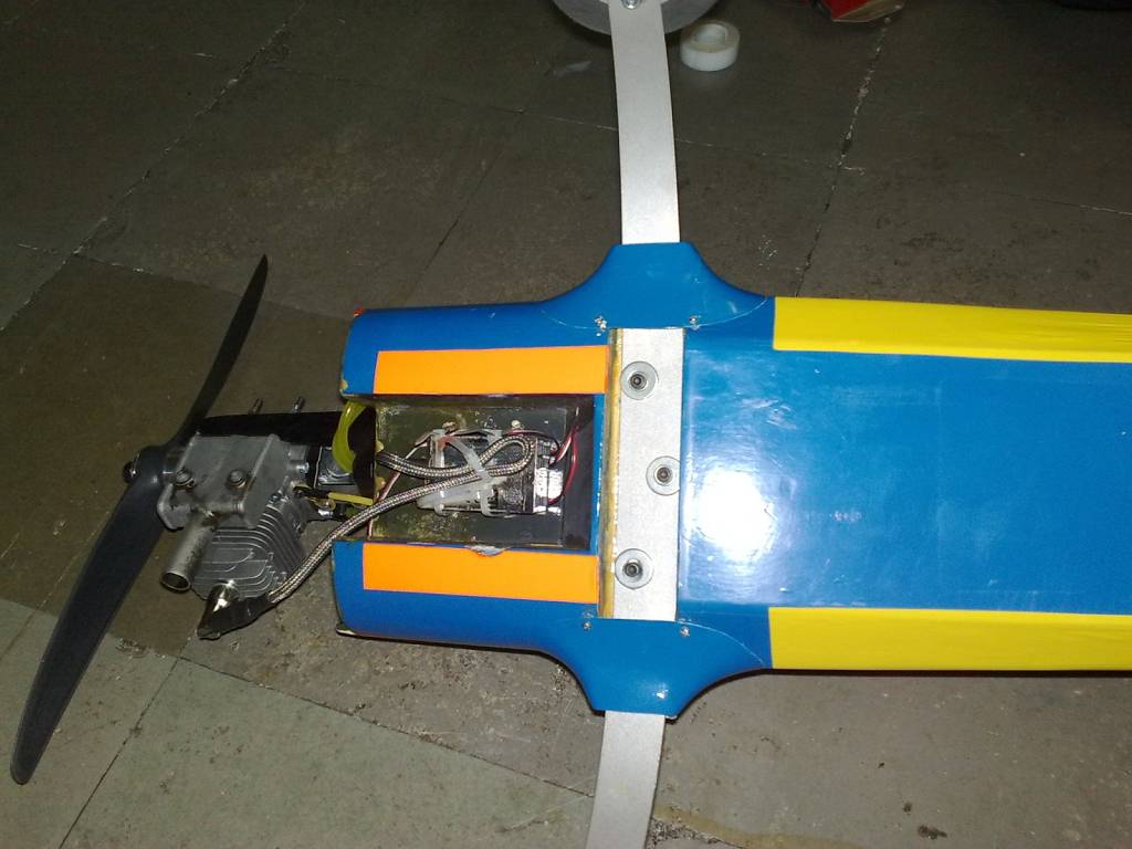

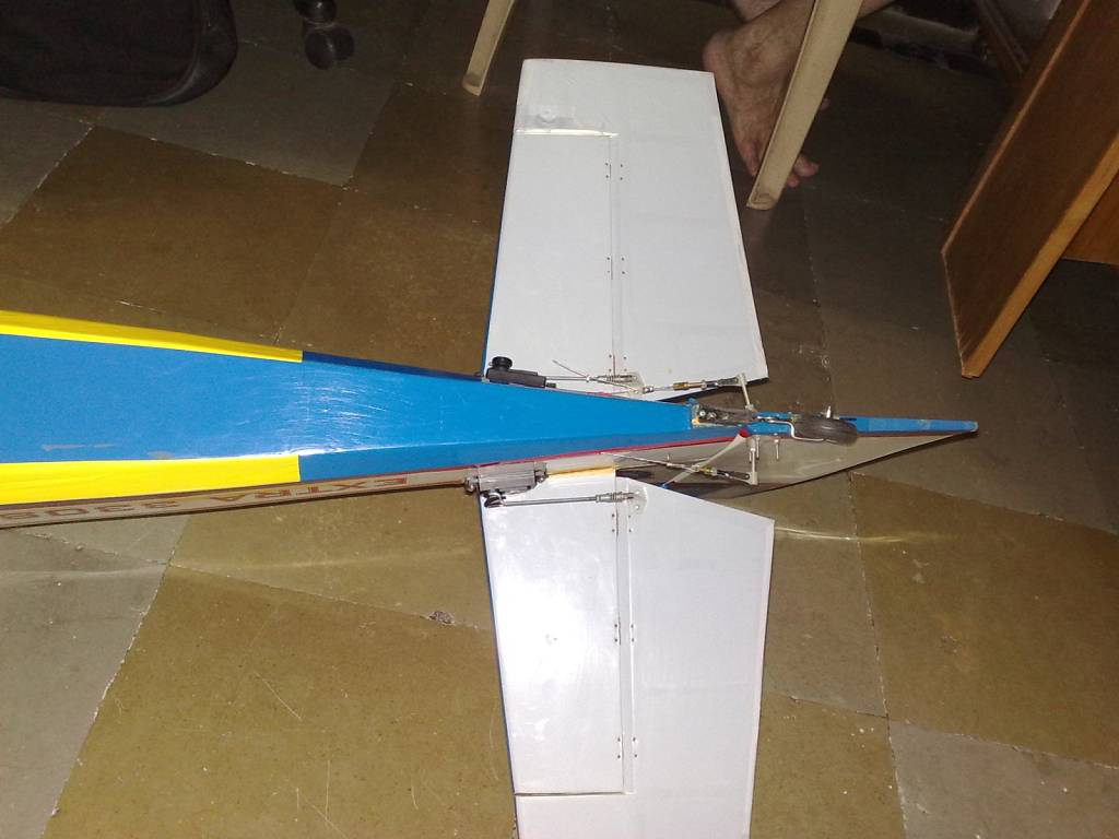

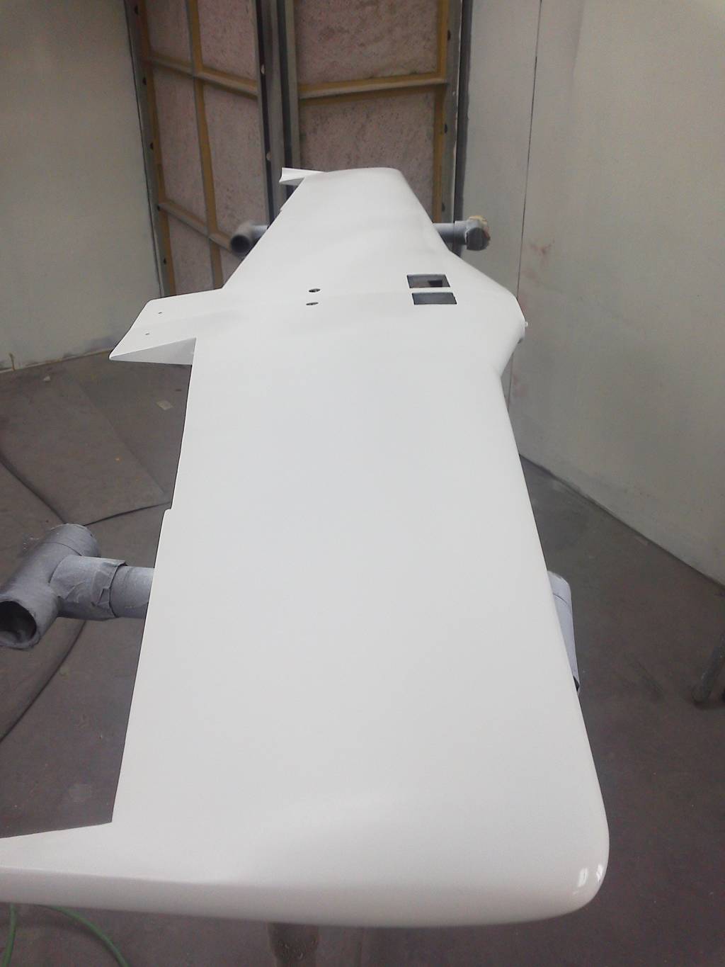

Old 11-30-2011 | 10:01 AM
Joined: Sep 2008
Posts: 2,224
From: Mumbai, INDIA
Default RE: Adding winglets to ARF wingtips
ORIGINAL: speedracerntrixie
Like I stated before, flying without the cowl messes things up, put it back on. Post some pictures and I will find at least a dozen things to do to reduce weight.
Here you go. Lets have those suggestions. One thing I cant do- move the rudder servo back. There is no way or ply to install it there. Also, I am not going for mini size servos either
Ameyam

Old 11-30-2011 | 10:06 AM
Jetdesign's Avatar
My Feedback: (8)
Joined: May 2008
Posts: 7,056
From: Honolulu, HI
The Winglets will work in theory. As stated above, they serve the purpose of keeping the low pressure above the wing and prevent some of the high pressure air from spilling up over the side of the wing. The spilling high pressure air reduces overall lift. As such, adding winglets and thus increasing lift should help prevent stalls of a plane with an increased wing loading.
