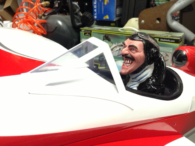

Pilotwise I was first looking at the slimline pilot from my stearman but he is just a tick too tall. I then checked Petes Pilots and had to get myself another cedric. He is perfect
Rev

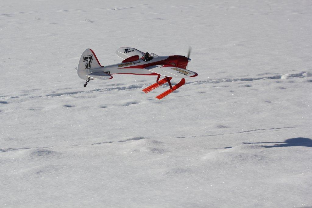

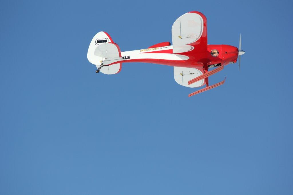

Maidened today. -10°C but crystal clear. Used half the throws from the manual (40mm+/- seems a LOT!) and the CG at 82mm. Flew brilliantly from the first second. Thought I would definitely not do more than three flights in the cold, ended up with 56 minutes flying time and about 30+ touch and go's
Can only recommend this little plane.

It looks like a natural on the skis! Sweet.

Love the skis.!!  I agree with you.  This plane is one of my best pleasurable fliers.  It's my "go-to" plane when I just want to relax and have fun.  I noticed you mod'd the tail gear.  Where is it from?  I used Sullivan tail geat for mine.

Muffler Setup working very well and I am glad I only have minimum cutouts in the cowl.
I really dont like those tail gear setups where the gear is directly glued to the rudder and the servo feels every "hit" directly.
I used this: [link=http://shop.lindinger.at/product_info.php?products_id=64909]click me softly[/link]
