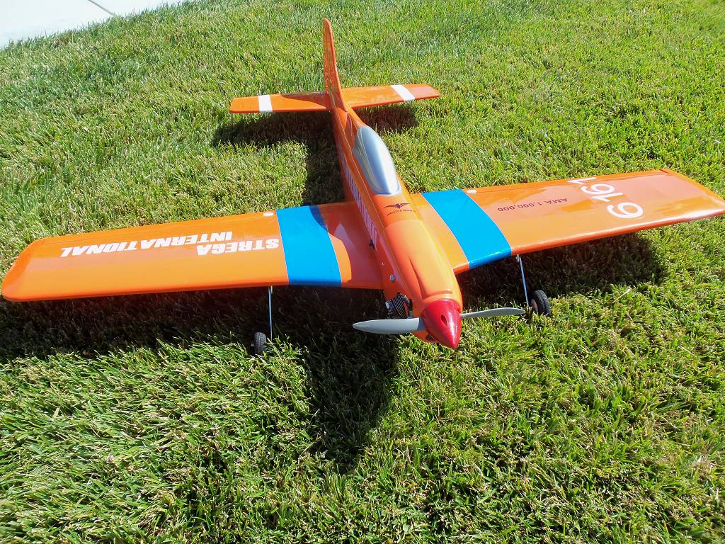

Heres pics of my Strega to sway your vote.
Was going to post the other night but RCU was having one of thier dead moments.

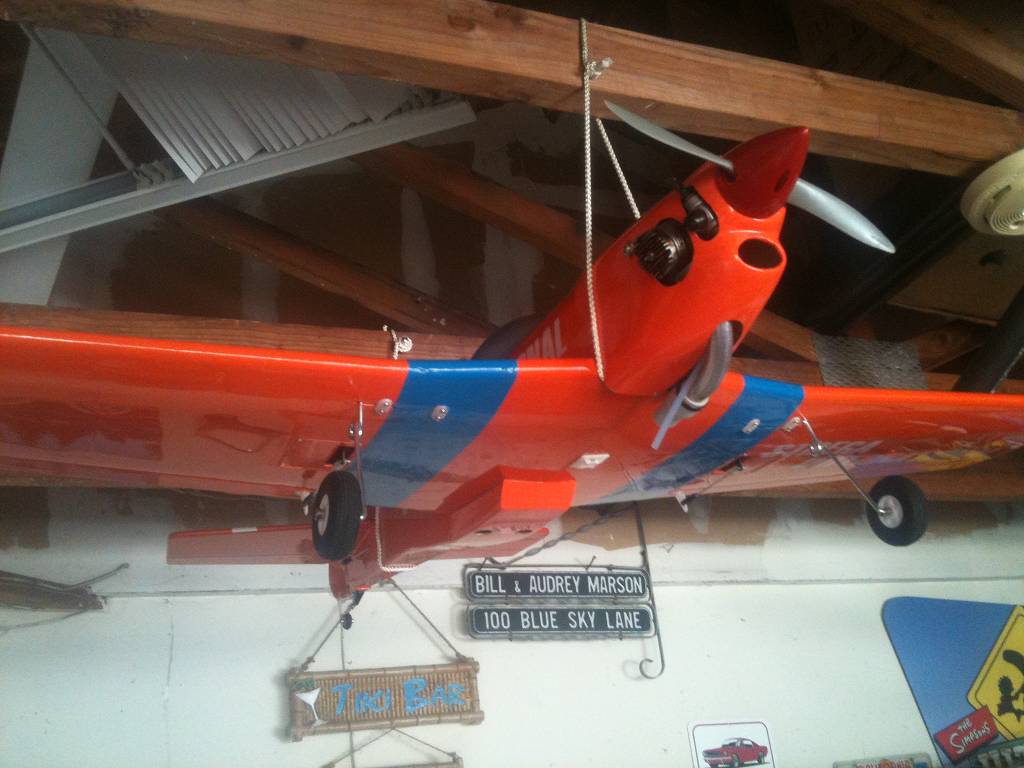

The blue strips cover where I opened the wind to add reinforcement to the landing blocks.
Its not that it needed them as it was still brand new and un flown but just wanted to beef them up a little like all ARF's need

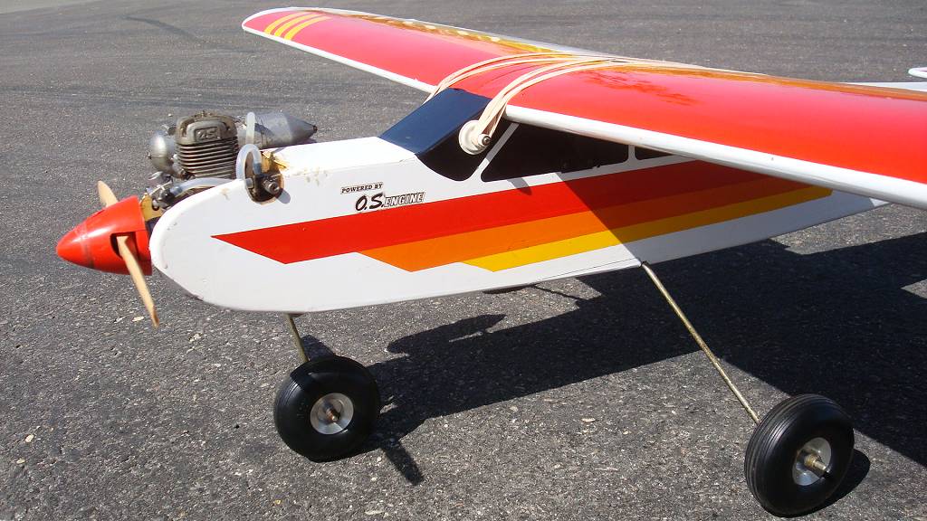

Default RE: My Dad's next plane?
Agreed.
The individual gear legs into the wing can be a weak area for less than ideal landing or less than ideal conditions like grass or rough dirt.
The plate style is much stronger than the individual into the the wings.
The best for rough landings is the individuals that both come back to the fuselage and are wide but at a low angle. They are much more suited to being able to act like a shock.
My old Avistar 40 had this type of LG.
