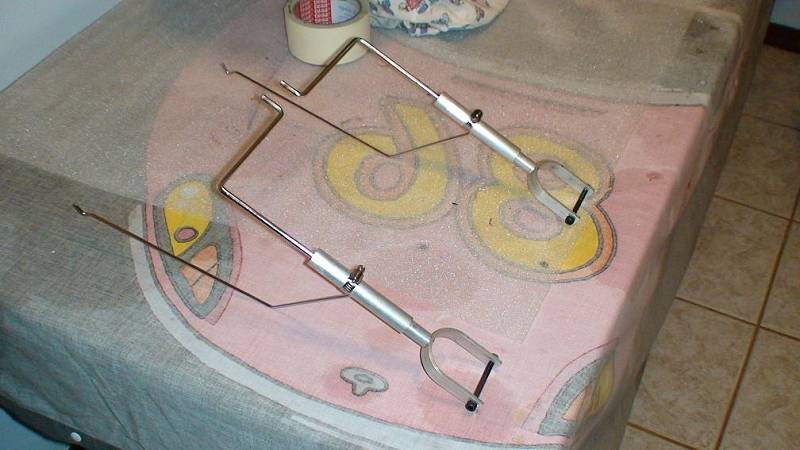

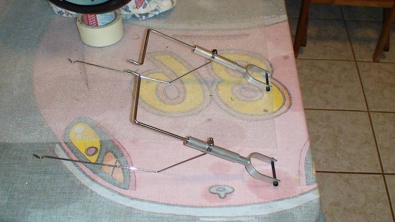

Thank you all for the advice.
I think I'll change the landing gear, I might appear, there are the Robart landing gear!
What do you think?
Marco
What do you think?
Marco

Heres how I did my landing gear on my Seagull GeeBee Z, seems to work well the rear brace wire stops most of the flex to the rear and the dampened strut stops most of the bounce.
