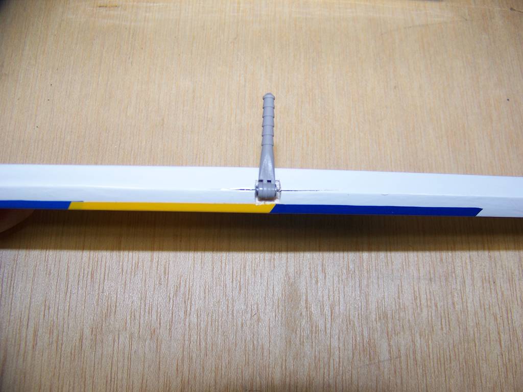

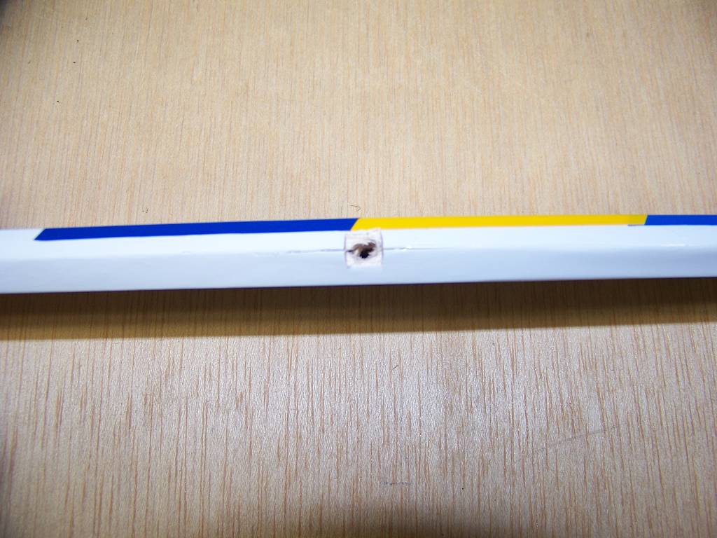

I got started tonite with the ailerons. I wanted to replace the fibre hinges with Robart hinge points. I laid out the locations on the first aileron then moved on to the wing panel. Thats when I realized the trailing edge was not thick enough to support the hinge points, they were only 1/4" thick.
I didn't like the fibre hinges so I upgraded them to Great Planes fibre hinges, they were nearly twice the thickness of the supplied hinges.
Here are some photos of the Robart hinge point instalation if anybody is interested in how to do it.
Two things you must remember. The hinge pin must be in line with the leading edge of the aileron, and the hinge point must be at 90 deg. to the aileron.
When you glue them in put alittle vaseline on the pivot point to keep the epoxy from sticking to it. Also, use 30 min. epoxy to give yourself time to work. Work some epoxy into the hole thenremember to "butter" the hinge before you insert it into the hole.
Needless to say, I did the work for nothing anyway.

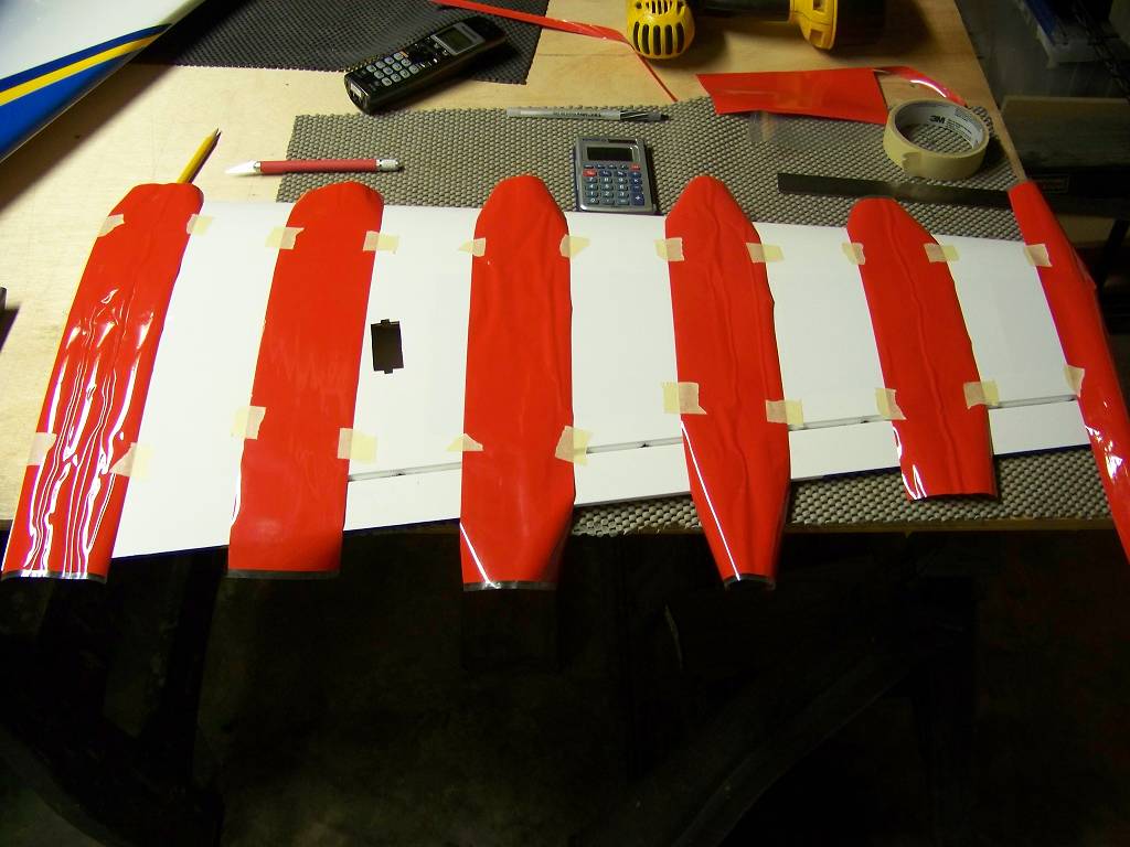

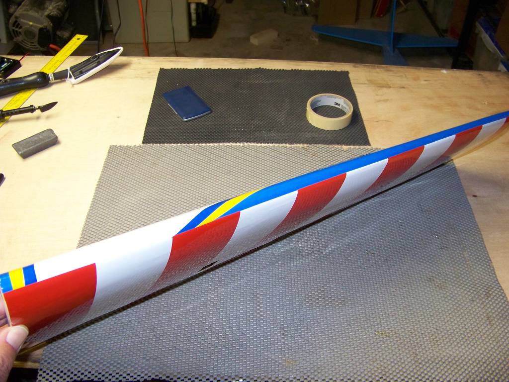

I did get the red stripes laid out and put on the wing and the stab. I also got the servos installed in the wing panels.
Flying time tomorrow so no more work until tomorrow nite.

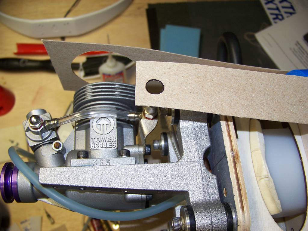

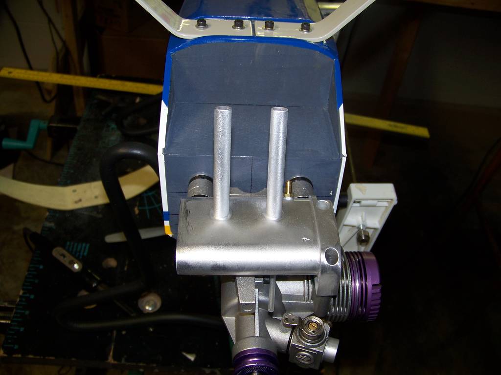

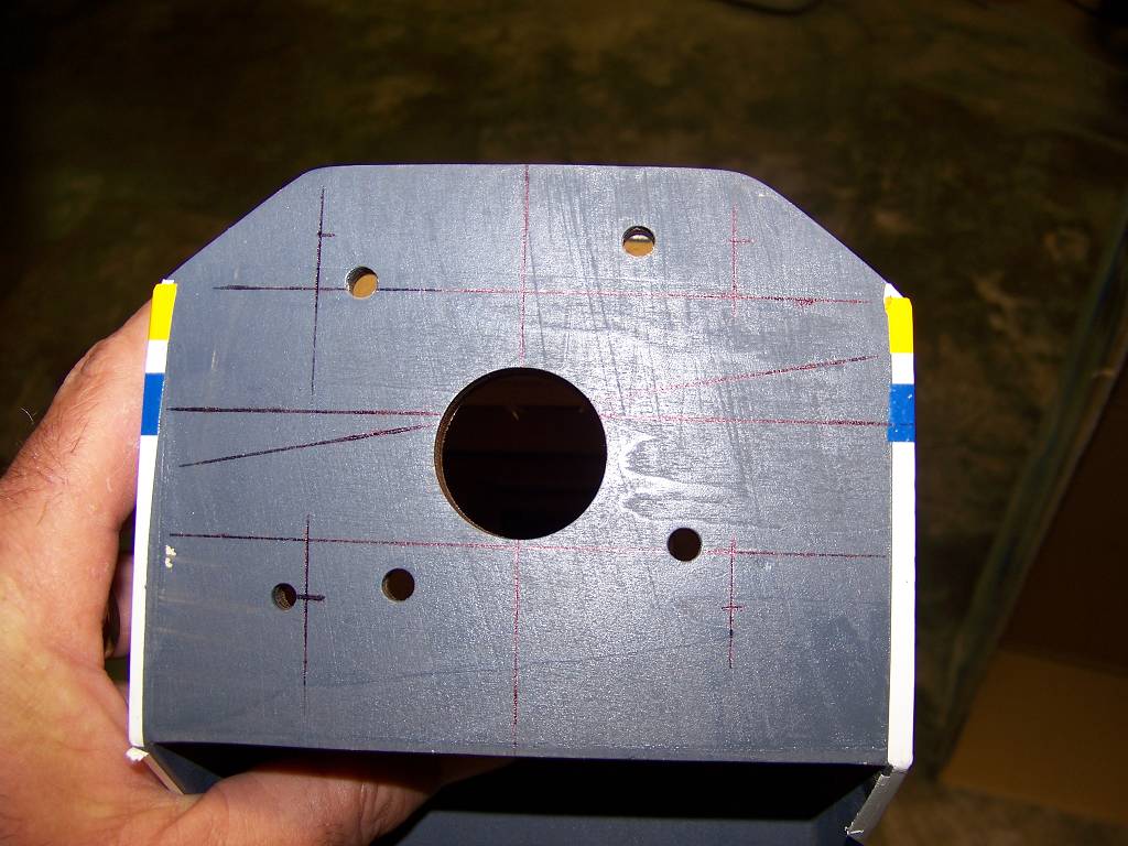

Last nite I worked on the engine mount. I want to mount the engine at 90 deg. and use a different engine mount. I have a dubro mount, drilledfor a Saito 1.00 that Iwill use. I will need to re-drill it but since it's a long4 stroke mount I can use two of the holes and drill two more. I will also have to grind alittle of the muffler brace to clear the mount.
I also put the decals on the rudder.

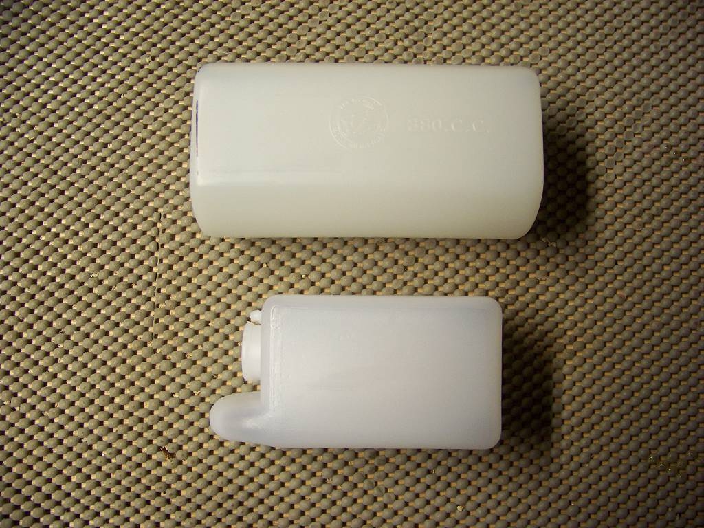

I got back to work today doing the fuel tank installation. I replaced the230cc (7.77oz)tank with a 380cc(12.84oz). That required modefying the structure to accept the larger tank. I would have liked to move the tank back a little closer to the CG but due to the location of the forwardwing bolts that was not possible. I suppose Icould have used a header tank setup.
I then moved on to installing the servos. All of the cutouts had to be enlarged to fit the Futaba servos and the servo tray was 1/8" too low.

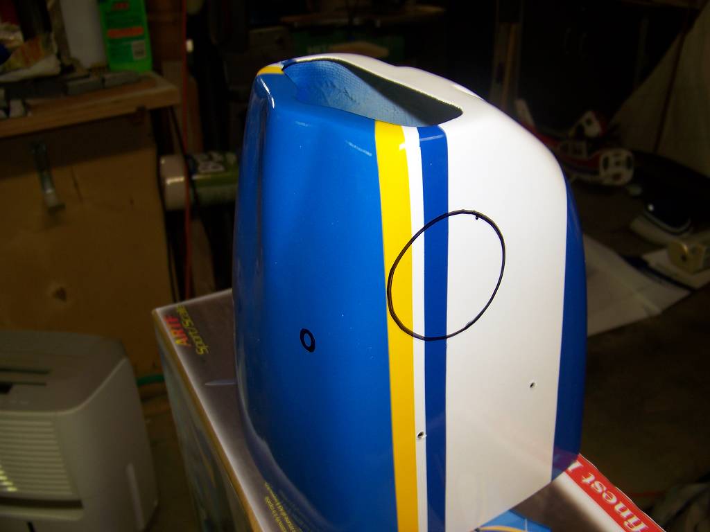

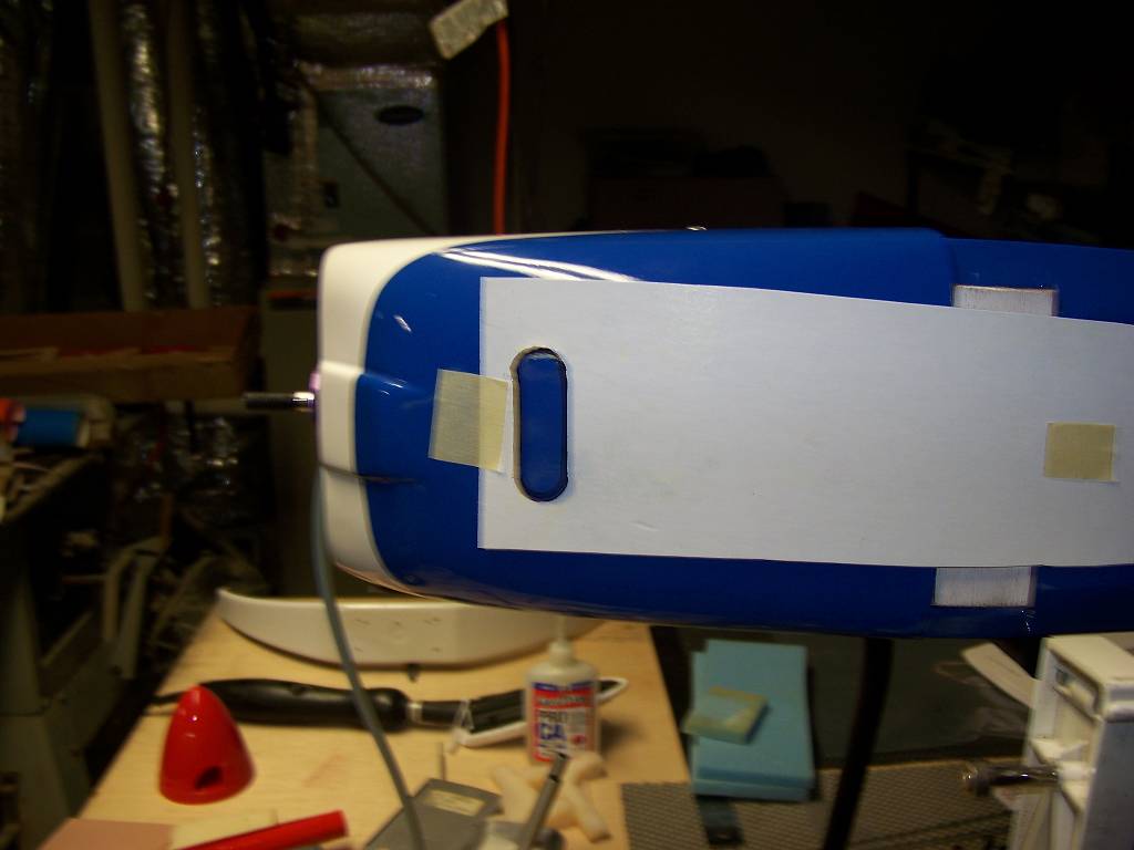

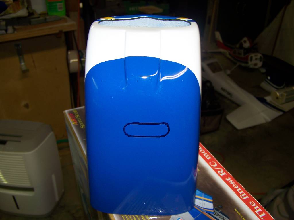

I've been unable to post to RCU for a couple of days now due to a problem with my AVG 2012 program. Had to turn it off to make posts. In that time I've finished the assembly of the Extra 300.
Laying out the cutouts and doing the cutouts on the cowl were straight forward and came out looking good. The cowl has a slight upward tilt because I didn't want to add another hole to the top to clear the carb.

did you made any changes on the elevator servo's? fi by replacing it with 1 servo and a closed loop?
I recently bought the same airplane and I found it pretty strange to use 2 servo's for elevator, they could have opted for 1 servo in the middle with fi a long control horn.
Oh yes I did the same, I replaced the tiny fueltank (felt like a 150 ml tank..) with a Dubro 12Oz/350 ml tank, that should be enough for 8/10 mins flying. Used the dremel indeed to largen the 2 frames which holds the fueltank
I was able to purchase a OS Max fs115a for a very good (dutch) price, so that will be my powerhouse. might be very overkill, we'll see...

The Extra is dead, long live the Extra.
Cause of crash was determined to be an elevator half that pulled out at the hinge during a hard and fast split S. I really liked this plane so a new one will be on order soon. This time I'll use robart hinge points.
I had already pulled the cowl and engine out of the ground before I took the pictures but before it was buried about 10" deep. It was a spectacular crash, one of my best.

No, the damage was too extensive. I've already got a new one ordered. I figured out that the elevator hinges were not glued properly. The hinge material will not wick the ca very well, maybe 4 mm of the hinge had glue on it. I'm surprized it lasted as long as it did. I'll use Great Planes CA hinges or Robart hinge points this time with epoxy.
All is well though, it gives me a chance to avoid any mistakes I made on the first one. The engine and all radio gear survived without any damage. The ground where it impacted was very soft, maybe a foot or two from the edge of a pond.

Robart also makes 1/8" hinge points if the 1/4" are too big. You should also give Gorilla glue a true. It is a great time saver over the epoxy, plus it expands as it dries. I little practice and you can glue e both ends of the hinge point in at one time. It's suprising how little of the GG it takes.
