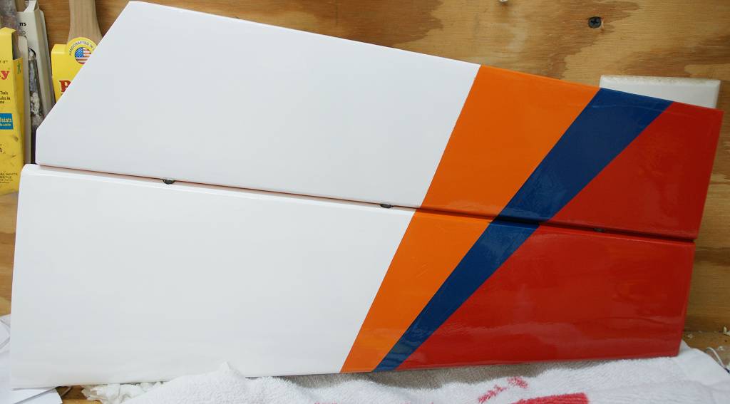

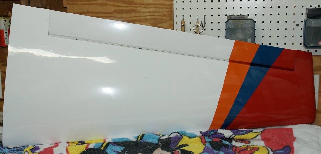

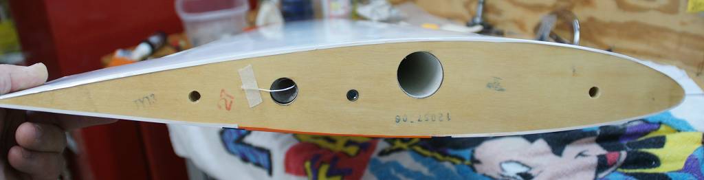

Guys - sorry about my misspelling; chief; people call me edwin newman because i obsess over misspellings [&o]
I fully unpacked the R90 tonight; i have not started the build, so i did not start a build thread, but i thought i would post some pics and observations.

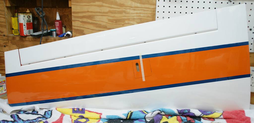

The wings should have good visibility, top from bottom.
Airfoil is semisymmetrical like the R90, and appear to be foam core.
Ailerons are attached with 5 hinge points. For that much surface, had i been hinging, I would have used 7 (two at each end, and three across the rest of the surface), but i don't feel strongly enough about it to rehinge them.
Hstab and elevators look similar to the wings.
There is no balance tab for the elevators.
The elevator servos mount to plywood aft. There is enough plywood that if one wants to make the elevator servos vertically symmetrical, it could be done. I have not checked for horizontal clearance (do the servos meet in the middle), so it might not be possible.
Rudder will hinge into the vstab with 5 large points; probably ok.
There is a ~1/2" tube extending from the radio deck to the tail feathers into which one can run the elevator servo cables; nice touch, perhaps some weight.
There are two small tubes through which the pull-pull cables run for the rudder; again a nice touch.

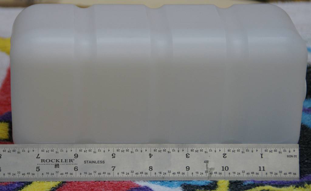

The gas tank is huge - probably 32oz, or maybe 1 liter. Has to be good for 15+ min of run time.

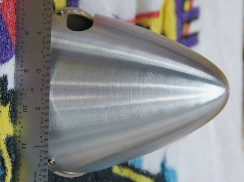

Spinner is large also - 5" diameter, looks a bit like a P51 spinner.

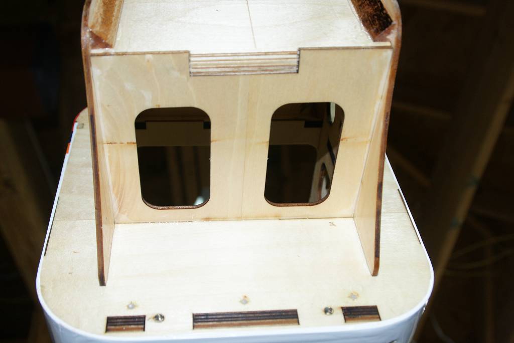

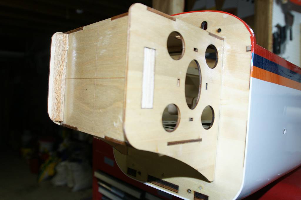

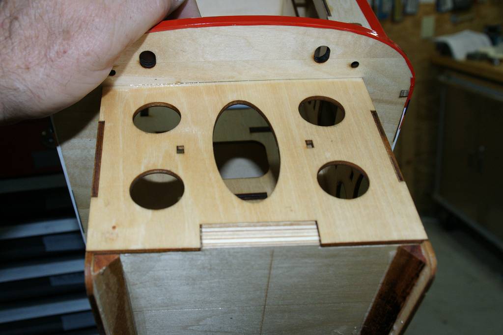

Firewall is heavy (~1/2" thick) laminated stock, keyed into holes in the sides of the engine box; very secure. Upper and lower surfaces are keyed but no into a box; that joint probably will get some fiberglass reinforcing from me.

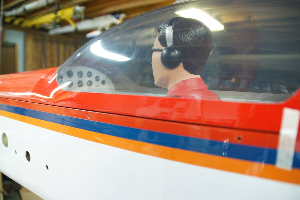

The cockpit has an instrument panel.

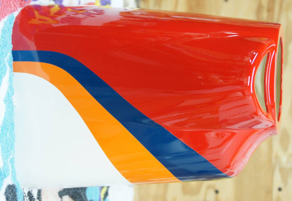

As i said before, i think the plane presents far better in person than it appears in the website photos.

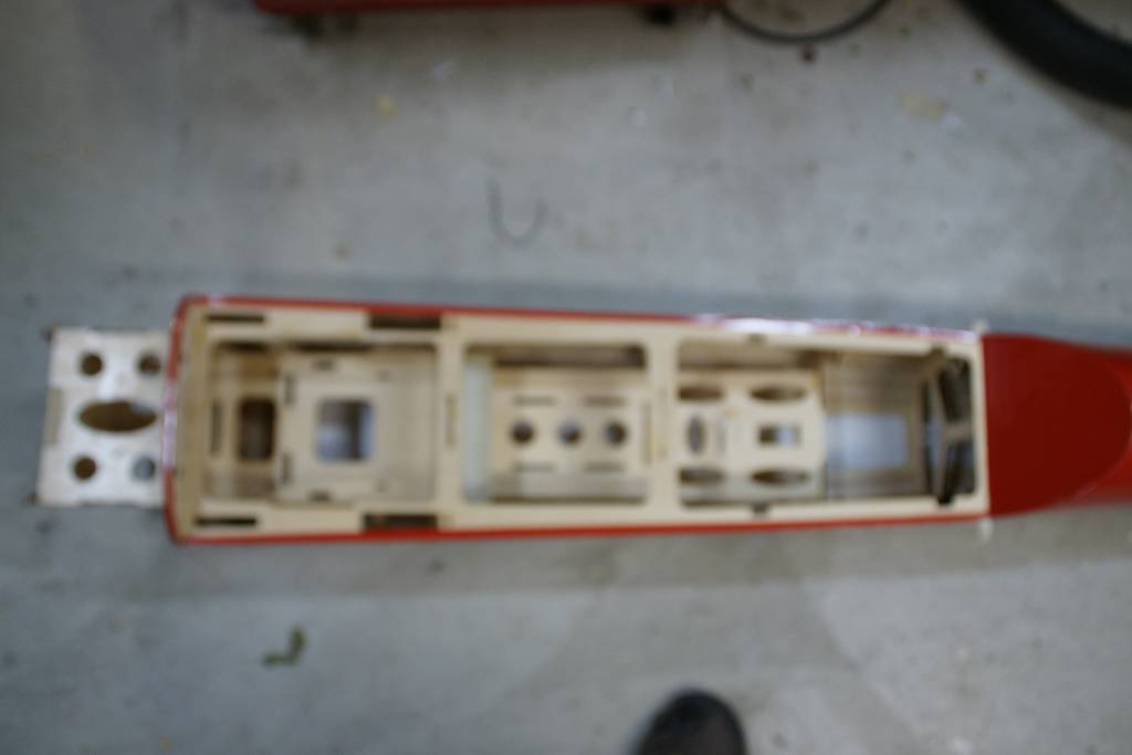

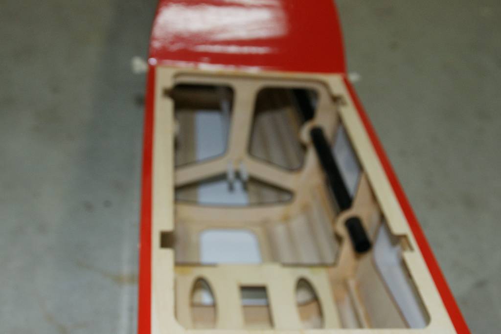

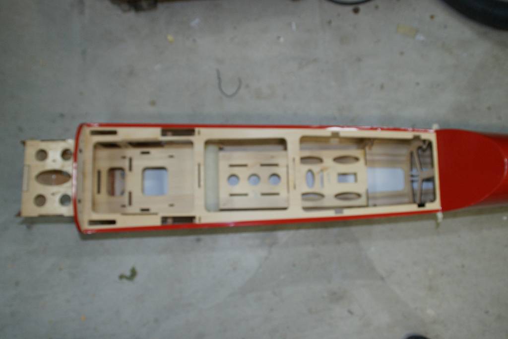

The electronics deck and fuel deck are pretty open, but made of good plywood with lightening holes; plenty of places for attachments, etc

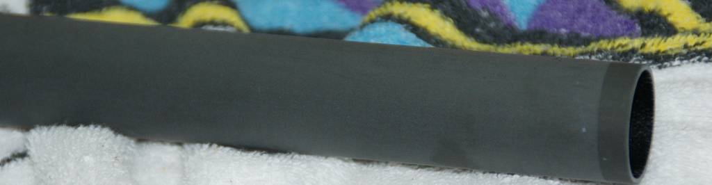

Spar tubes are carbon fiber.

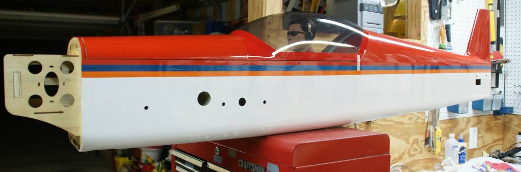

The plane is big - perceptibly bigger than many 50cc aerobats - which may account for some of the weight. The aft of this plane has a lot of plywood, so there is servo mounting flexibilty, but again, some weight. I did not probe around the tail gear mounting area, which was soft balsa on the R70.

wjc - thanks for the pics - looks cool (like that instrument panel, too). That firewall looks pretty thick - is it 1/2 inch?

Hi Mike
I think the f/w is about 1/2"; did not measure it, but thats about right.

Yes thanks for the pics from myself included. Oh, and I loved the customary "toe" shot too.

Forgot to mention the carbon fiber tubes
I just saw that the pic of the fuel and electronics decks is blurred - the toe shot.
I'll have to try to get a better pic, in focus. But you get the idea, i think.

Firewall looks very nice. Only a few light mods there needed at all. Now I am drooling....yet, I do want a flight report from folks we know as soon as one is available. Spending another 600+ in a plane right now when I have plenty of planes to fly...tough call

wj;
Thanks for the pictures. They are a big help!!! I see a few areas I would beef up but that just me. Can not wait to get my R90 and start the build. She will not fly untill next year. Old man winter is on its way, so this will give me something to do. If you go with the DLE 55RA, please let us know if you have to do any mod on the engine box!! Thanks!!!
