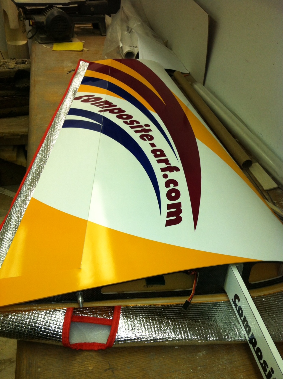

Picked this up tonight, has a new DA 100(I think based on the DA50 cylinder heads), and a few other items inside not familar with which look like digital servo programmers in the wings for the two aileron servos in each wing. Ithnk its a 3 meter span, but havent measured it yet.

CARF Extra 260, 3m ? Although I was sure that was based around a 150cc engine

Doing a lot of searching, and none of the models listed on Composite site match up with this particular plane. The closest seems to be the 300SX.  This might be the 300S since it has the flat spar.<div>
</div><div>
<em style="font-family: Arial, sans-serif; font-size: 13px; ">Everything started with the classic 3m sized Extra 300 S design, scaled down to 2.6m to make it more affordable to a larger number of aerobatic enthusiasts without loosing much flight performance compared to the 40%. We put a lot of new input into that design, like the flat wingspar instead of a tube and changing it to the large canopy of the „300 L“ to improve the knife-edge a little bit. That totally made sense in times, where only the 100cc twins were a reasonable choice for that size of airplane.[/i]
</div><div>
</div><div>I just cant seem to find anything on a 300S </div>

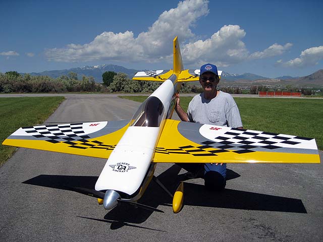

Well I'm not an expert on the older Comp-Arfs but that flat spar deal on the 2.6 size birds created a real stink for Comp-Arf when people found out there was a "competition" version of the 300 in the fantasy scheme using a wing tube and it was about 4lbs. lighter than the rest.....
Then everything got changed to wing tubes instead of spars and they lost a lot of weight.
It's not a 260 for sure because I have one of those and it's got a wing tube and other changes you don't see on this model, basically it was the last addition to the 2.6 size models until the Edge 540 was released.
This is a Comp-Arf 2.6 size Extra 260:

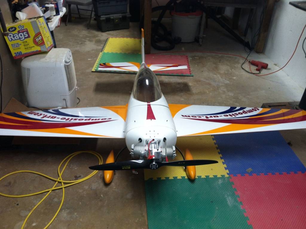

Nah, I just talked to him, he has some more stuff for me, like the transmitter and some other items. He's a really nice guy who I have helped with some networking stuff and programming. I brought the parts in and stuck it all together. It a big sucker, should have NO problems keeping it in sight! LOL

It's an older Comp ARF Extra 300S 2.6M. The cowl should still be available. I don't think they changed the fuse much on the newer ones other then to make them a wing tube. They tended to come out around 28 lbs. Still flew really well and is a better IMAC type airplane then 3D. The wing blade is very strong. The only real issue is that you need to keep an eye on the fit between the fuse and the wing blade. Once some play develops the blade can bang back and forth and fracture right where it exits the fuse. To tighten up you can edge seal the hole in the fuse with thick CA and then carefully file back open until you get a nice snug fit. It's a really nice airplane but you need to fly it to the ground and don't let it get too slow.

Well he found the manual and rest of the parts. Its a 330L 2.6M. I found the section on the stabs, and it all makes sense now. Thanks.
