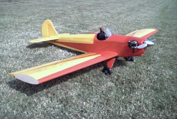

I've flown the 1/4 scale G.P. Spacewalker for the last 3 yrs with an Y/S 91 A/C. I turn a 16- 6 APC prop aprox. 8400rpm. I also use 15% Cool Power. This gives the plane a lot of authority in the air. We have members in my club that use Saitos, Thundertigers and OS 91's that really don't compare. Also with my Y/S , I was able to put my battery pack on the CG and I added NOOOO lead to this plane to get it to balance. I love this plane....It's my every day flyer.........Mike

Just finished the rebuild of my Spacewalker. I was disappointed in the performance my Saito91 gave it with a 14x6 APC prop. This plane should do all the basic maneuvers with grace and mine could not even loop! I put a Saito 120 with a 15X8 APC prop and was VERY satisfied with the plane. Also changed the wing incidence to +0.5 down from the +3 as it seemed that with the larger engine the plane wanted to always climb with anything mor than 1/4 th. Pete

Nice pics, and using the Saito 1.20..... Wow, would I like to hear that phutta, phutta, by and watch the plane fly.
