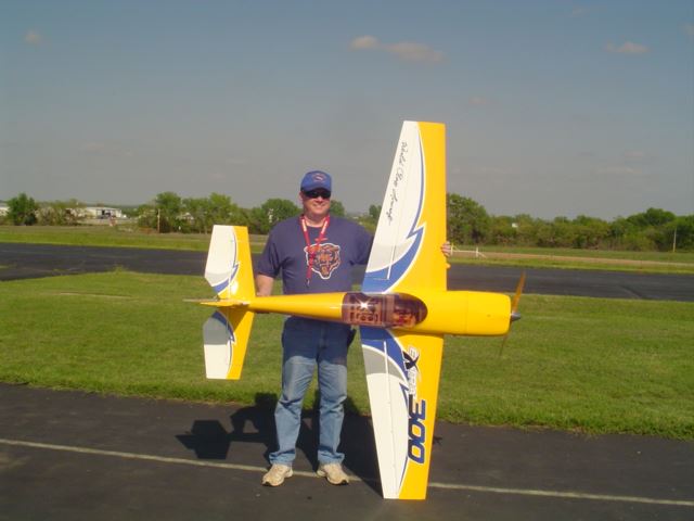

Good to hear. I think you will really enjoy the airframe. This is not the best picture but I decaled mine just like the one on AW site.

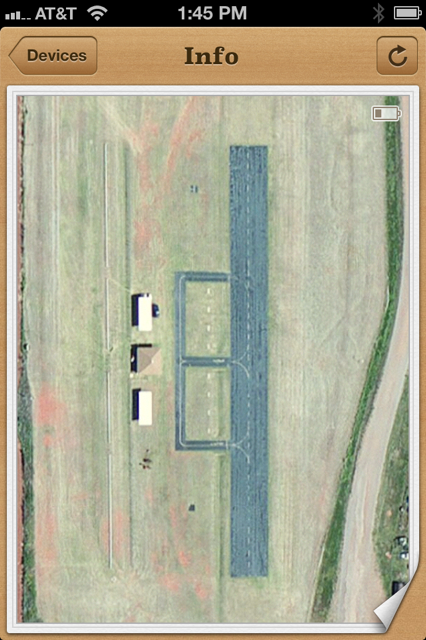

Looks good! I'm going to order their graphics also, I may add some to it not sure yet. Are those 2 runways at your field?

I am standing on a 12'x200' ramp area. In the background is the 43'x500' runway. We have three 12'x100' ramps that connect the whole thing. It's all out of petromatt. we have a nice place for the size of club we have. This is a google pic from my phone but you get the idea..

Very nice!
