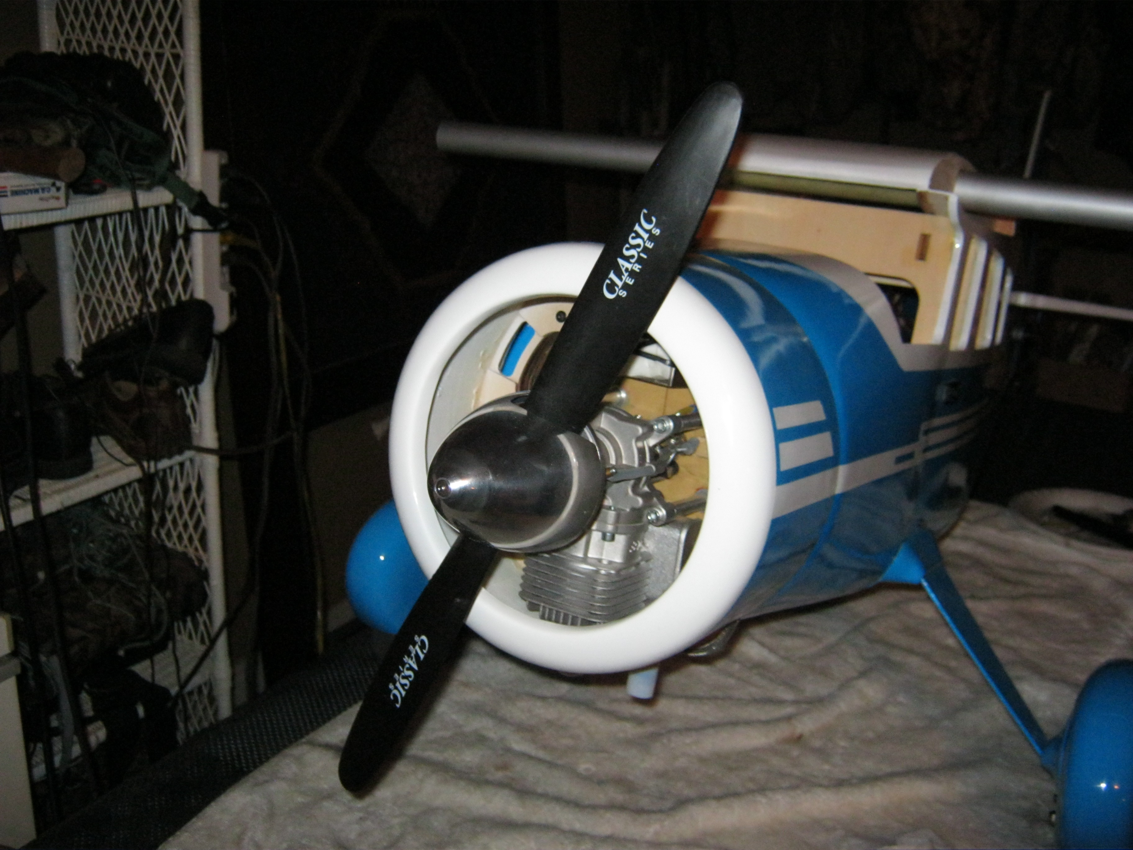

3rd night went well. I mounted the engine without any issues. Kangke has taken the guesswork out of mounting by etching the front firewall with center. The DLE 35 rear carb did not present any issues. the firewall flange had to be trimmed to accomodate the muffler; howerver, the cut was straight......front to rear on both sides about 3/4 inch deep into the fuse cowl flange. The tail wires work fine; however, the wires should be split with a turnbuckle in the center to draw tightness. The Howard comes with 2/56 tail wires and look great black. The only problem is tightening. You have to pull a little bit to have the clevis reach the attachment bracket. This could be resolved with a turnbucke which pulls from both ends. The wing strut hardware and attachment process worked great. The hardware is adequate but you have to pay close attention to the orientation of the hardware so it does not contact your covering.

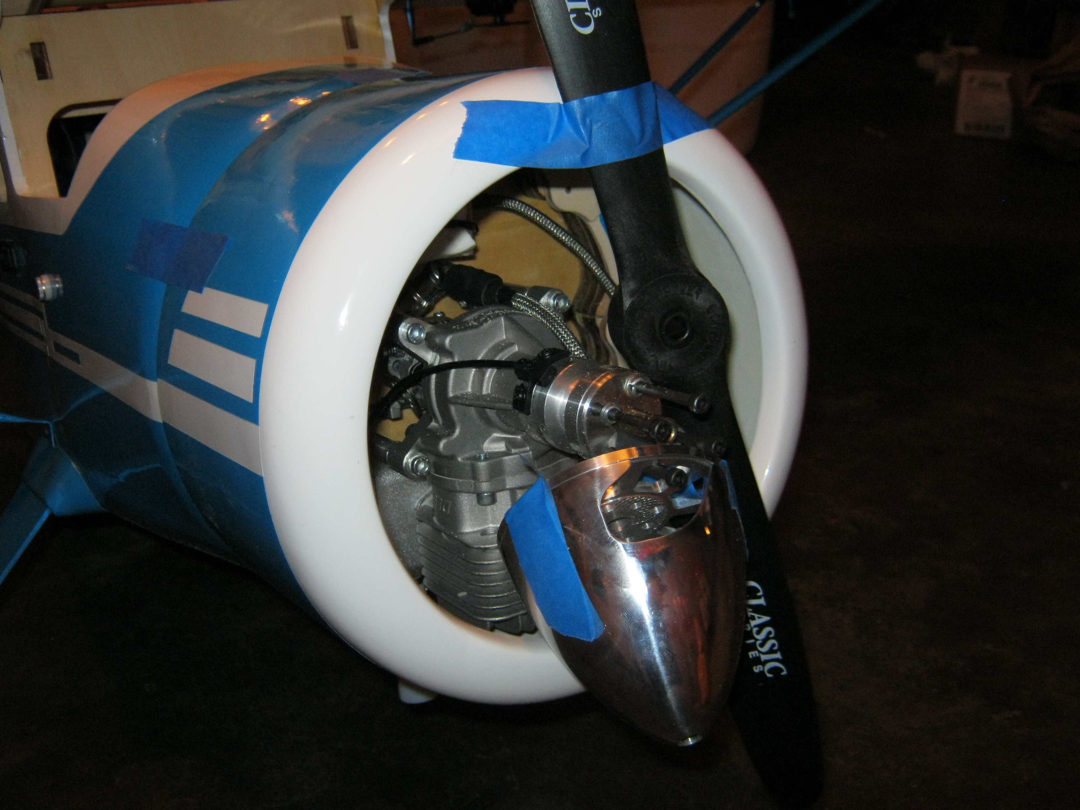

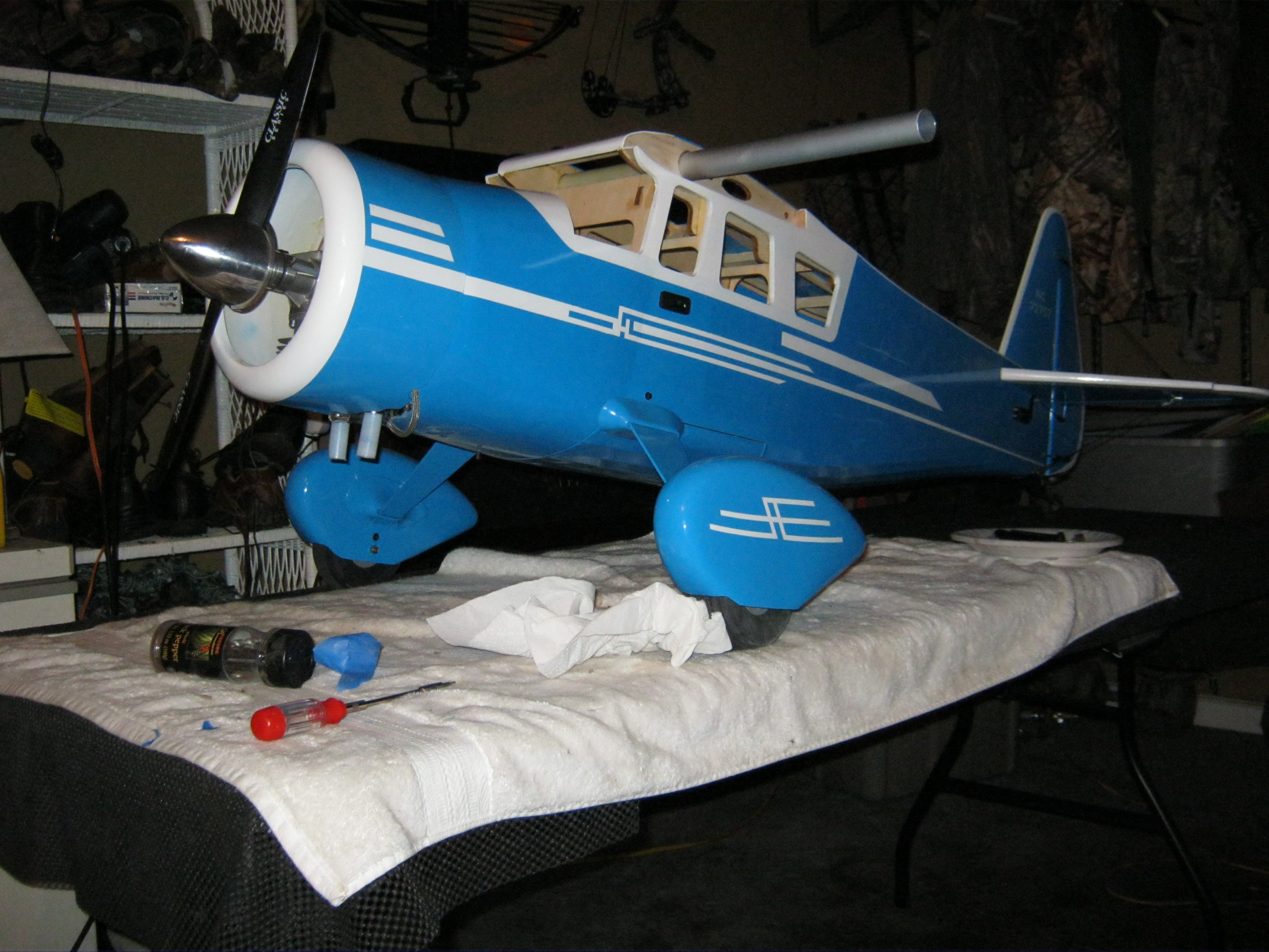

Im at about day 7 off and on. The plane is finished minus a few odds and ends. Yesterday everything was set to begin placement of the batteries and electronics. The landing gear was finished with 5'' tires. The wheel pants are nice and mount very easy; however the decorative flange pieces at the top of the gear and at the wheel pant are tricky. I used goop to adhere the top decorative flange due to the possibility of having to enter the bottom removeable belly tray.
I cg'ed the plane at this point before placing any moveable parts in the plane. The cg according to kangke is 4.05 back from leading edge. Before placing the wings on the plane I marked my cg point with masking tape. This is much easier to do one wing at a time on the table rather than turning the plane upside down. The plane was "level" so i pushed two batteries forward. As far as the electronics Im working with a 6 channel radio and a 7 channel receiver. The plane has 5 working ports on the receiver and the battery takes #6 so I only had one empty receiver port. I chose to use this empty port for a remote kill switch. Rxel makes a kill switch that is easy to use and has an inclusive LED light to mount which gives you instant feedback on the status. Hopefully I will start the engine tonight or tomorrow and see if any issues arise.
The cg last night was not for flight. It was only to determine an awareness of my battery placement. Prior to cg I placed/taped each part in its position. The prop, nuts, and spinner were hanging off and a lil tape can help hold items temporarily. Remember each part has "weight" so a build cg should include all possible parts to give you a good understanding of build cg.

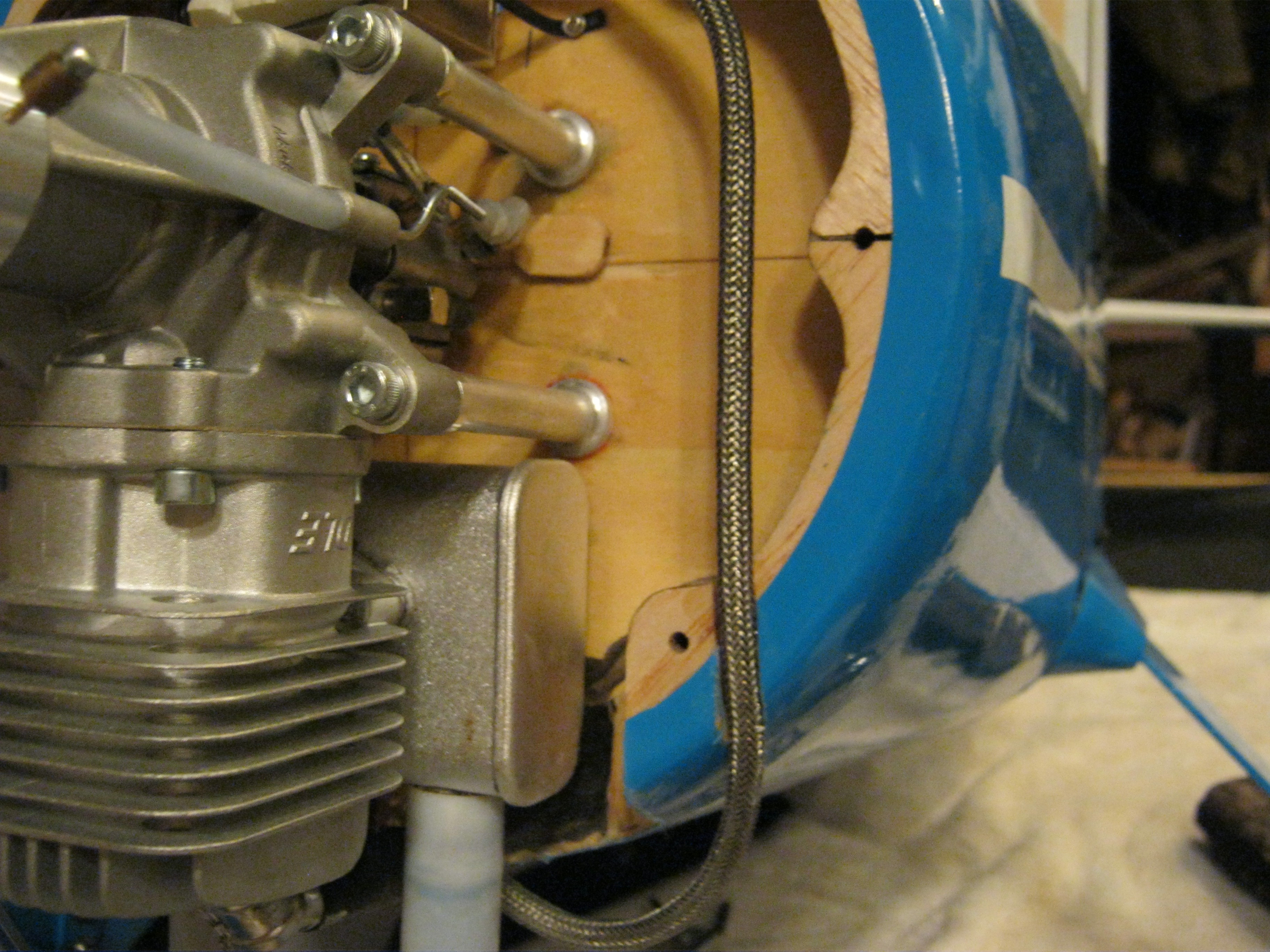

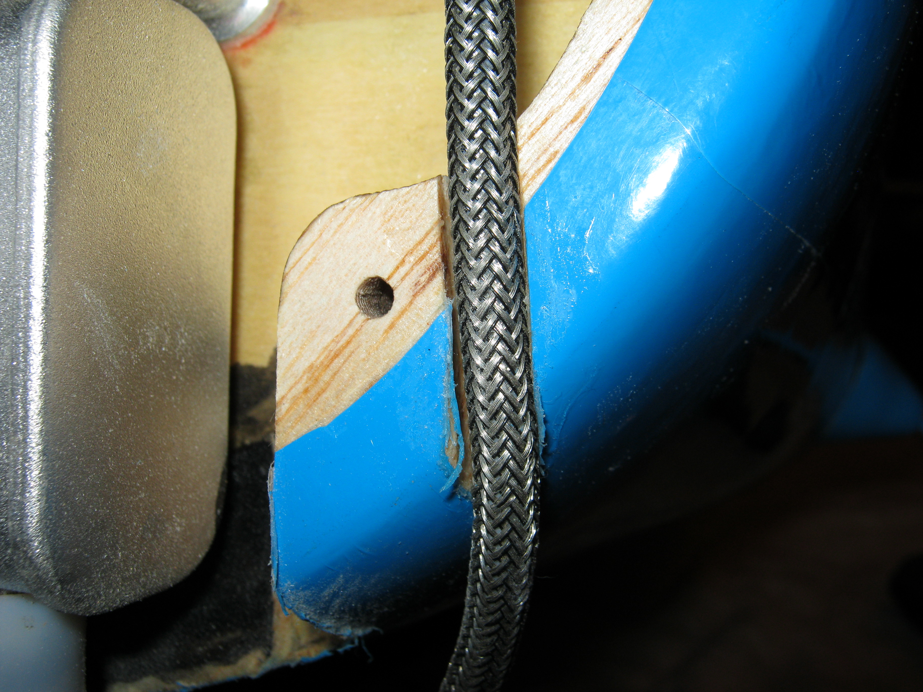

Its Thursday and the built is for the most part finished. I have 3 windows and the windscreen to finish tonight. Yesterday afternoon was an experience firing up my first gas engine. I had a neighbor hold the tail section. With eyes and ears in place I pulled the choke and gave the spinner a turn with my starter. The pressure was more than Im use to. After a couple of tries I had the prop spinning but no pop from the carb. I decided to disengage the choke. Next attempt and she fired right up. Subsequent to the initial run I did not find any loose bolts or gas.
The spark plug wire was tricky with respect to the routing. I decided to open a channel or grove the depth of the spark plug wire diameter. The groove was etched to the right of the engine and does not conflict with the seating of the cowl. In the cabin picture you will see to voltwatch battery indicators. I like these and they work well for me. I run each one on a y harness off of the "out side" of the receiver. This way they do no stay on when the plane is not used.
Looking back I see a couple of "next time" changes. I would have painted the firewall flat black prior to assembly. Also I would have painted the interior of the cowl flat black. Perhaps the windows could use a mild tinting of about 25%.

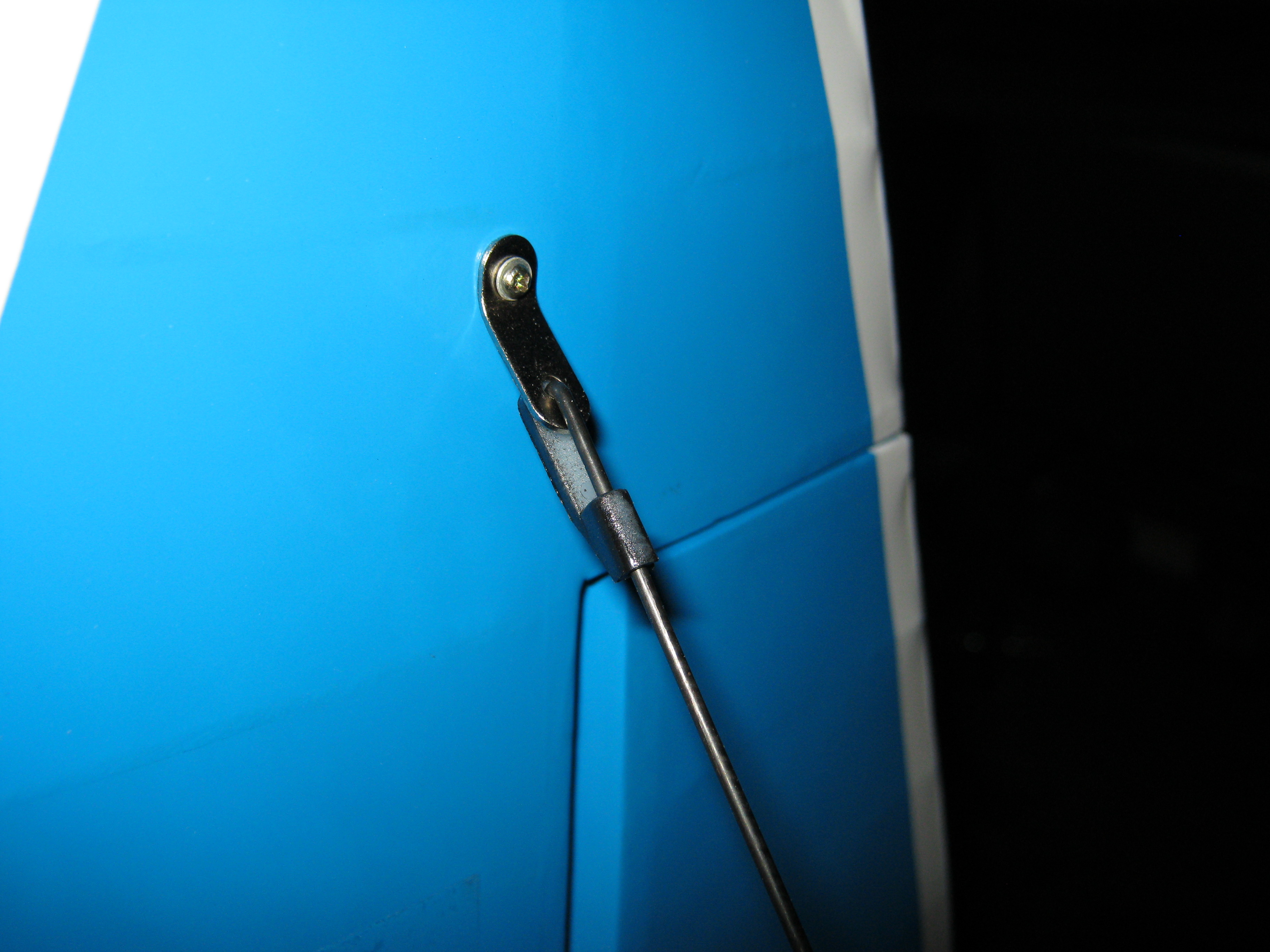

A few pics of last night and the routing of the hot ignition wire from plug. The picture of the quick connect on the stabilizer reflects a paint job. The white quick connect was a distraction and did not match the black wires. A quick blast of flat black and waaaa laaaaa.

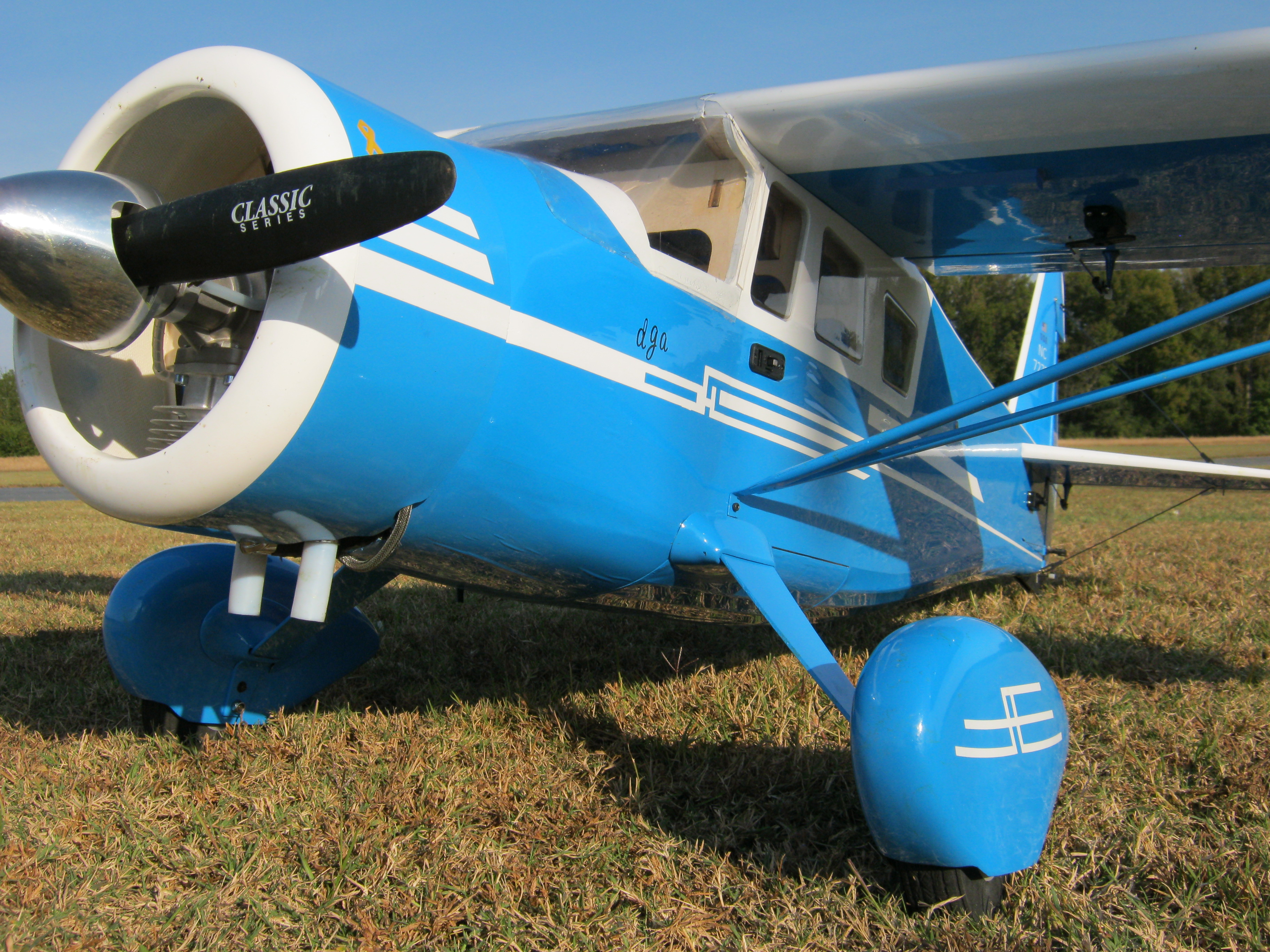

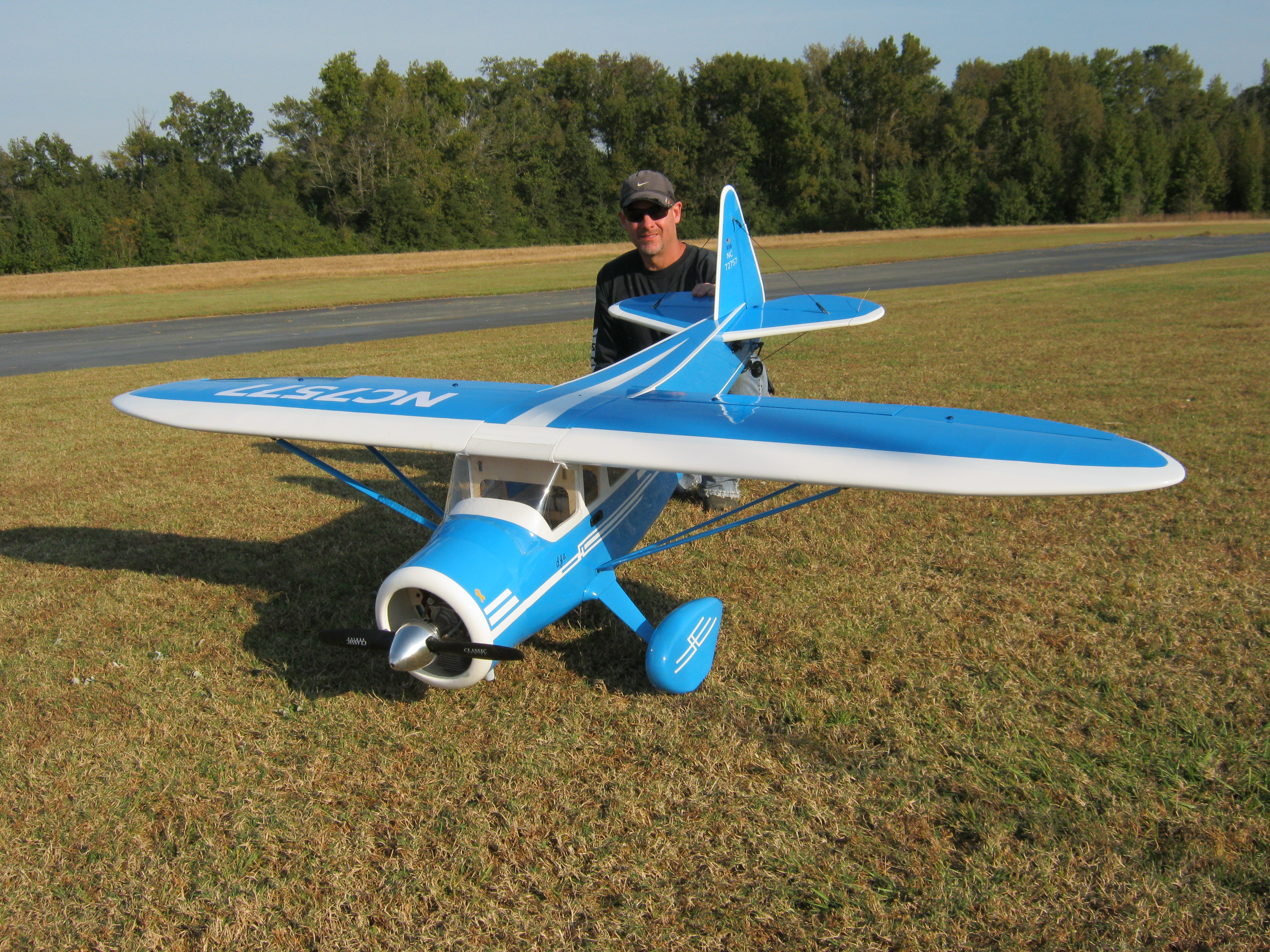

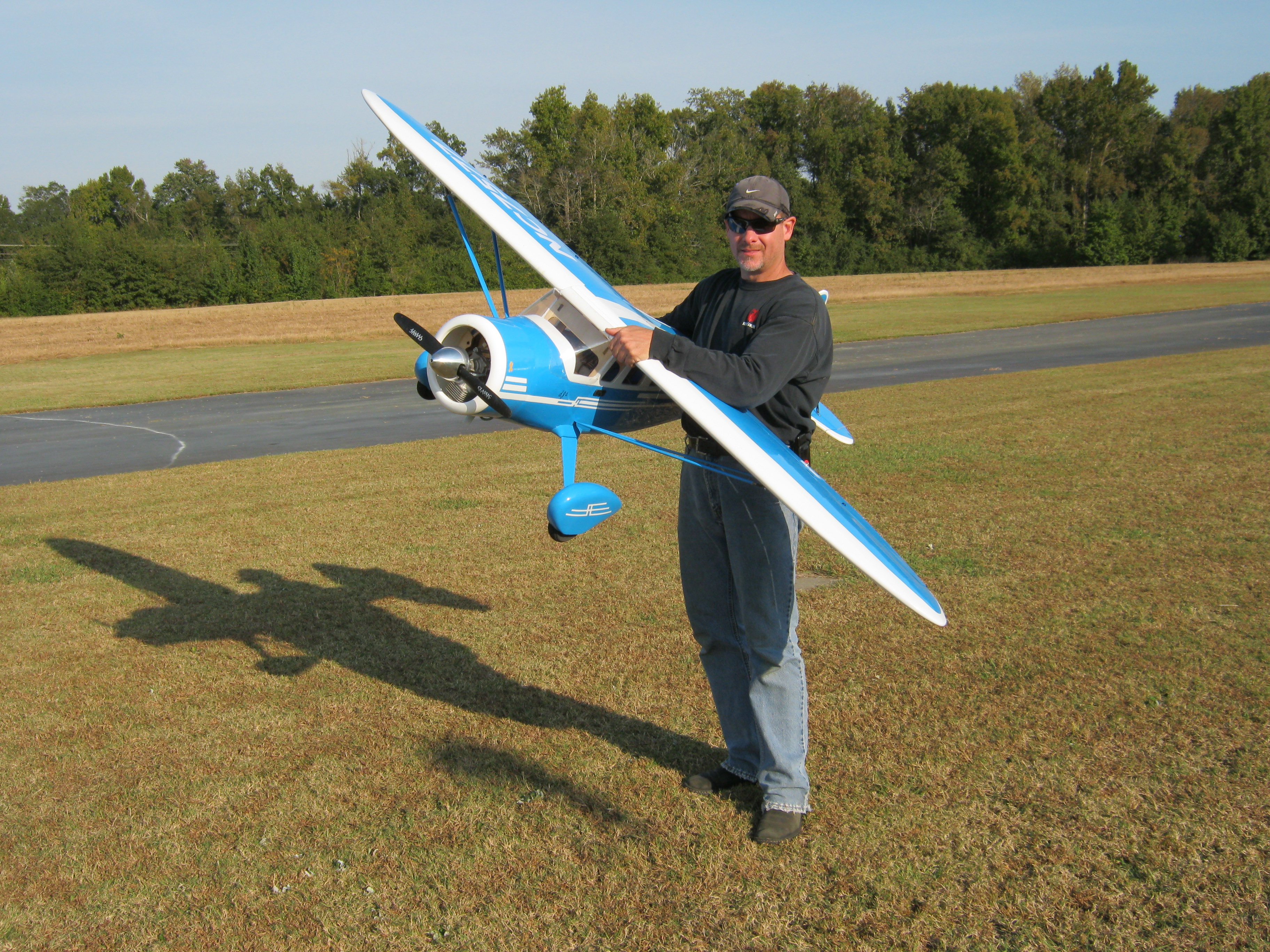

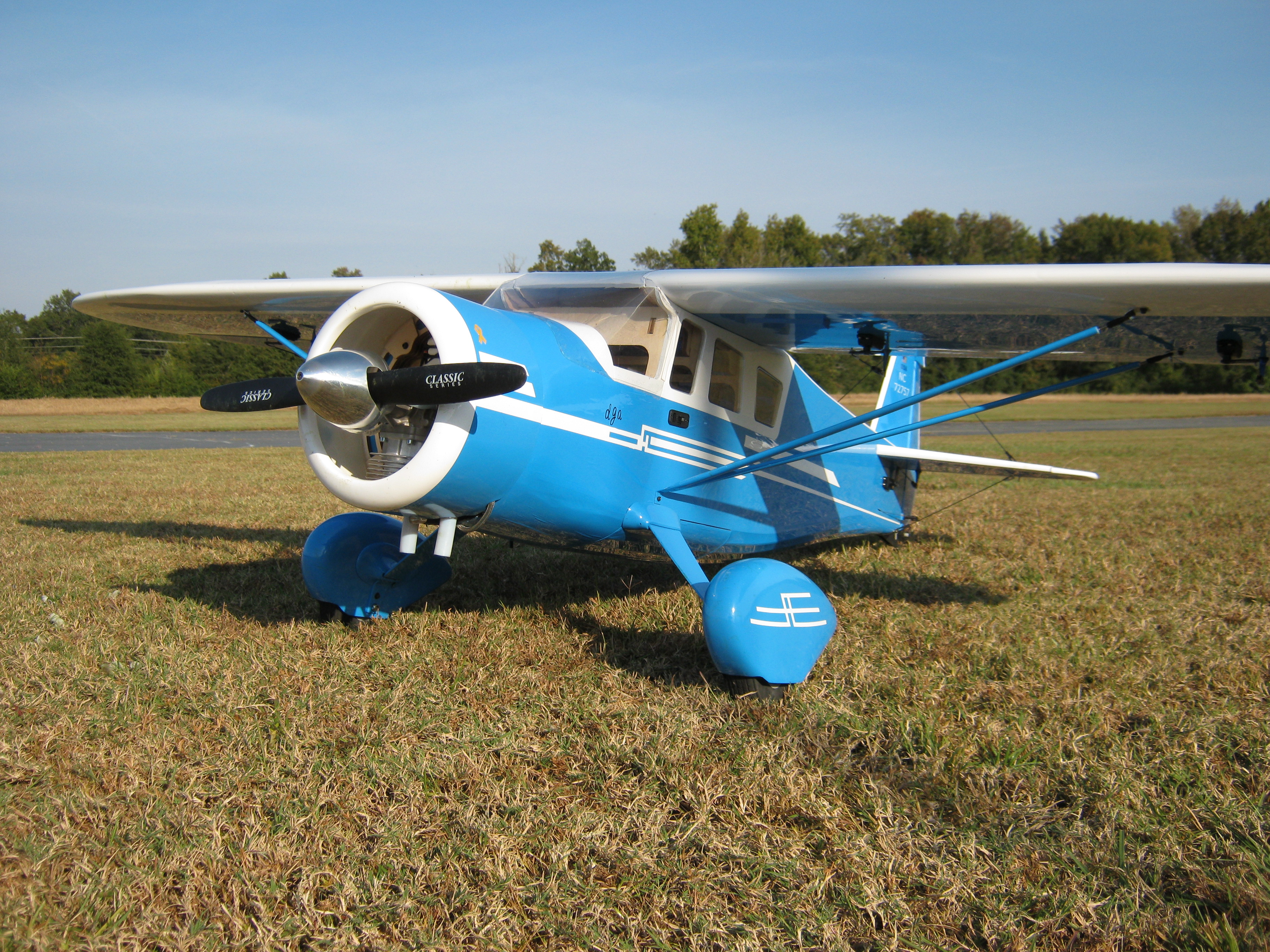

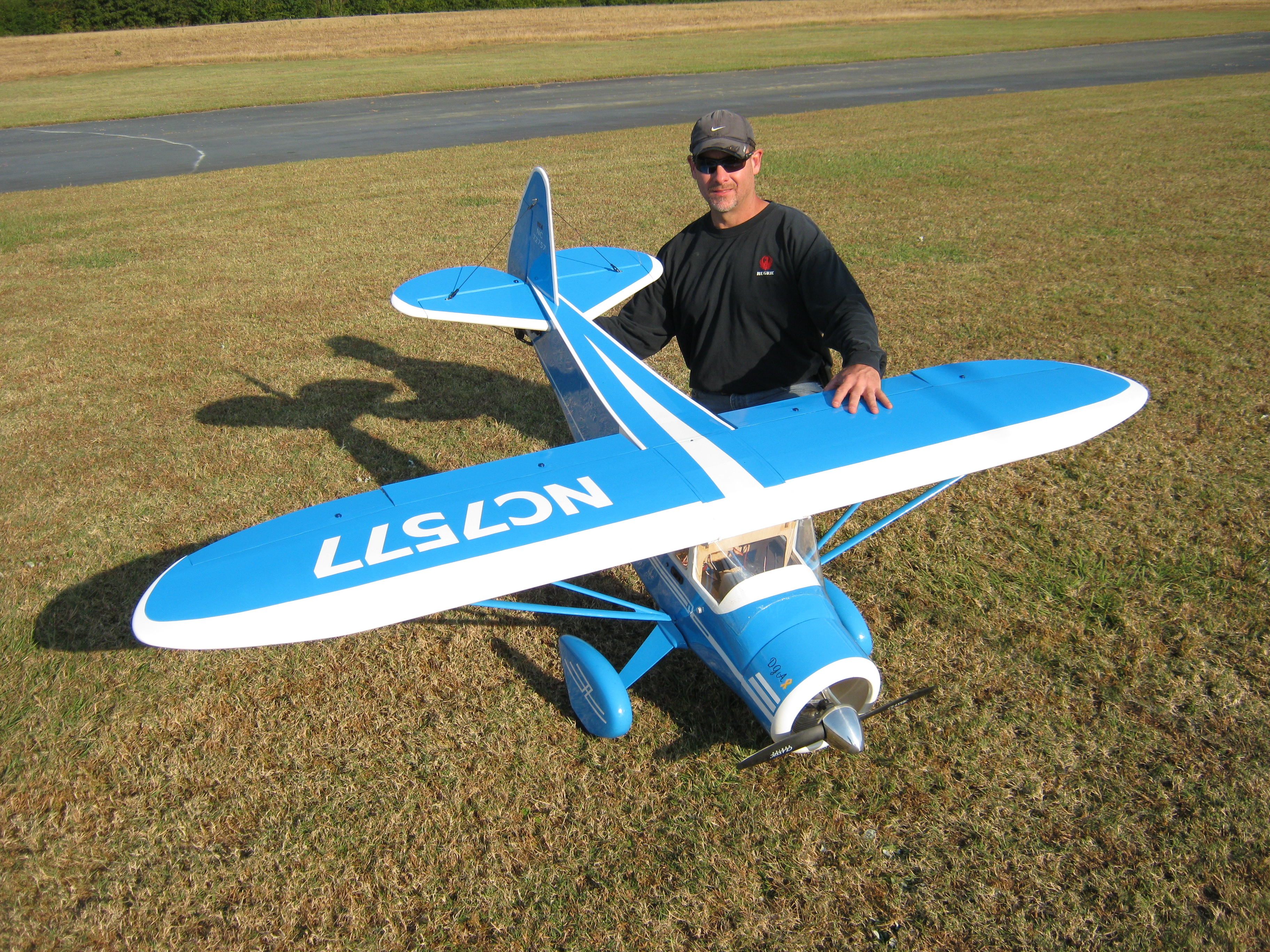

Maiden flight was Sunday the 27th in Dudley, Georgia. Wow I have never been so nervous. My pilot skills are "ok" and I have a good time flying; however, I have a long way to go. I committed to the flight and decided to let her loose. I decided a crash for lack of ground speed would not happen......it was full power or nothing. She tracked good and before I realized it there was loft and rise. Flaps were not utilized this day. After a few minutes in the air and very minimal trims I came in for a landing. I took out a few sweetgum leaves at the end of the runway and got her down safely. You could say a miracle had been witnessed. Second flight was great and the landing greased. WHEW my knees were locked like a virgins legs on prom night ! I checked the plane for loose bolts and issues........found "0". The sweetgum tree left 4 leaves in my cowl and a 10 inch tree top wedged in my strut.
The CG was slight nose down with 4 oz on the nose. I can remove the 4oz once a minimal battery movement is completed.
The Howard is breathtaking. Its a big plane and remember to keep up a lil speed coming in. Better a lil hot than a stall tip wing crash. I had absolutely no hint of a nose over on ground work. I tested her in the grass with full elevator and the tail never bumped up and down. One modification will be a tighter spring assembly on the tailwheel. I found the tailwheel not responding with authority once the rudder is moved. An exageration of the rudder was needed to get adequate tailwheel movement. This wont work for me and its a quick fix. Thanks for looking at my build. I hope it helps someone a lil bit in the future. I am a novice pilot and builder of 5 arf"s so my contribution to a builder's cause is probably minimal.

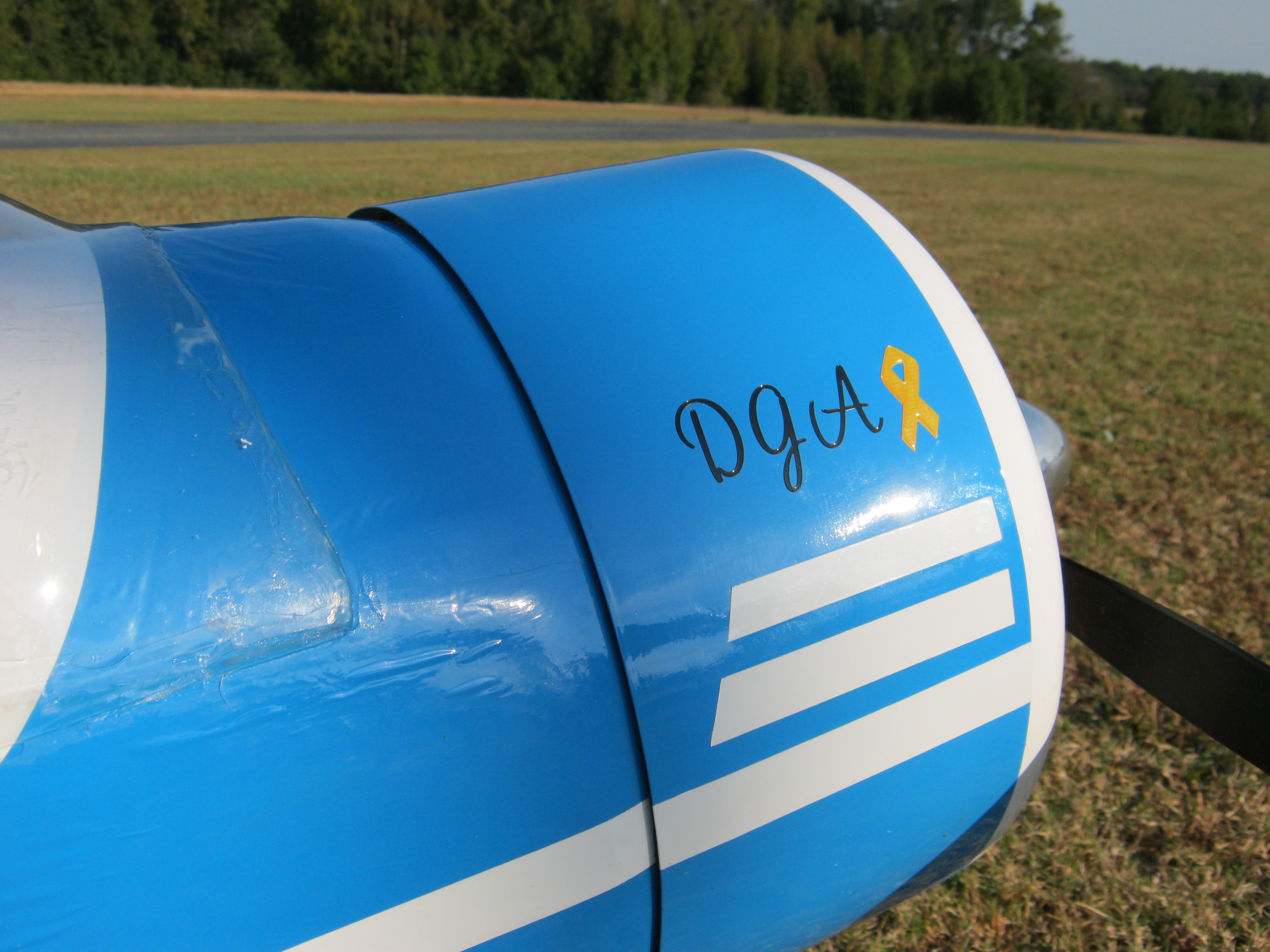

What is the lil yellow ribbon for ? It is a dedication to our fine US Forces we forget every day. We have the luxury of flying airplanes with friends without a care in the world. This would not be possible without their efforts, bravery and dedication. I too often do not think of our US Forces and their struggles. Can you imagine what the families go through as well? My lil reminder is a ribbon on my plane cowls. Im not sure about you but I could do a lot better thanking the US Forces. We could all do better. So next time you see any member of the US Forces just tell them thanks ! Trust me it wont cost you a penny but will pay hundreds.

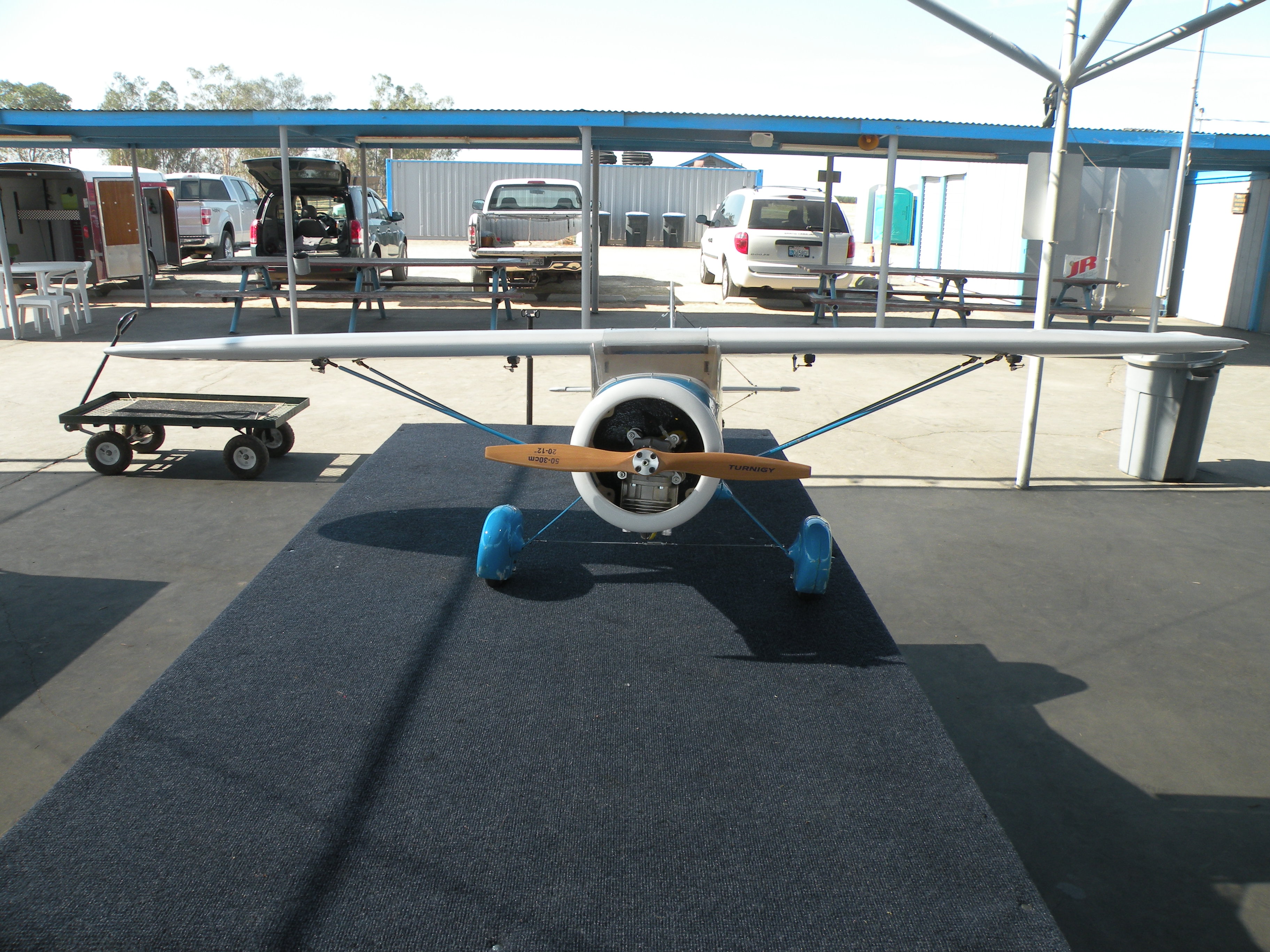

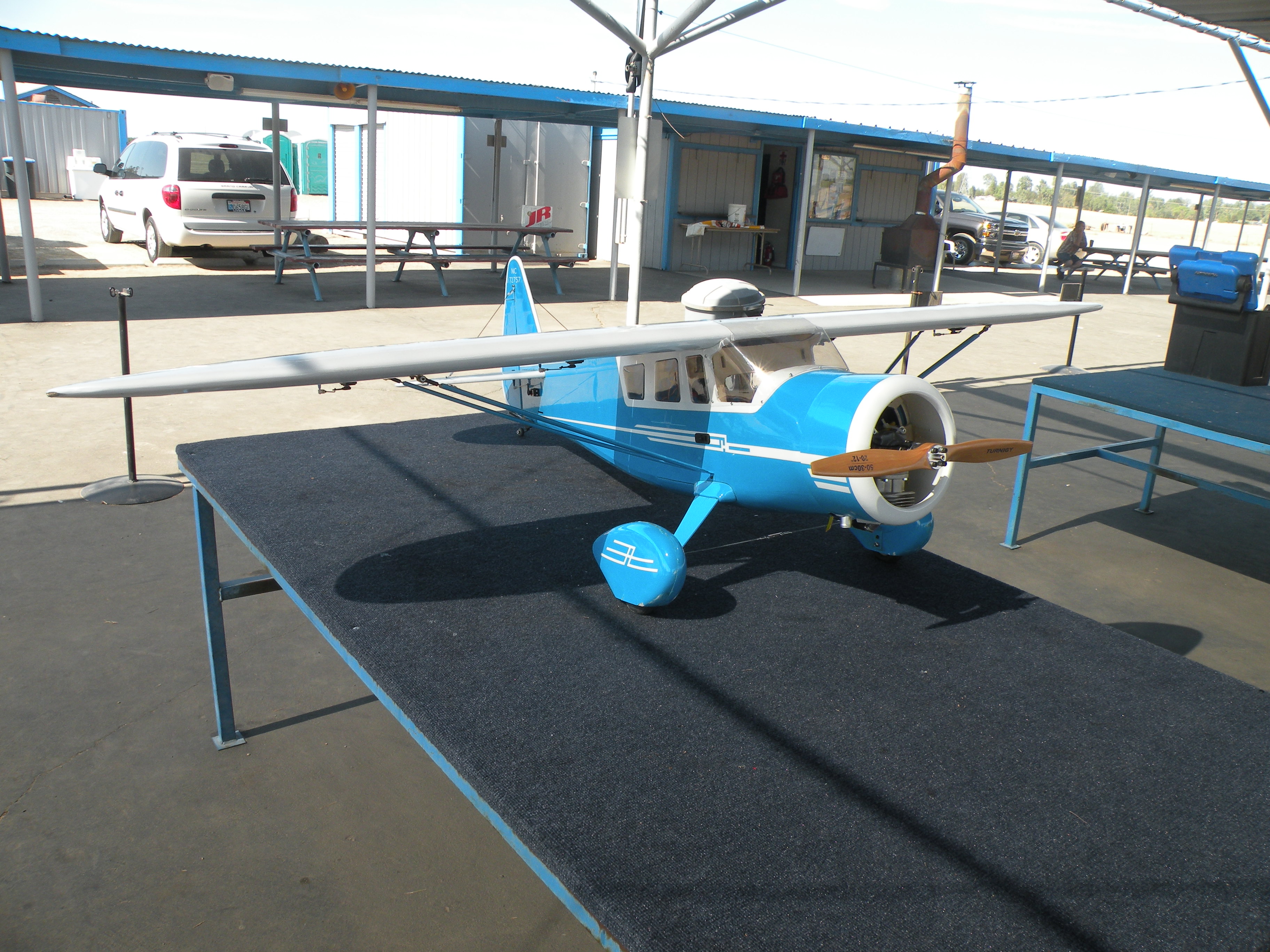

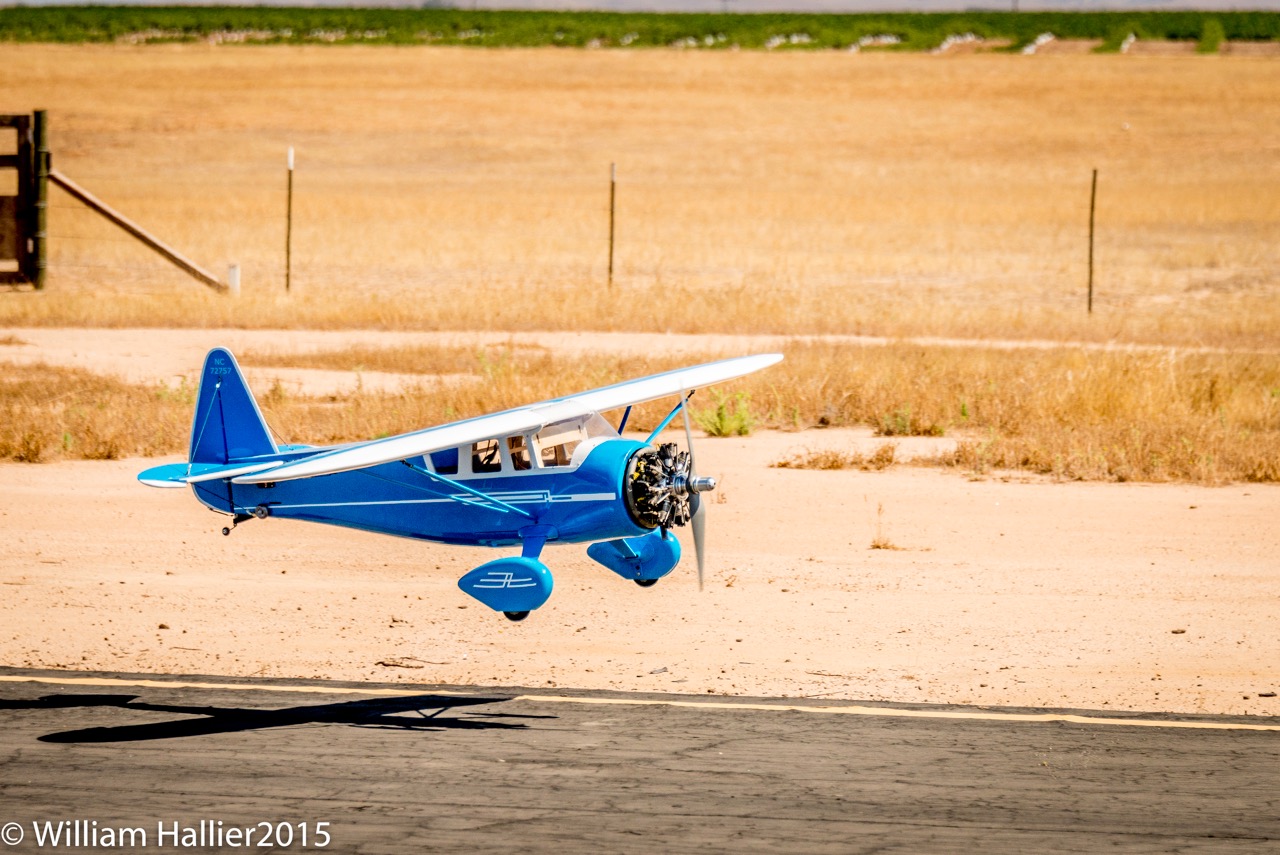

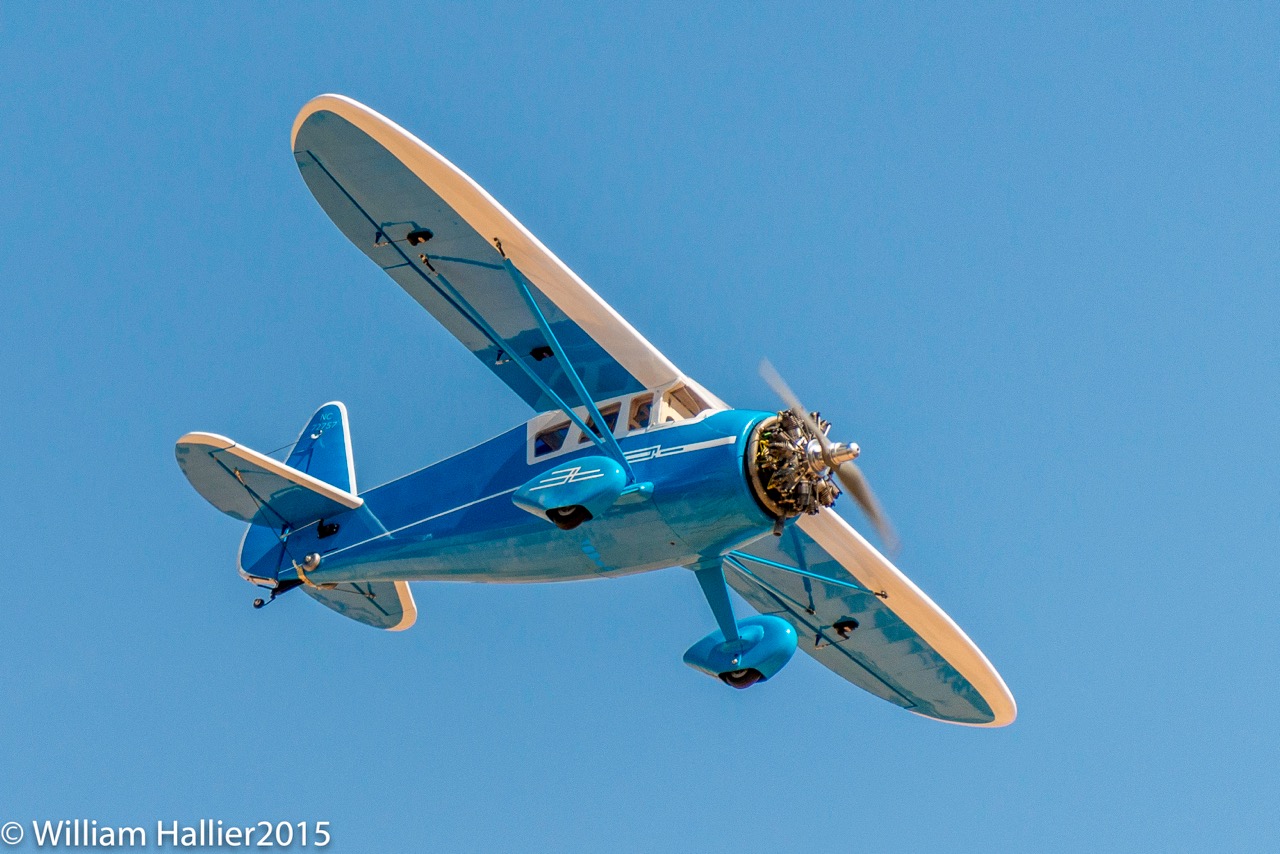

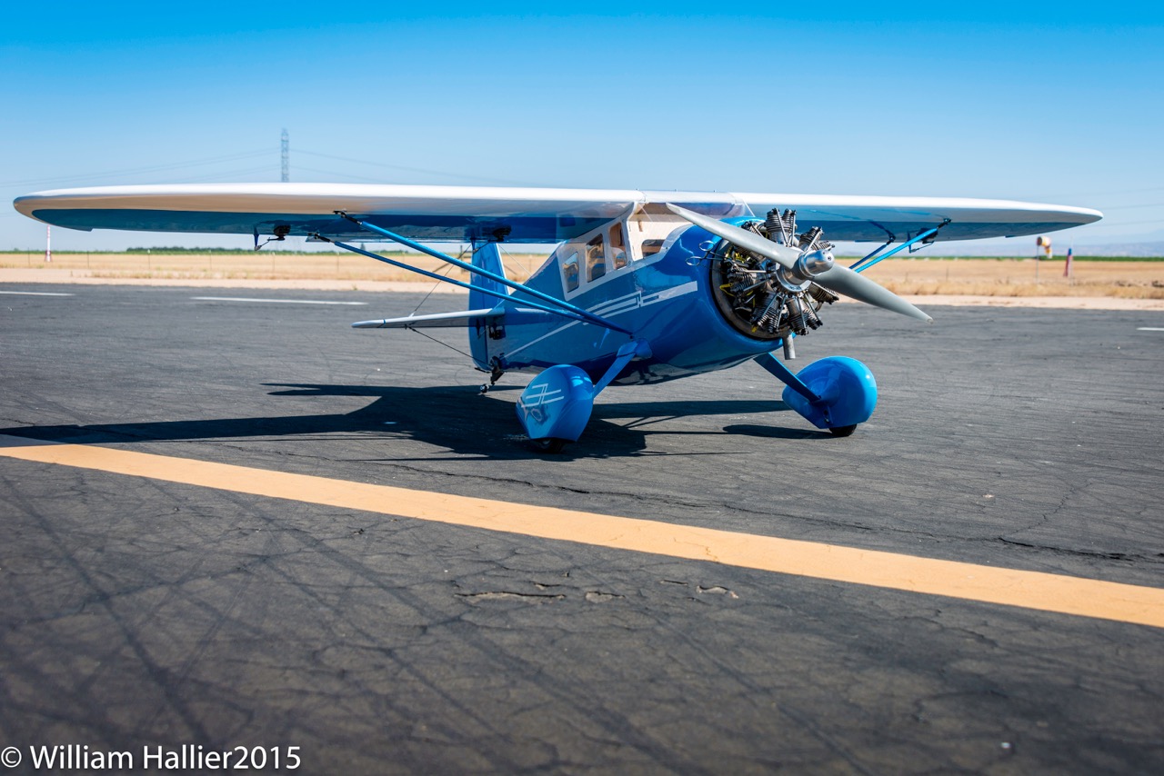

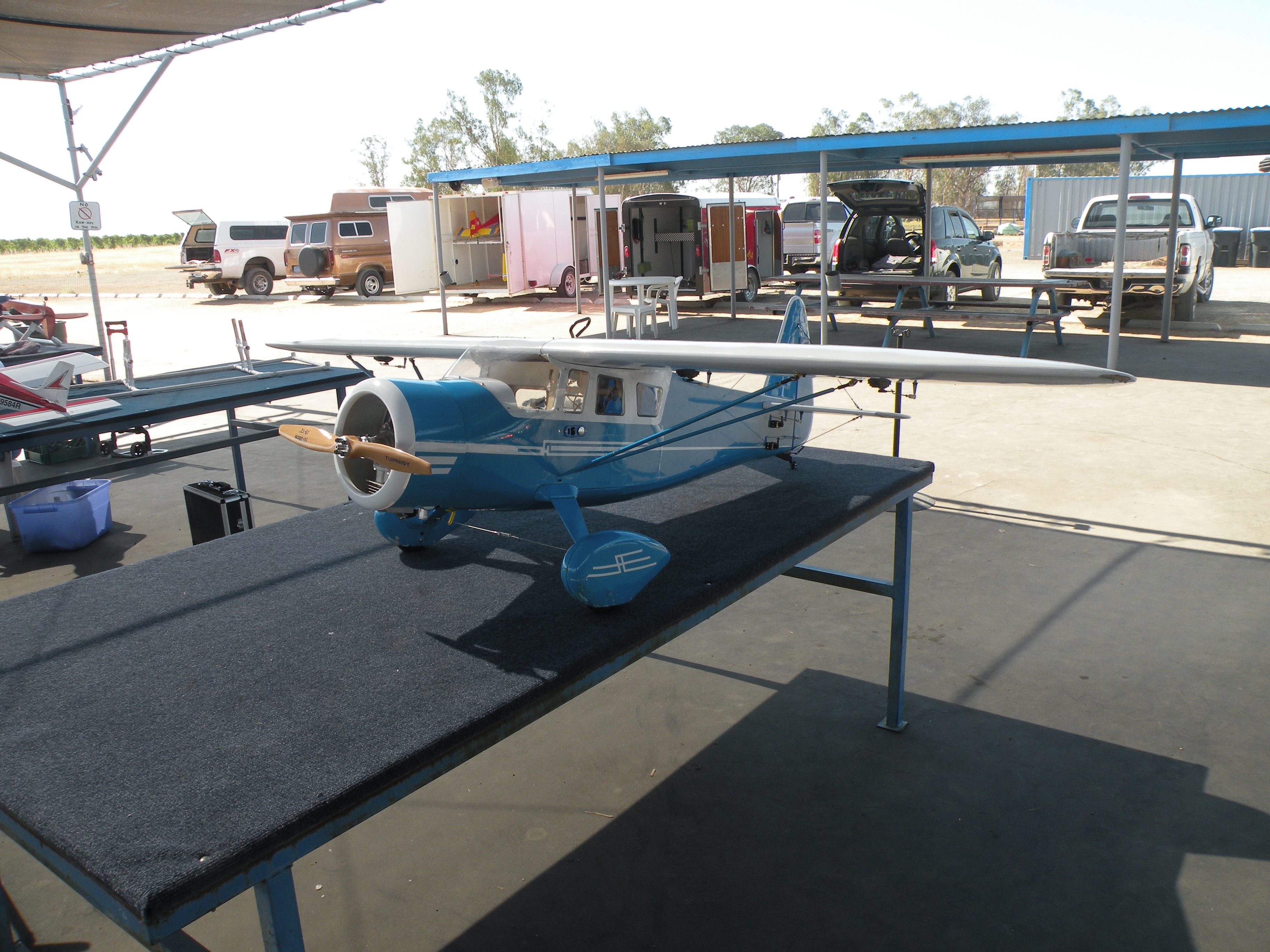

Here are a few pictures of my Howard DGA 12. It was originally powered by a UMS Evolution 7-77 radial engine but is currently powered by a DLE 55RA. The DLE 55RA engine is way too much power, a 35 would be more than enough.
Best wishes and good safe flying.
