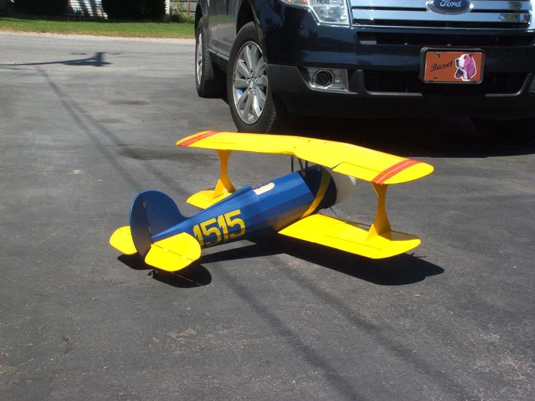

I've been working on the little GL.
I moved the servo tray forward, and made it removable. I lightened anything and everything, made from balsa, behind the cabin area. Larger tires were added. The tail is in place, and is covered. The top wing is covered, too.
Using a Saito .50, I did an initial balance. Everything is right on the mark, per a suggestion made by a Hobby People employee, in an ancient thread.
I'm getting excited. I think this thing may actually fly ! I have hopes that I will get by without adding additional ballast. This should keep her in the correct weight range, specified at arounf 6 pounds.

Between assembling a few ARGs, I've been working on the Great Lakes Bipe.
I started to cover her in Monokote, but I suck at it. The covering has been removed, and the airframe has been covered in Solartex Dark Blue, and 21st Century Fabric Cub Yellow.
Doing this deviates from my original "Keep iy as light as possible" plan, but I had the covering on hand, and I want to keep costs to a minimum.
Roundels are on order from Gary at Decal-it. http://www.decal-it.com/ The rest of the markings are from a Pica FW 190D decal sheet.
I need to mount the Saito 50, and re-check the balance. A coat of clear is needed for the Solartex, too.
