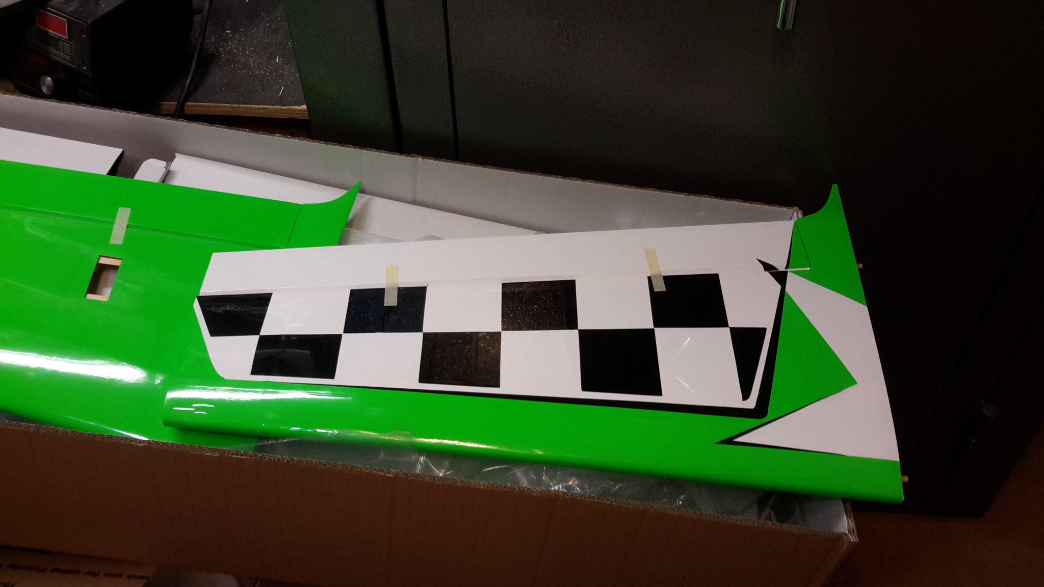

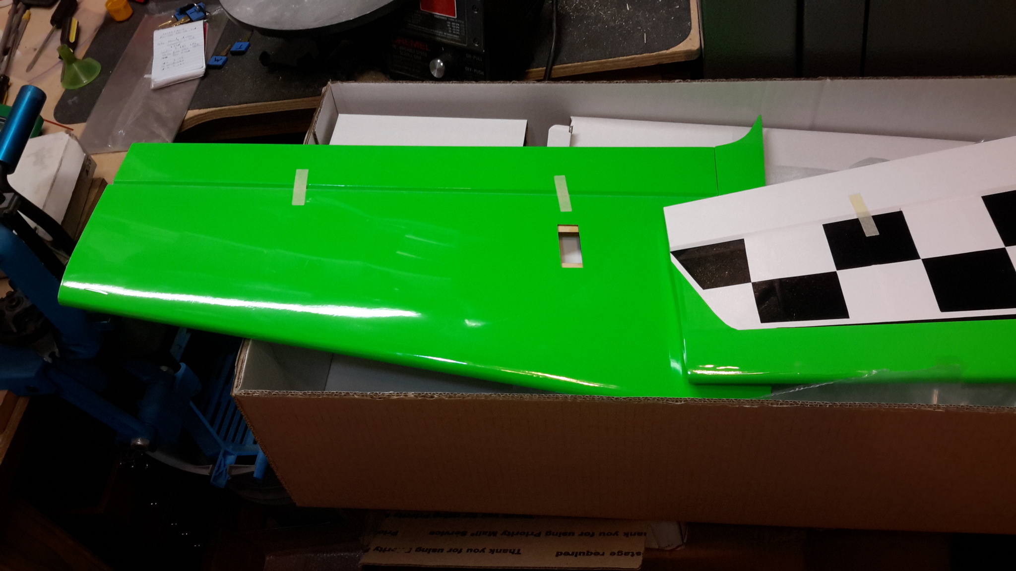

Upon initial inspection I am really I pressed with it, especially for $140. The covering is very good as is the paint. The construction looks to be very clean but I did of course go over every glue joint that I could get to with mostly thin but also some thick ca in certain places.

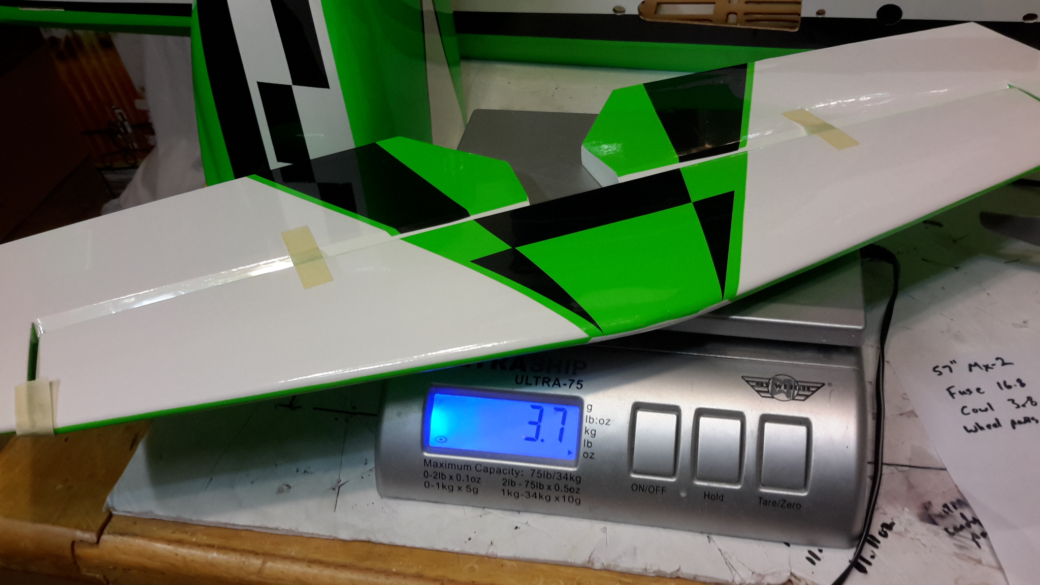

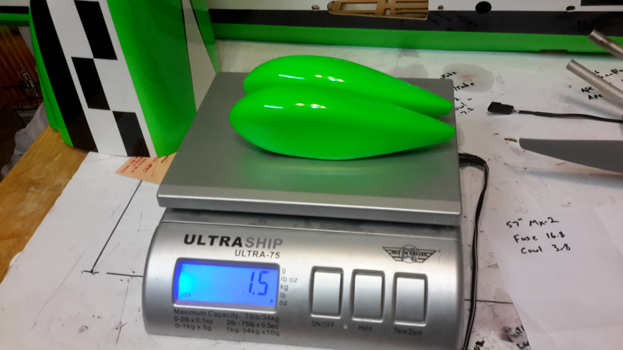

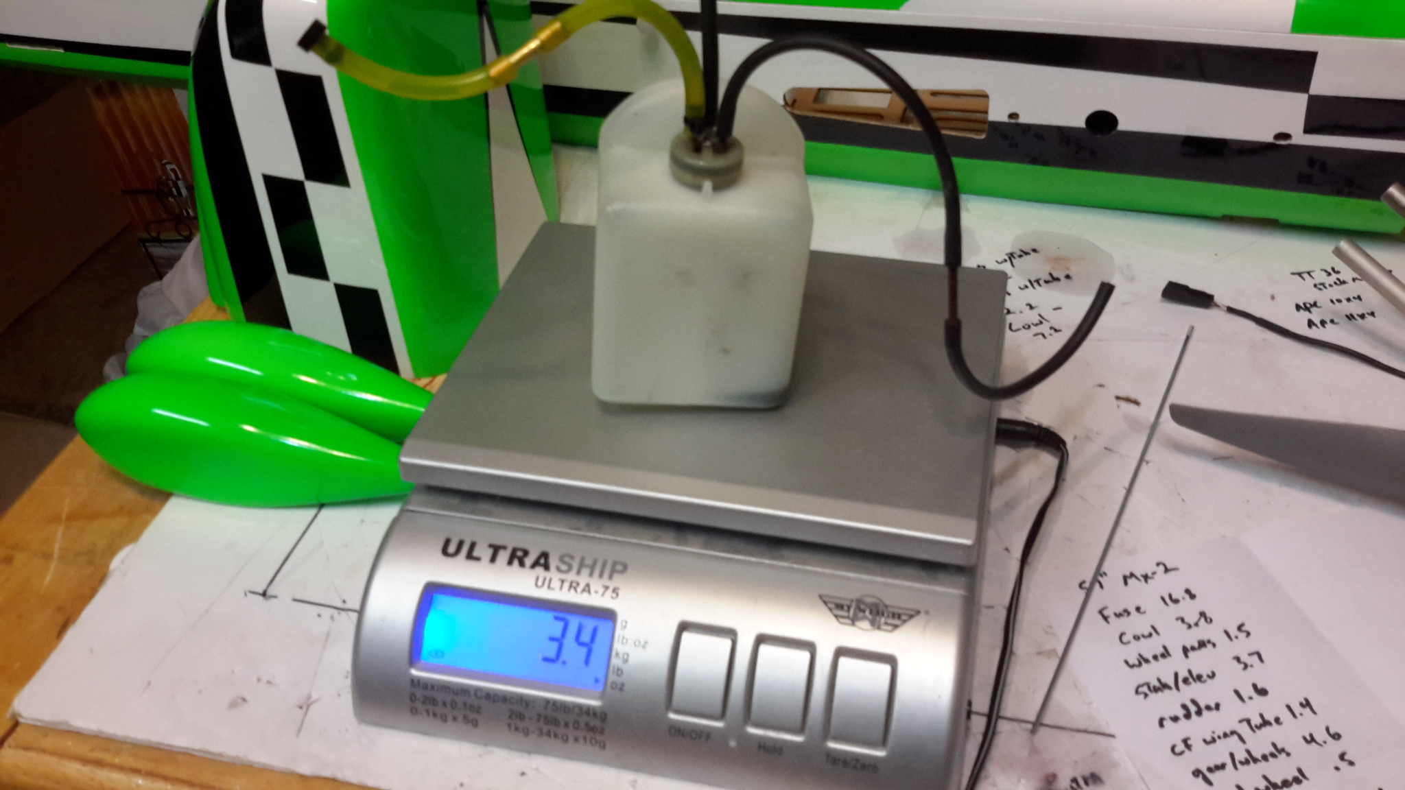

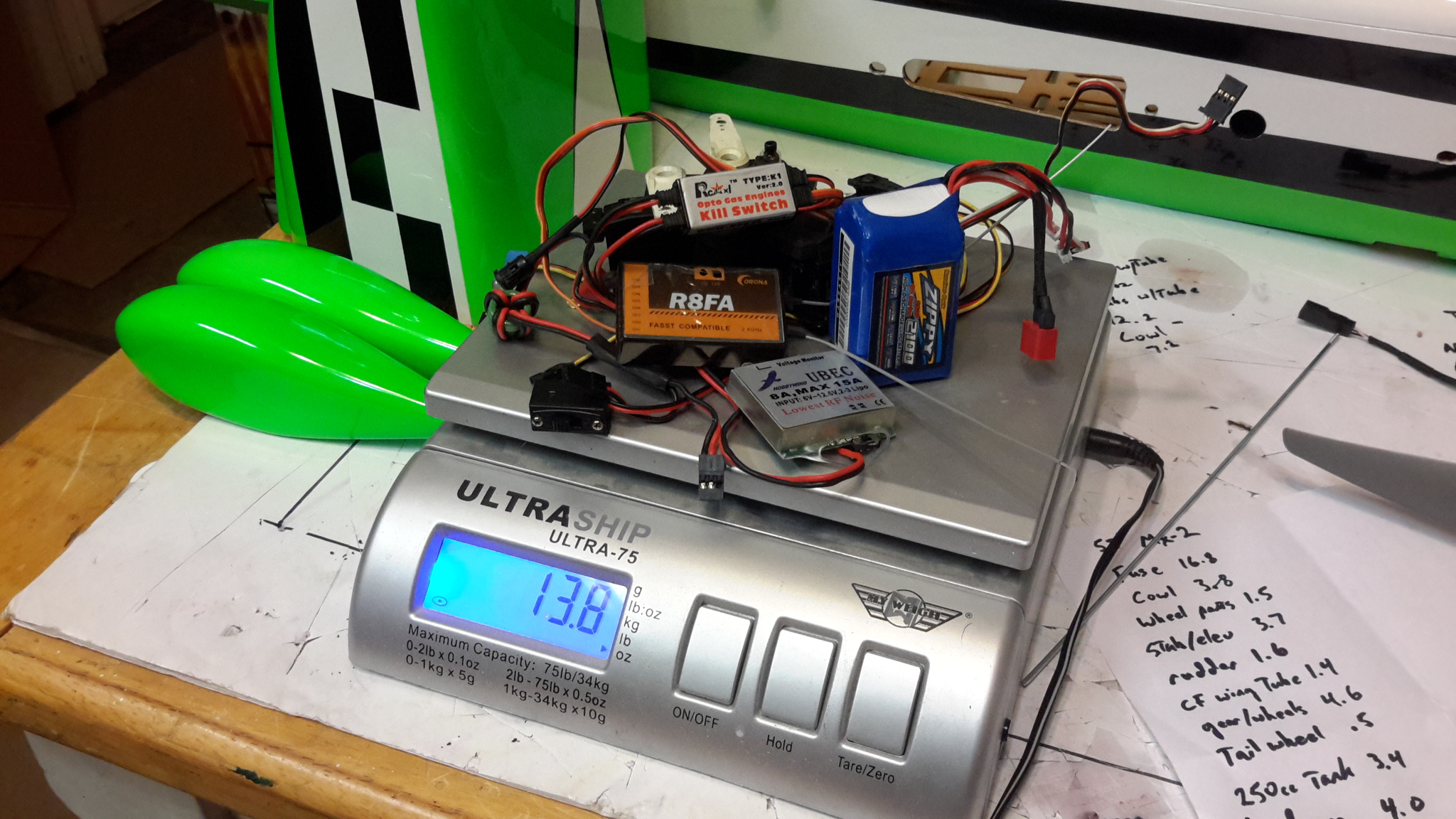

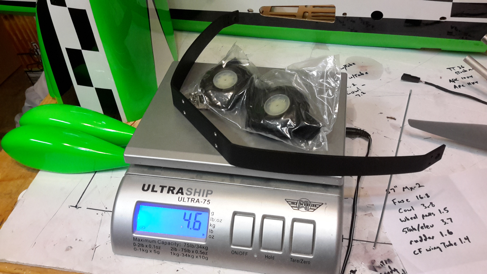

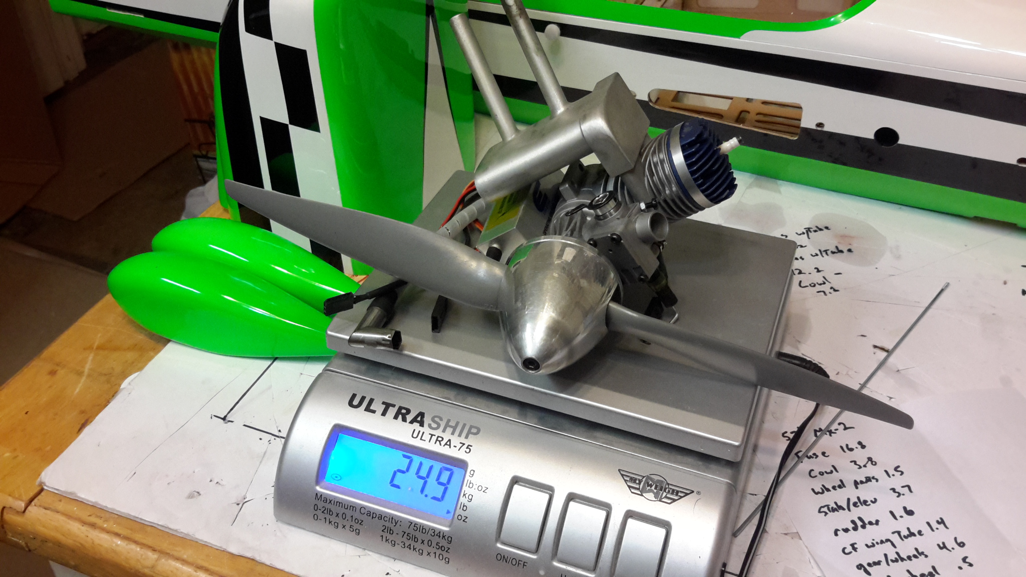

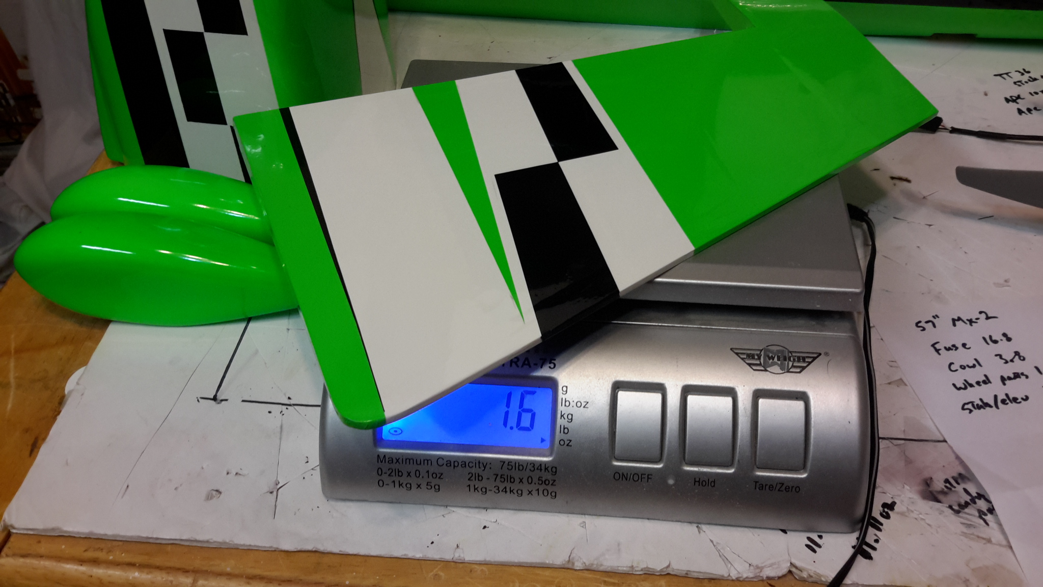

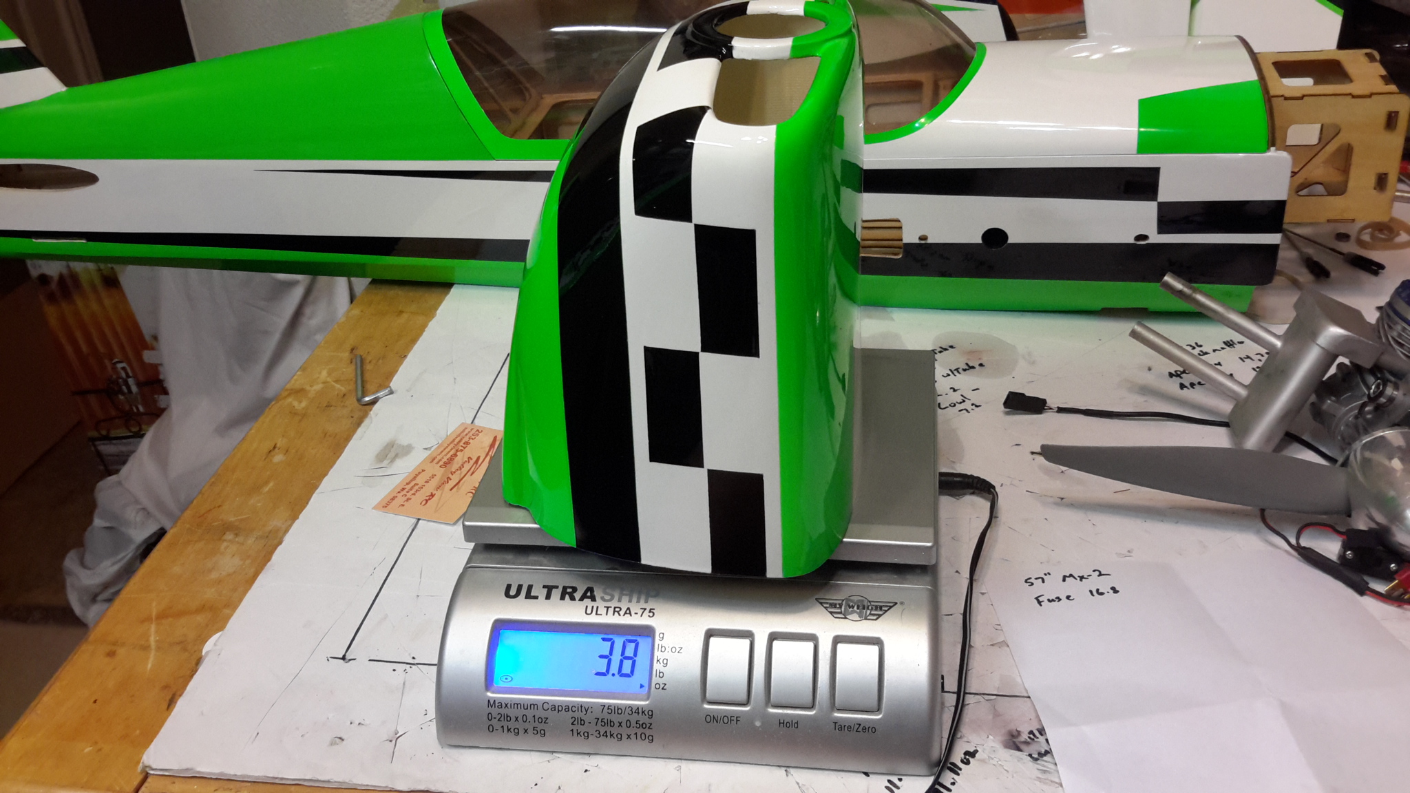

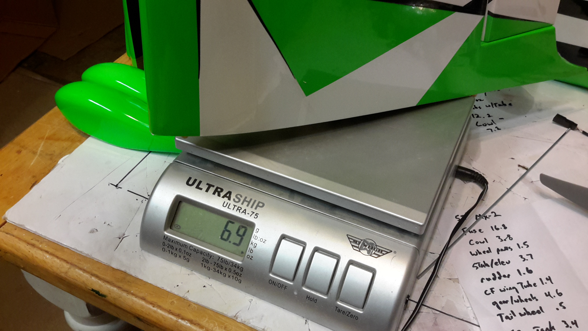

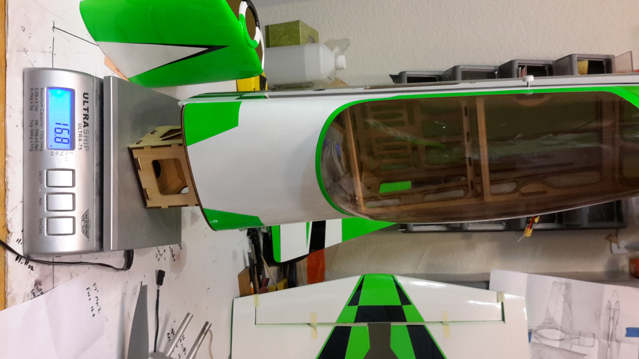

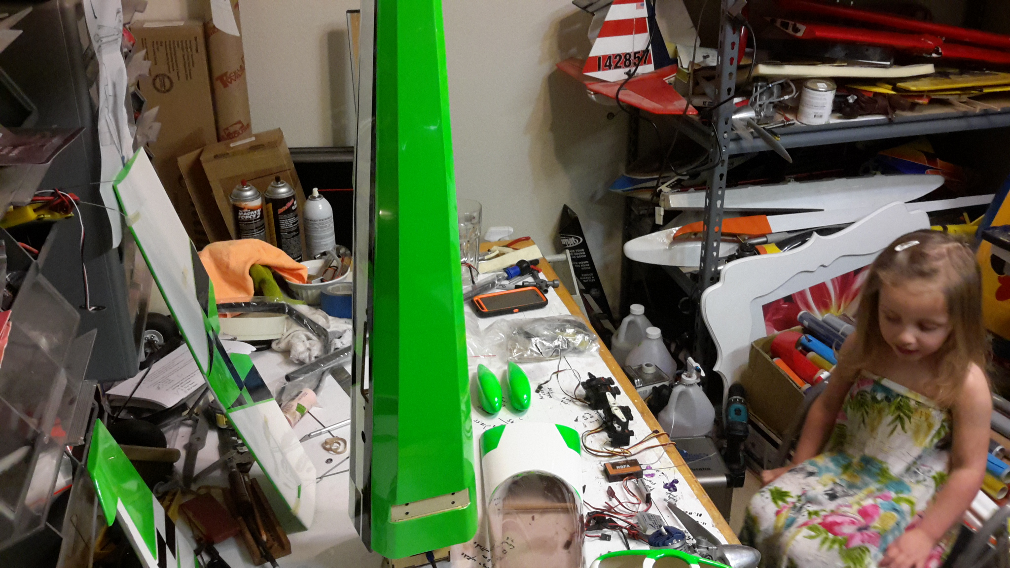

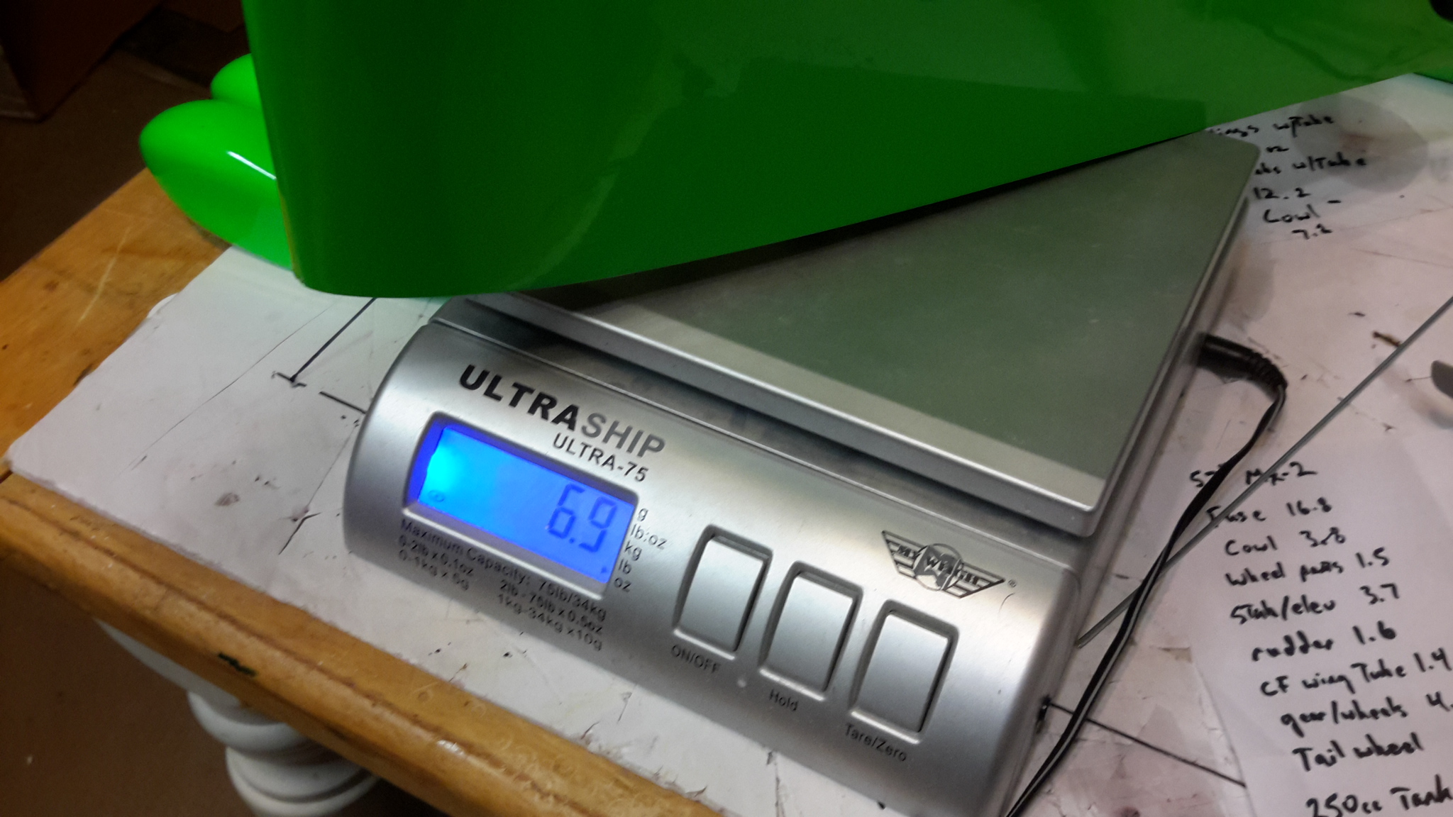

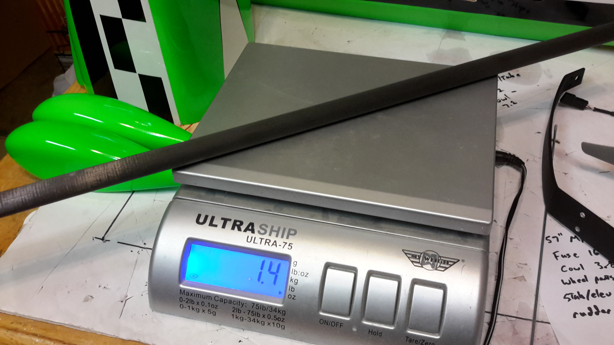

Here are some initial pictures and the start of the build process. I also took pics of pieces as I was weighing them to estimate all up weight. So far it looks like I will be under 6 lbs which should be pretty good, maybe not crazy electric power, but using a 6.5 oz fuel tank I will be getting 15-18 minute flight times which is nice.
Total right now is coming in at 5.83 lbs which looks to be ok.

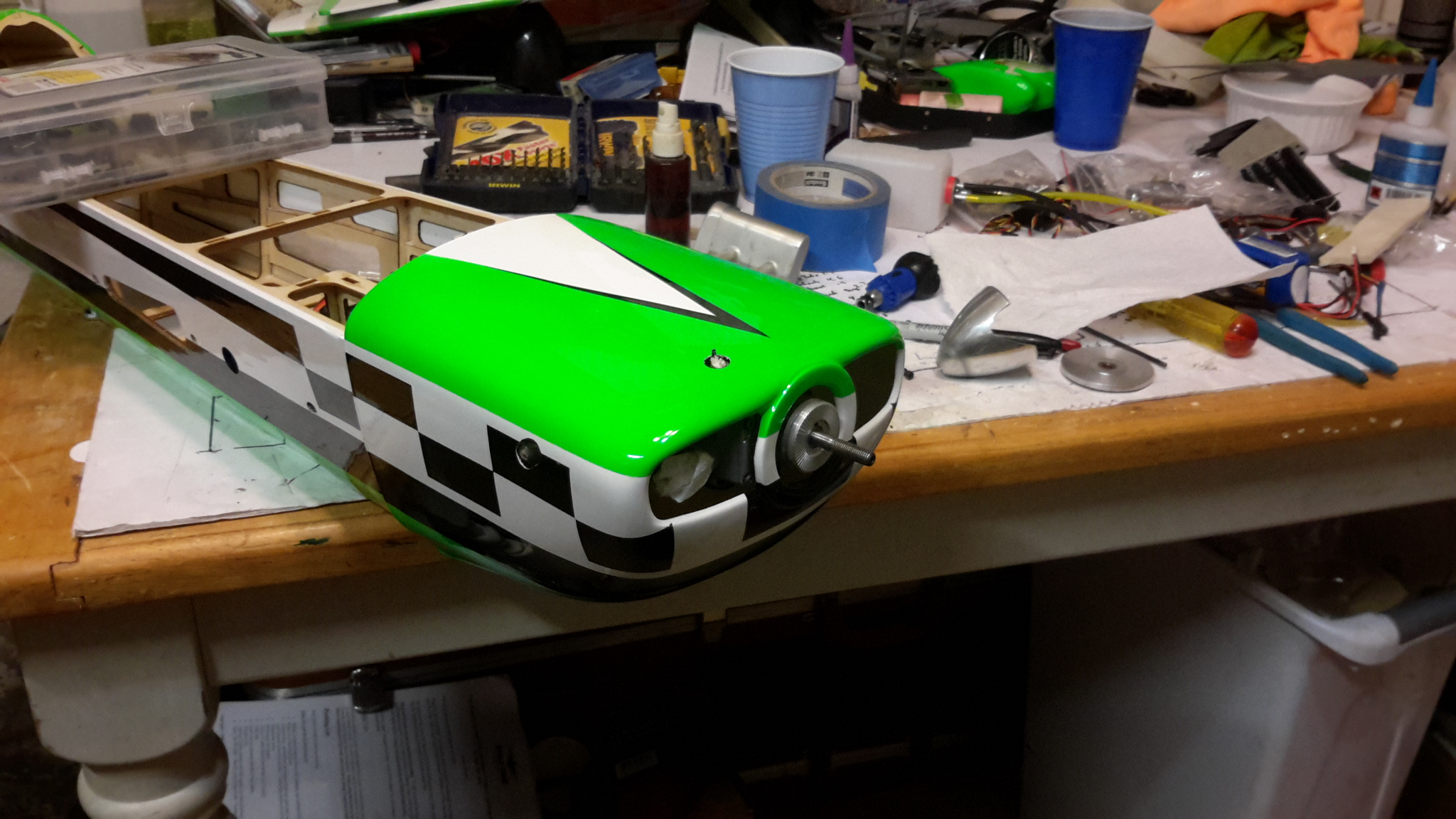

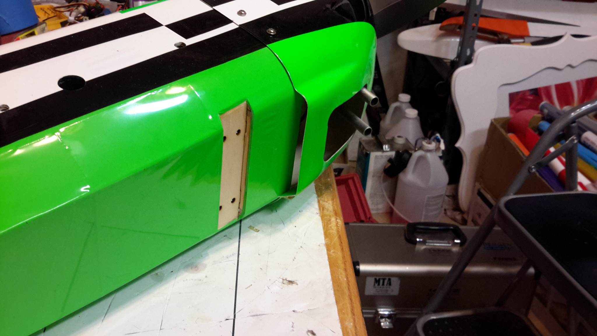

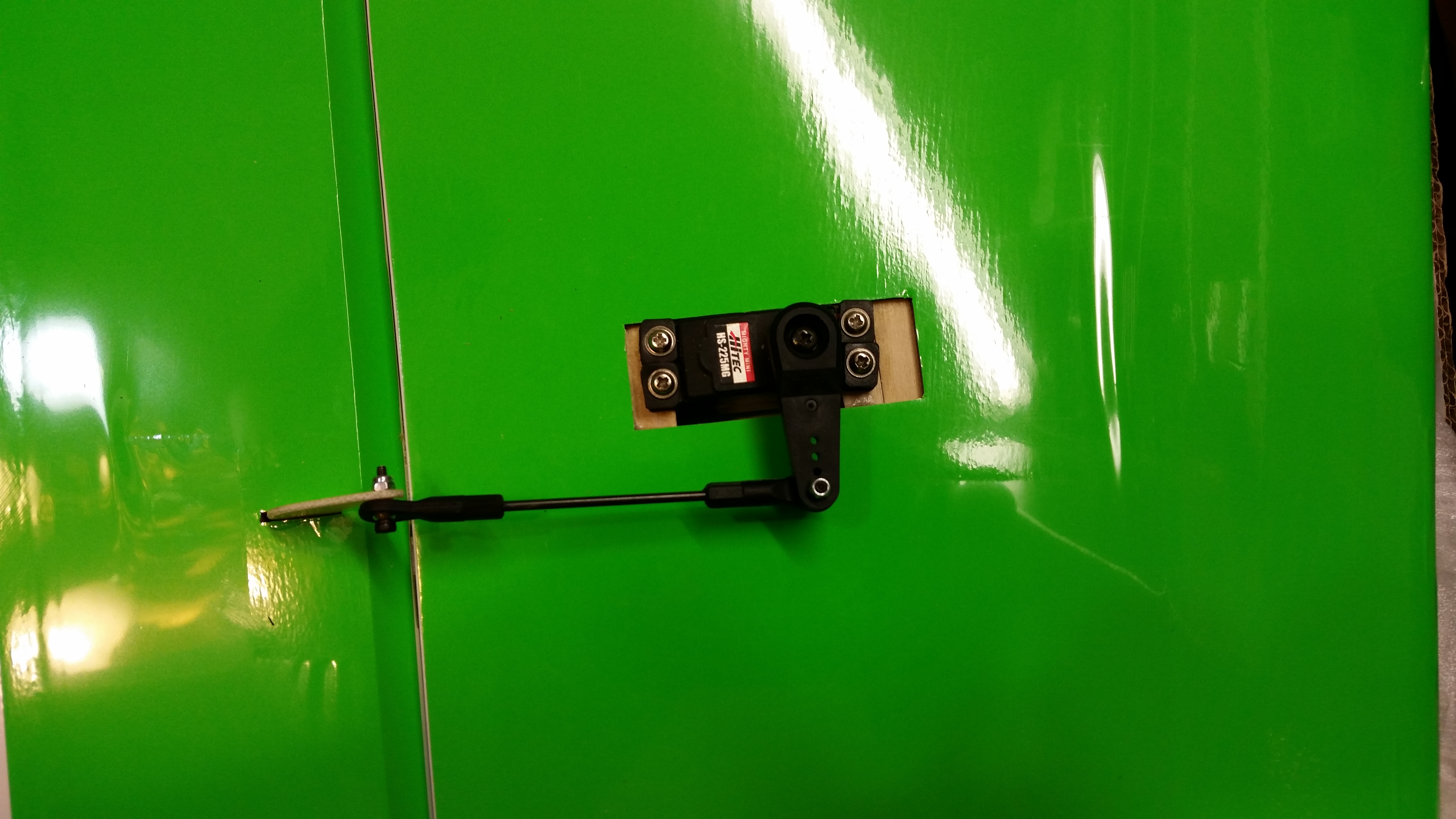

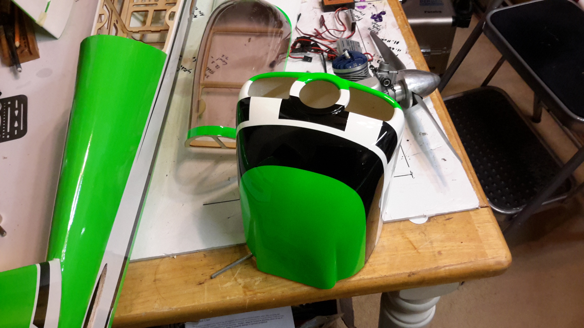

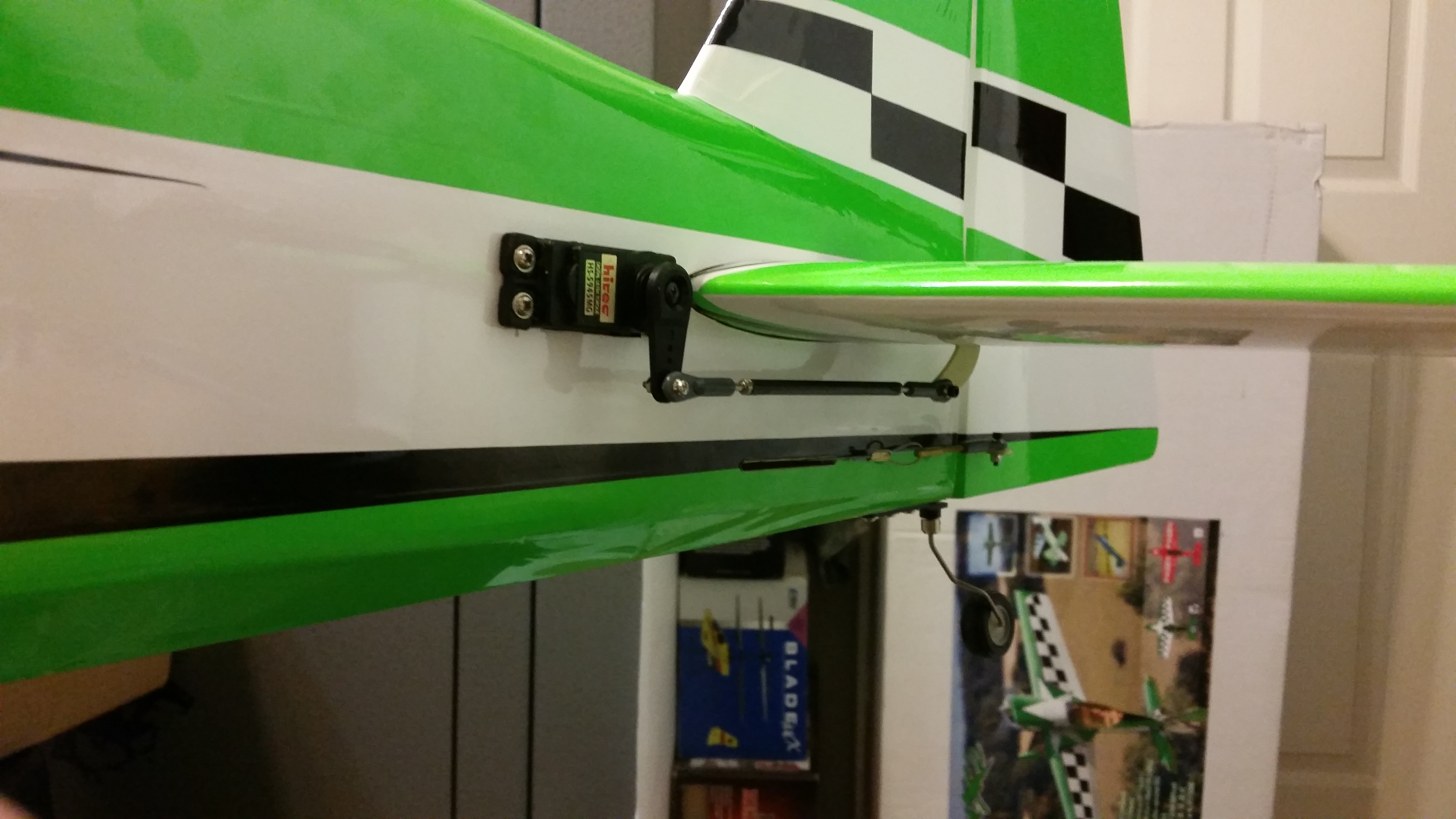

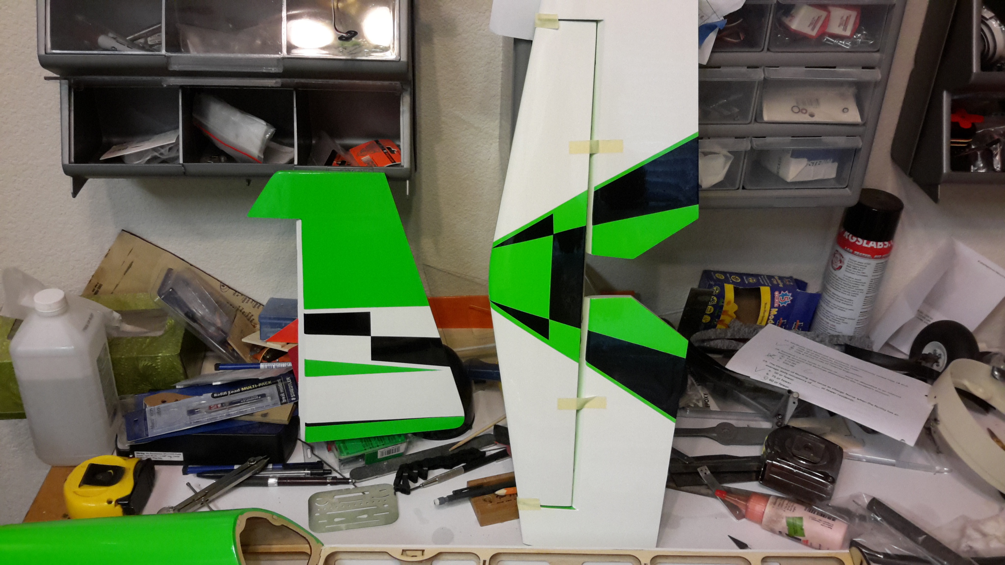

So I am continuing work this evening as I started last night. One little item that I found a little different is that the airplane comes with a small DVD instead of an instruction manual, and it is kind of generic covering several different airframes. Really not a big deal to me, the only things you should really need it for is the firewall to thrust washer measurement, and the recommended cg. Otherwise if you have assembled an arf or two it really just kind of falls together.
With that being said, the DVD calls for you to install the horizontal stab, elevators and rudder right off the bat. I do not like assembling in that order as I think it is much easier to get the engine lined up and mounted while tail feathers are not in the way. This allows you to stand the fuselage straight up while getting everything set. One thing I did notice is the recommended distance of 115mm from firewall to the thrust washer seems to be 3-5mm too short. I followed the recommendation and the pattern on top of the cowl going to the turtle deck is a bit off. I am not going to worry about it as with the heavier engine up front I do not mind having it set back a bit, but it is worth mentioning.
I now have the engine, throttle servo, fuel tank and rudder servo mounted. I have also fitted the cowl and trimmed it to the muffler and spark plug boot as well. The cowl came withing 1/8" of clearing the plug boot, but I did have to make a small hole to clear it, kind of looks like an igniter hole for glow. I still need to block off the hole opposite of the cylinder head in the cowl, and I am going to cover the open structure of the F2 former to prevent the fuselage from being pressurized by airflow, and to prevent exhaust gasses from going into the lower fuselage. I will probably cover the top, bottom and sides of the engine box while at it. Lord knows I have more than enough scrap white covering.
Once that is done I will move to the tail feathers and landing gear. The ignition box for the 10gx comes with quite a long spark plug lead so I will have some flexibility in where I mount it while making sure it is not too close to the receiver. This should help however with getting the cg right without having to add any weight. So far I am very impressed overall with the airframe, especially for the price. If it flies as well as I hope it does then I will be pretty pleased.

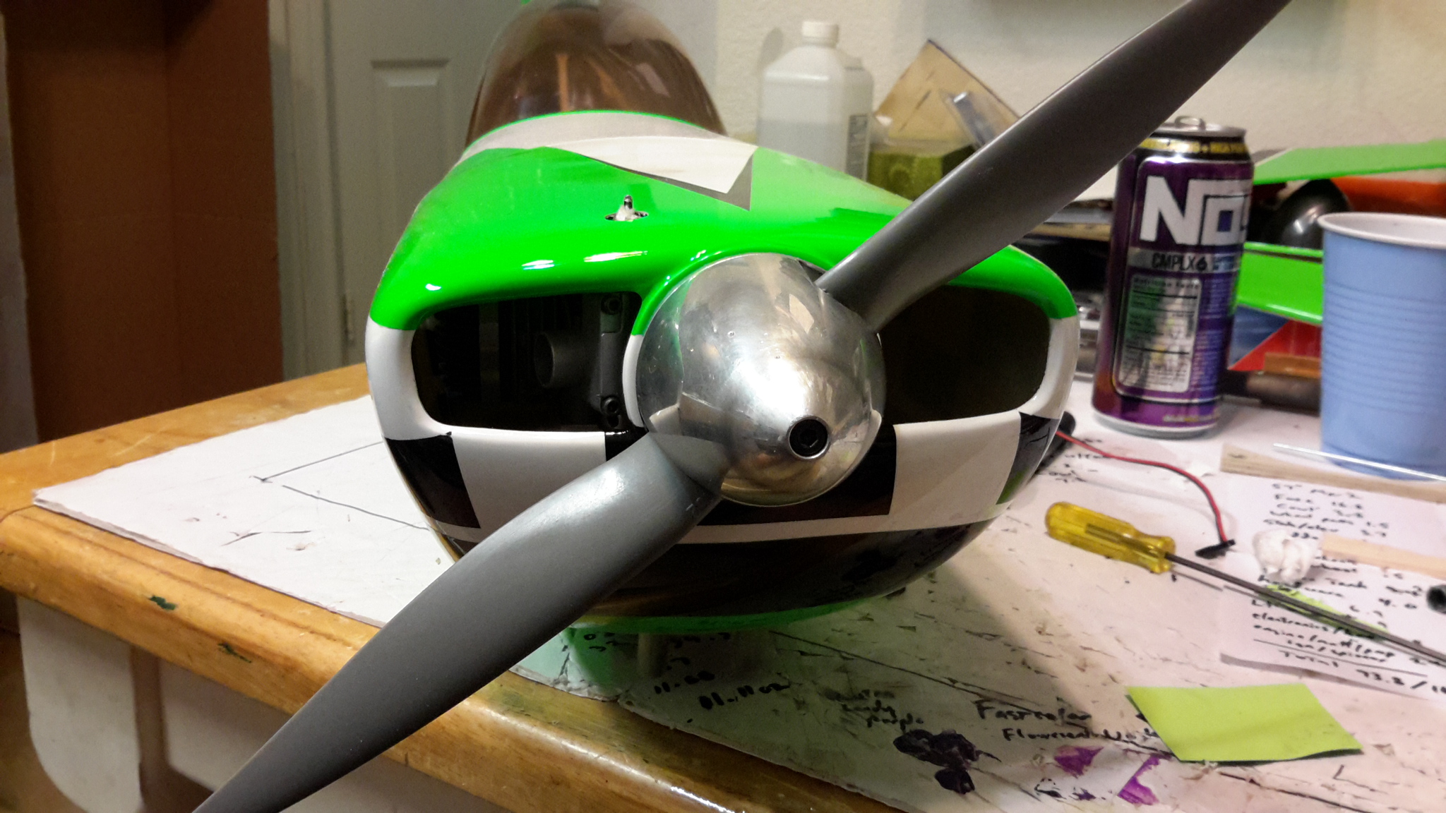

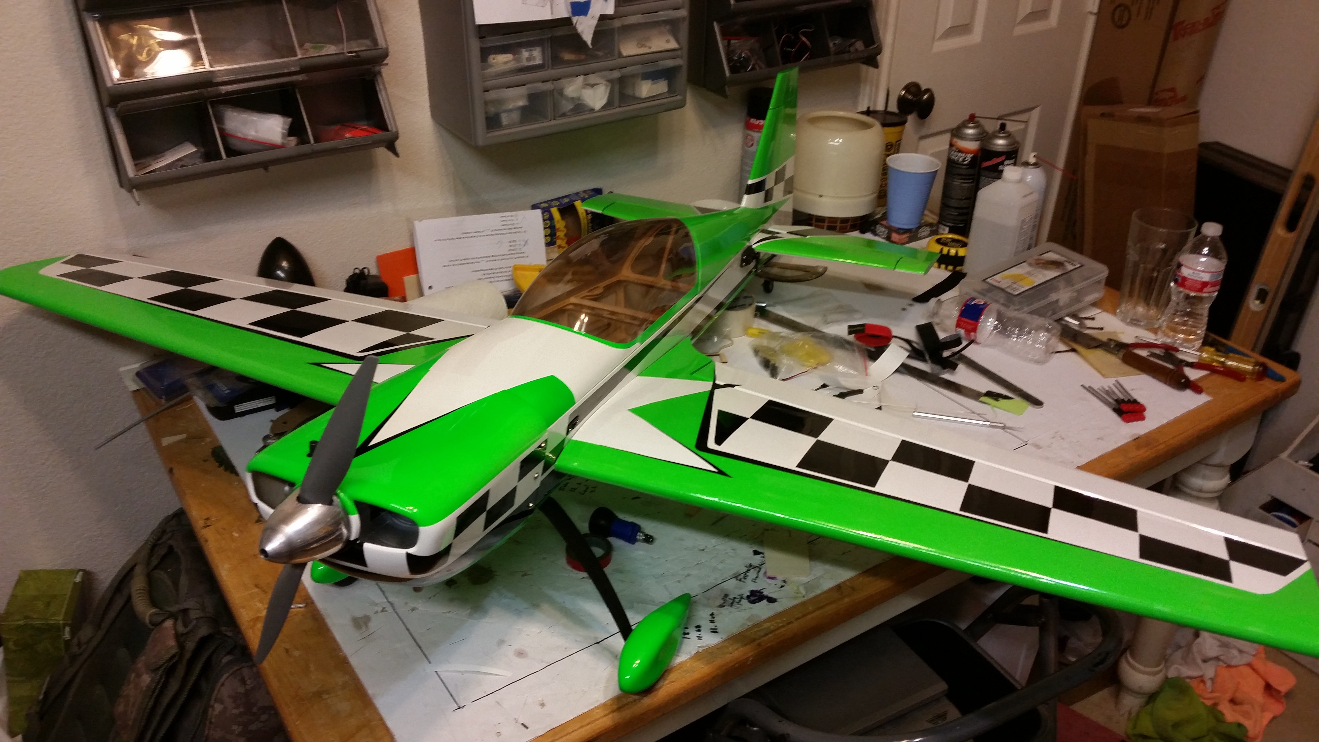

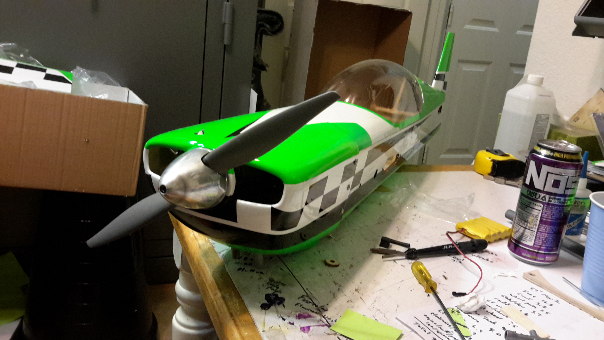

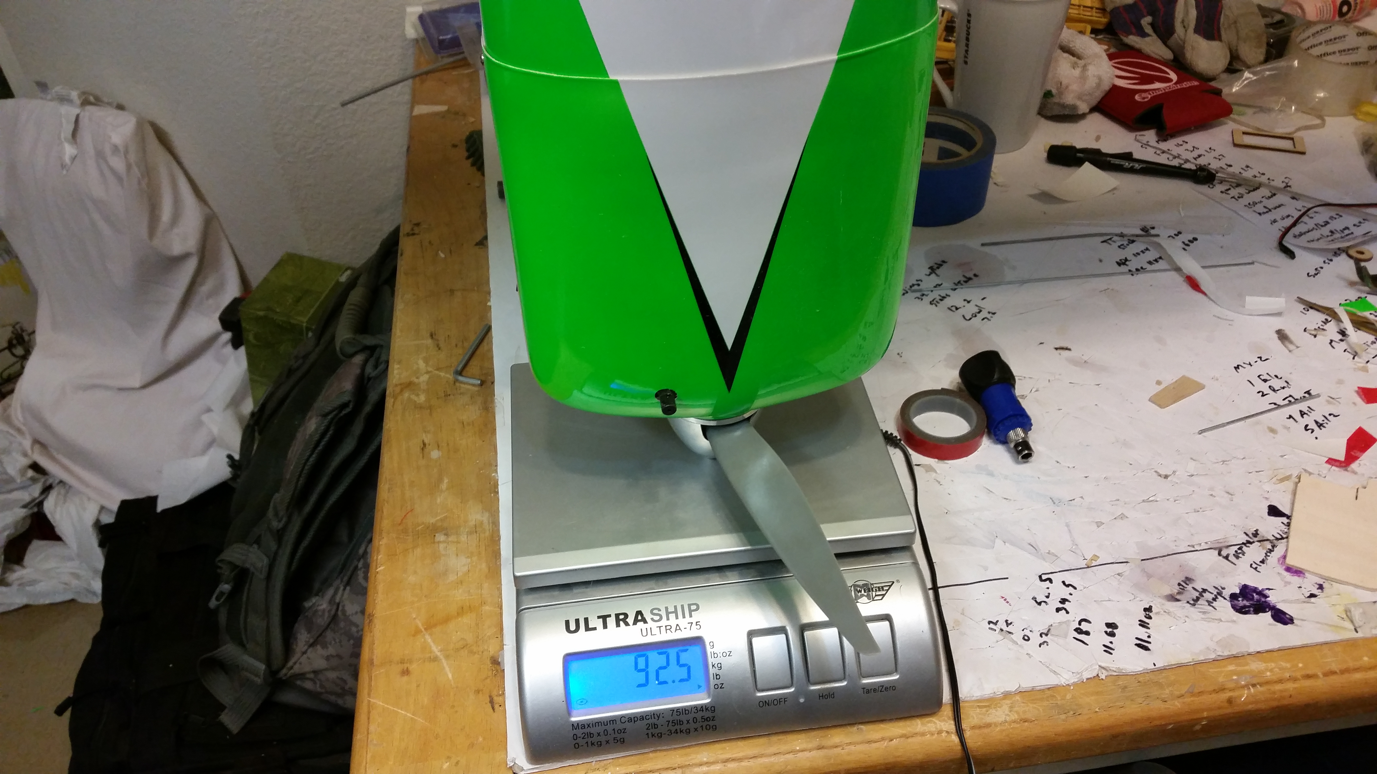

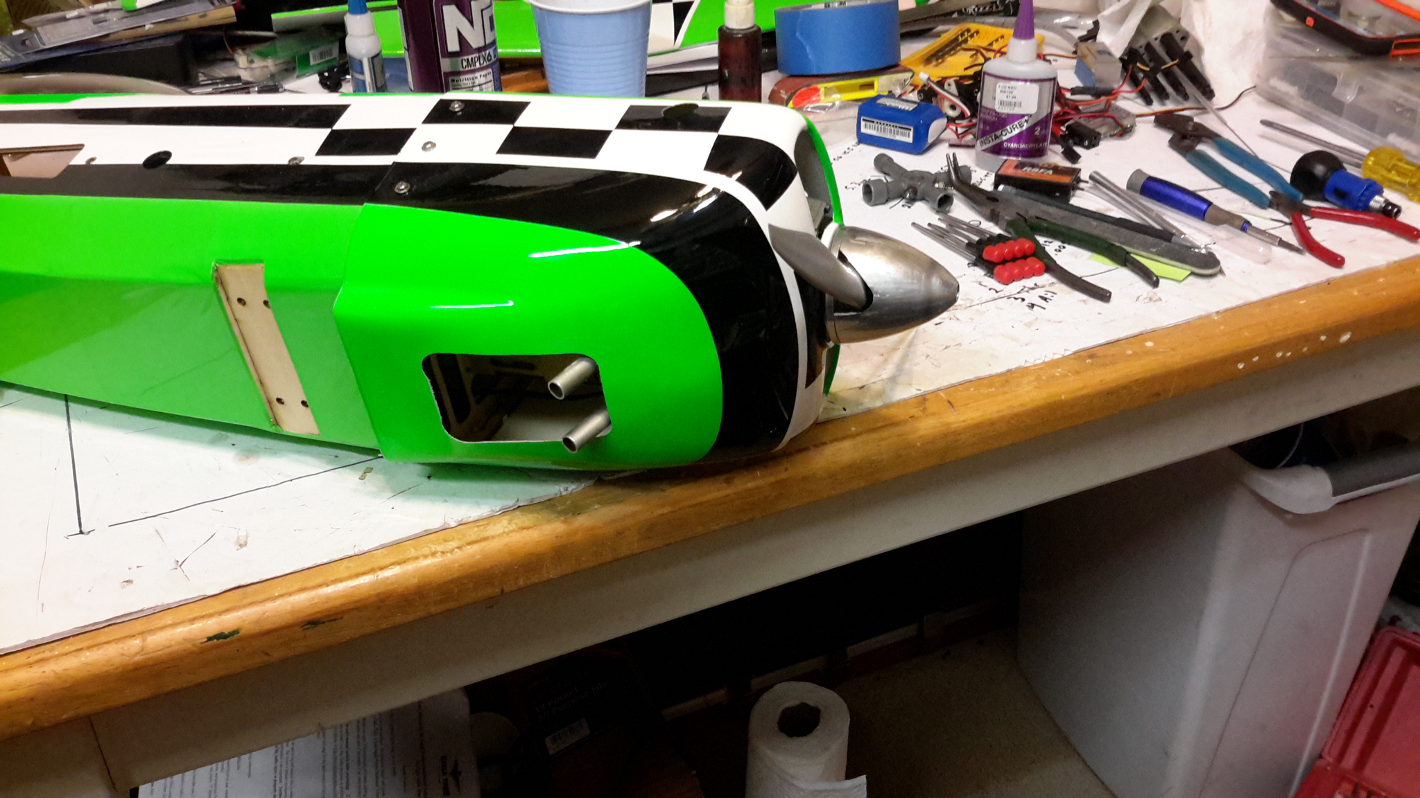

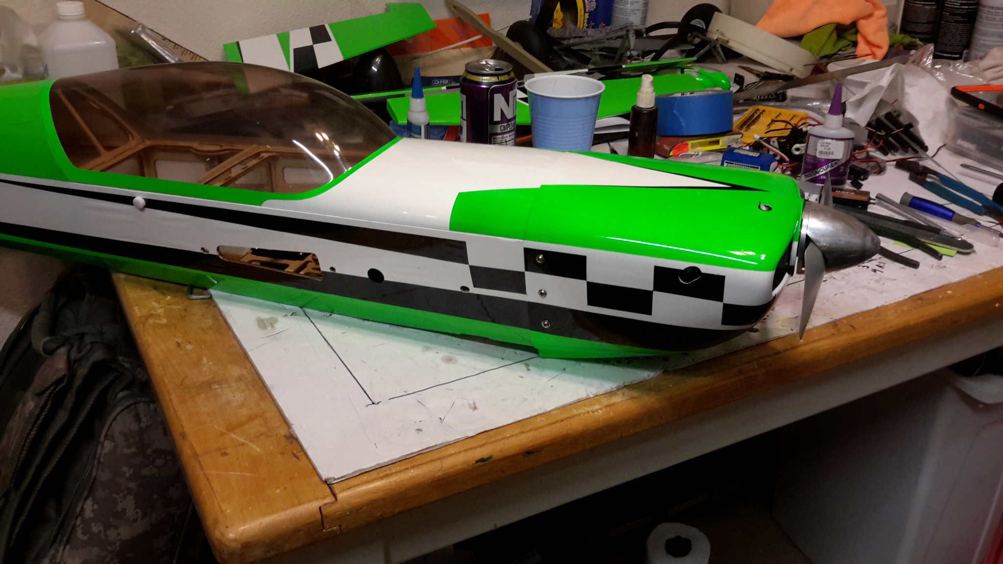

Ok, it is now complete and ready to fly. Everything went really well, it is a very easy building airplane. I really did not run into any noteworthy issues, but as is to be expected a little bit of the hardware was not up to par. Some of the ball links in my particular kit were just way too tight and no amount of exercising them would loosen them up. But that was really it.
I did cover the motor box and the F2 former, it looks clean and a ton of air will not be going through the fuselage. Since it is not electric I do not need the airflow, and I would not have anywhere for it to escape to. I ended up using a small clear plastic cup to block off the non-cylinder side of the cowl. I cut a small opening in it to deflect air onto the bottom of the case, but mainly it is there to block air from going in that side and right back out causing the engine to possibly overheat.
So once all.was said and done it came in at 92.5 oz (5.75 lbs) which is 1.3 oz less than my initial estimate, and about 4 oz less than my initial.goal. I do not know exactly how much thrust an APC 13X6 spinning at 11.5k makes, but I do know that it is over 7 lbs which should give it a better than 1:1 ratio even with 6.5 oz of fuel on board. If I really wanted to I know I could cut another 2-4 oz off by ditching the wheel pants and spinner, but it looks good so I will hold off on that. I really hope it flies as well as it looks!

Ok, so we FINALLY had some nice days to fly in the North Texas/Dallas area! For the last two weeks it has either been snowing, sleeting or raining. Our area lakes have been low for years now and I think that most of them are finally back up to a fairly normal level which is good.
Anyway, I was able to go out and fly the little MX-2, and this is one very, very nice flying airplane. I cannot imagine a way to beat it for a 3D type full airframe for $130, I have not even found anything CLOSE. The knife edge is great with just a very slight tuck (which might be fixed with CG, the 45 degree inverted test seems to show it can come back a bit) and the flat spins are just fantastic. I have not had a chance to fly it just a whole lot yet as I am still working on getting the 10gx engine sorted. I am getting close though, one of the main issues has been that it keeps on spitting the pressure line off of the muffler. The Viton fuel tubing that the engine came with keeps on splitting at the pressure nipple, and Tygon melts...
