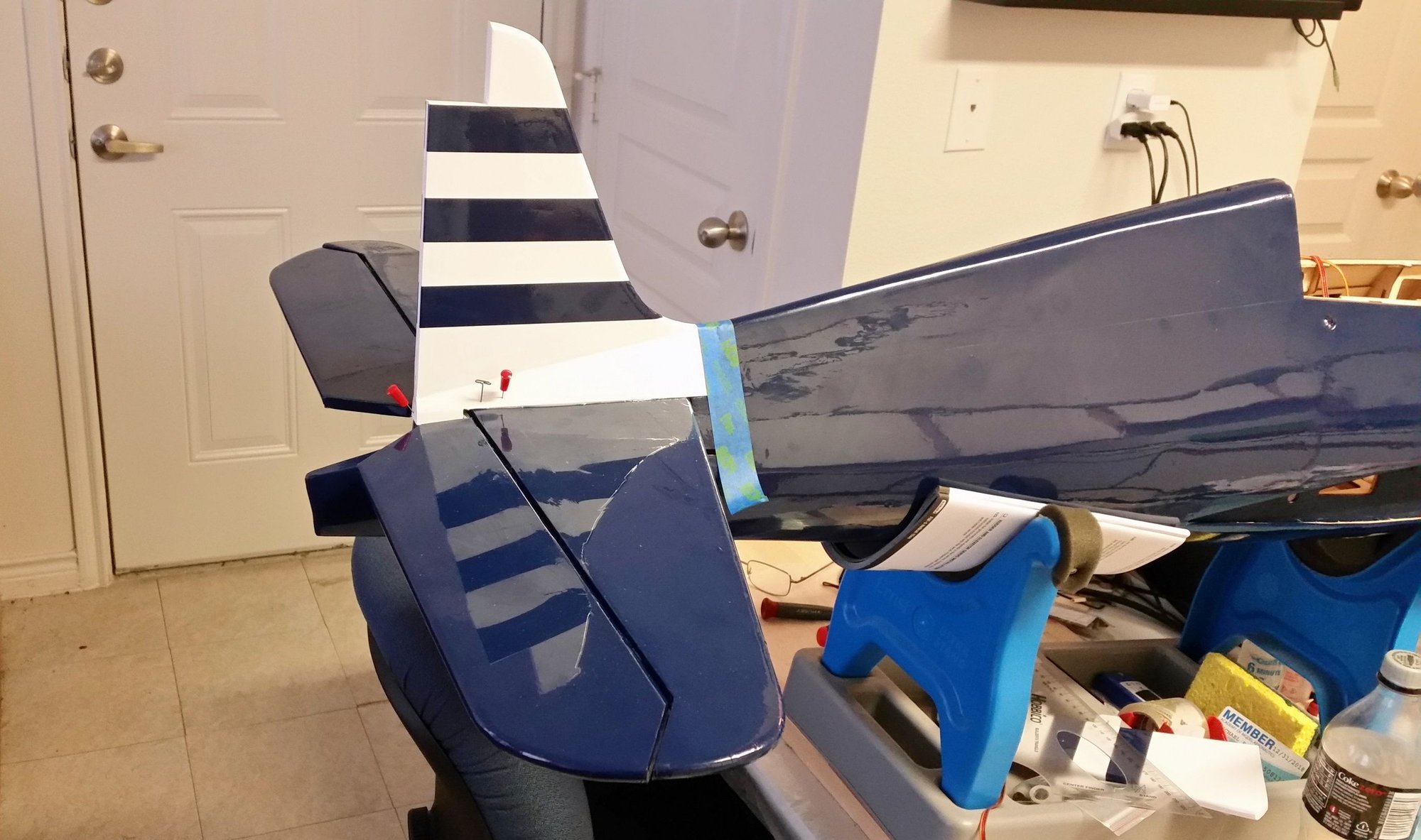

Been working on mine. Its mostly going okay but have encountered a few problems.
1) They want you to use an arm on the rudder that has holes 20mm from center. I'm using Spektrum DS821 and A6060 servos and none of them have an arm that long. Decided to use a TowerPro servo I had laying around that had a long arm in the package.
2) On the left wing panel, the wing tube is VERY tight. I polished it according to the instructions but it's still really tight. Gonna just leave it in the panel as the other side slides on perfectly.
3) The paint on the tail wheel cover comes off if you look at it wrong. When I cut it out I was really careful but it still chipped a bit along the cut line. Didn't look too bad but still not real happy with it. BUT!....when I went to glue it on I used low tack tape like the instructions stated but it still pulled all the paint off of one side. Looks like total crap now. Needless to say I am NOT happy! I ordered the touch-up paint they recommend but the more I think about it the more pissed I'm getting.
Moving on, I'm getting my engine installed now. Using a K&B 1.00 I converted to ignition.
Mike
Elev and rudd servo install
Gluing the tail on. No problems.
First side the tape pulled of with minimal paint loss.
2nd side the taped pulled most of the paint off with it. Looks like crap! NOT happy.

So I got the Tamiya paint in that Horizon recommends to touch up the plastic if the paint chips. Its a bit darker than the kit paint. Its really hard to get good pics in my shop so the camera makes it look worse than it is so it doesn't look that bad from a few feet away. I just touched up the edges and it kinda gives a weathered look like its a panel or something. At least on the side where I just needed to touch-up the edges. On the other side, the big missing paint blob where the tape pulled it off is still a bit unsightly. I guess we'll see what happens long term.
The Tamiya paint is darker so the big blob still stands out somewhat.
The touch-up around the edges doesn't look too bad. The camera makes it look more noticeable than it is.
