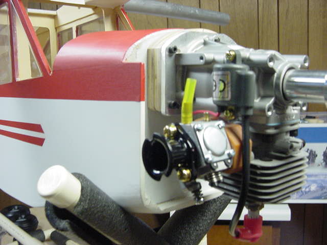

This Zenoah engine plate deal has me really beside myself. For those of you who are not aware of it, the adapter plate for the Zenoah in alot of kits is not only too thin but the engine mounting holes are in the wrong place. Okay, fine- S happens, see my other posts and you will see my fix for that.
BUT, and thats a big BUTT, having followed the directions, I drilled the firewall holes as described. Now when I bolt the engine/plate assembly the screw heads hit the timing cover and bind. SO I moved the holes outboard slightly. Right side fixed- Left side hole interferes with triangle backing stock for firewall and no room for blind nut. ARGH!!
My fix - I am going to tap the two, original, lower holes in MY (not Zenoahs) aluminum adapter plate to accept 1/4-20 SS panhead screws from the inside of the fuse. This will get the heads out of the way and allow for the use of a monster screw(never a bad thing).
The final verdict- in the three weeks I have had with this airplane- I have spent the majority of the time dorking with this motor bolt-up. granted my time IS limited- but this bird should be flying by now. I easily have 6 hours of work in the engine mate-up and it still aint' done. Not because I am slow or because I am inexperienced at building- but because somebody else fouled up. I can get this kind of abuse at work.
Oh and thanks Horizon.. for your nonexistent reply to my questions about this problem.

Thanks for the motivation to finish this bird. I found the page on Horizons site describing the problem just a few minutes after I discovered there was a problem.
I did not use the original backing plate from the motor, the manual said to take it off. I did throw away the foul adapter they sent and made one of my own in 6061 billet Aluminum. See my link below- I should make parts for these guys! [8D]
http://www.rcuniverse.com/forum/m_11...tm.htm#1153856
I am in the metal business so it was no problem to take a few minutes and make the plate myself. The weight difference is negligible with my lightening holes.
Let me re-state my position on the airplane. I love the look, assembly and quality of the kit. A rant, however, is a sometimes irrational outburst caused by frustration or other stress. [sm=tongue.gif]
I am fine now and plan to have a flight test in 2 weeks. I may load the camcorder into it for the first flight. They are always fun.
*** Build update--- I placed a 3/8 hardwood square stock between and just aft of the alignment holes in upper fuse. There was a lot of flexing there when I placed fore and aft load on the wingtip. Maybe not needed but the covering stopped wrinkling there now.

Nice job on the mount... I kept both the plywood mounts (glued them together), threw away Zenoah mount, and made a new 1/4 alum mount to replace that ... the fix at H9 support had the holes on wrong place... ughh.. ended up with 6-1/4 from firewall to prop washer.[8D]
