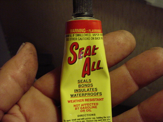

I found this stuff at the hardware store....works good.
It turns into a clear, semi-flexible plastic....
Dave.

I have used RC56 successfully for years on canopies but am now finding that it doesn't hold well on canopies in some ARF kits. Perhaps its the canopy material or the fuselage covering material. Have also found that these canopies can't be dyed with RIT dye. I still use RC56 but have been using small screws and/or trim tape to backup the glue.
Goop and Seal All have been suggested in this thread and I might try those on test surfaces. Thanks for sharing your discoveries.

Note on the Seal All- you gas burners in particular-I have used it for years to seal leaks on automobile gas tanks! If you have a clean surface, it will stick even when gasoline is running out of the leak!

You can get a real nice small bead with it, right out of
the tube....and it dries really fast as well.
