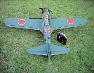

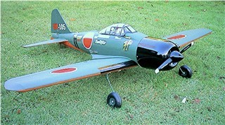

This ARTF model from the Seagull stable is very well built. The model went together without any problems. The only slight downside is the under-carriage wire which protruded too far forward and I had to remedy this by bending the wire legs back in a vice.
Also the supplied hard foam wheels are unsuitable for flying off and landing onto grass strips so i replaced these with better quality wheels.
An S.C. 52 2-stroke is fitted with an in-cowl muffler.
Flight performance is very smooth and crisp and landings are easy. The model is a little heavy at nearly 7lbs. but she flies really well. The supplied model was silver grey so I repainted this in dark matt green with orange underneath to match the Zero training colours.
This Zero is well worth the money. Outstanding!

The re-paint looks great! Does it have any tendency to nose-over in rough grass?

Wingspan is 59 inches. Wing area ia approx. 620 square inches giving a very respectable wing loading of 25 ozs per sqare foot. Engine range is .46 - 52 2-strokes.
My SC 52 2-stroke is fitted with a Master 12 x 6 prop which produces excellent reliable power.The model is supplied with engine mount , tank, fittings etc.
Flight performance is excellent with plenty power from the .52. There are no tip stall tendancies and rolls and loops are crisp and smooth. Once again no tip stalls are evident at slow speeds for landings. The model does not tip over on landing. An excellently built model from Seagull with very good flight charactoristics. It really looks good in the air at scale speeds!

I used Prymol as a primer base and repainted the Zero using Flair matt olive green. Two coats were needed.
