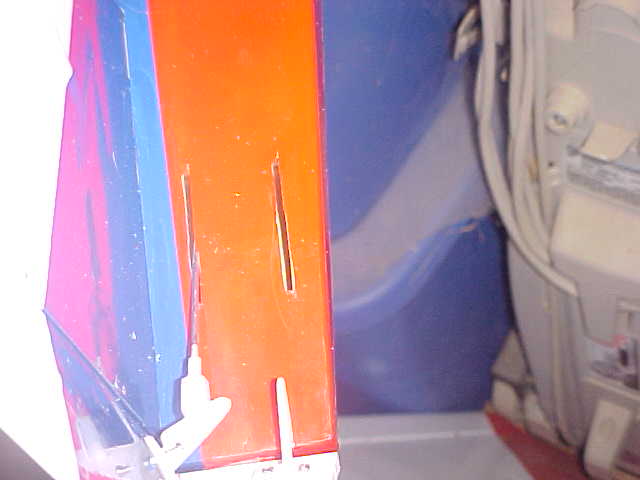

Gang I cant seem to find the manual and im ready to install the rods to the tail surfaces..question is I cant find the exit slots under the covering? Are the slots there or not? It sure doesnt feel like they are.
Any help would be appreciated, if you have pics id love to see them where to cut the exit slots on this thng. Its very frustrating as this thing is almost done.

I just took an exacto knife and poked the fuse side until I found the slots. Heres a pict of what they look like and where they are.
Miloh.

so they are back in there huh?

Yes,
the assembly manual is a bit mis-leading. It would have you believe that the slots are one on each side, but mine were not. Not to worry though, I found mine just as pictured above and the control rods do not rub or bind.

ORIGINAL: DiabloKid
thanks
matt
Run your finger over the general area where the slots should be...you should be able to feel them under the covering.
