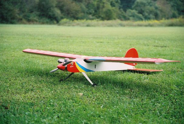

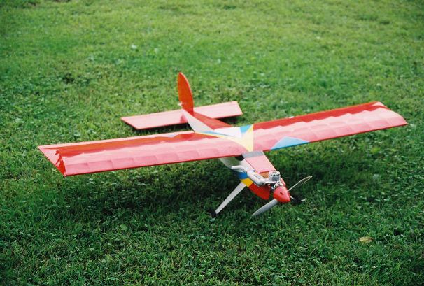

Low wing stick? You mean like this?
It's a Joss Stick ARC. I just turned the fuse upside down and mounted the wing. I did mount the tail feathers on the opposite side of the fuse. as well. I was afraid that if I kept the elevator and horizontal stab in the original spot that it might get hung up on a dipsy landing or that it may not handle the grass field with the tail on the bottom-- in the original spot.
I added a hardwood block to the area for my tailwheel mount. I glued the tail surfaces on the top------and I got lucky and didn't screw up the incidence.
Mount the tail first and then use an incidence meter to set the wing with the tail. You can shim the wing saddle if you need to. Mine was fine.
You will probably have to add a few washers to the engine mount. Most sticks have a bit of downthrust built in to the firewall. When you flip the fuse.; you will have up thrust. Thats why you'll need the washers to correct the engine thrust.
I added a bigger rudder to mine. It still won't knife edge. I don't fly it anymore. It's retired out in the garage.

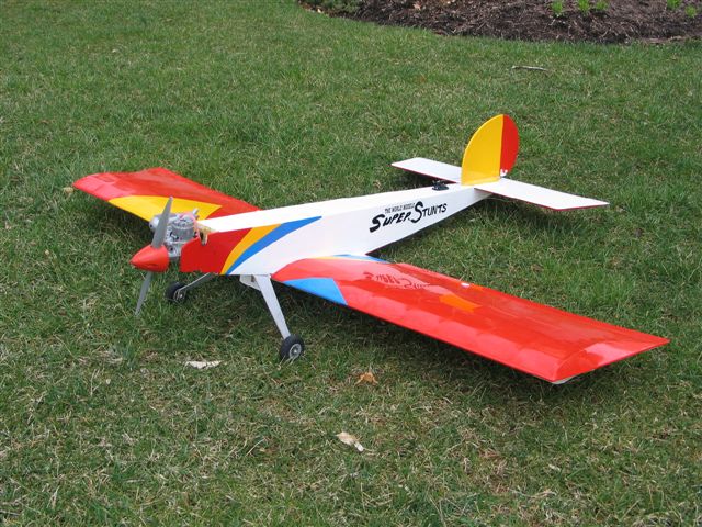

I successfully converted my World Models Super Stunts 40 to a low-wing for the "ARF Modification" category in my club's building contest. I didn't install a cockpit or change the shape of the fuse to improve the looks, but the finished product looks fine and flies very well. I had to build up the wing saddle to fit the shape of the wing and install a front bracket to mount the wing, but those were the only difficult parts. I did add some washers under the engine mount to maintain the proper thrustline. Putting the rudder servo in the rear was mainly for simplicity -- it let me avoid creating a new route for the pull-pull cables inside the fuselage. The CG was perfect with everything else in its original location. The plane flew absolutely perfect from the first time out with just a little tiny bit of elevator trim.
Here are some before and after pictures.
