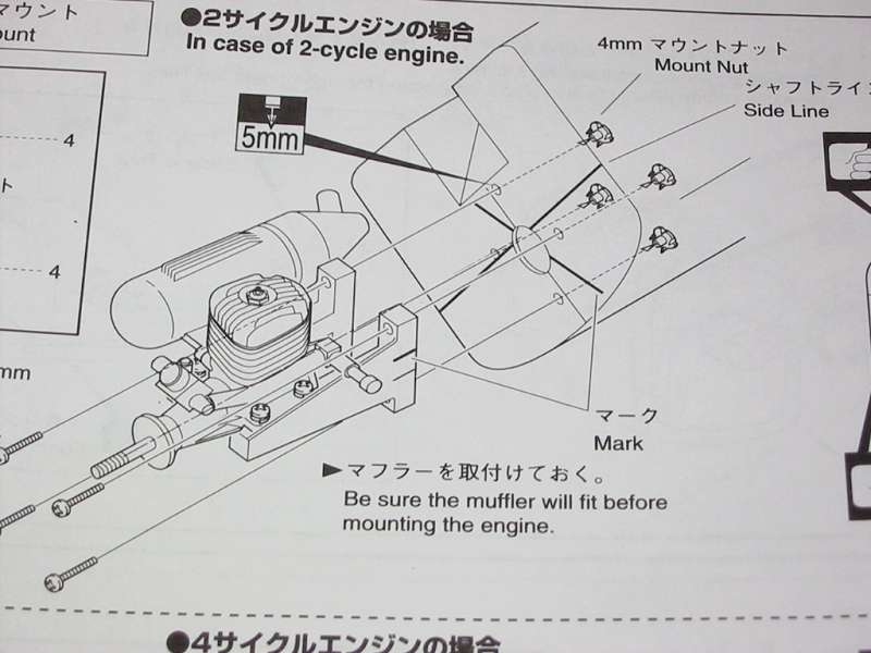

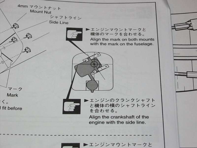

Hi, I am in desperate need of some information from the manual. I bought a used Kyosho Cap .40 size and got no manual with it. The original owner used a .32 size engine and I want to go bigger. I am using an OS 61FX and need information on how to mount this beast. If you have a manual and can get me a copy of the engine mounting section I would appreciate it. Also if you have mounted an engine that big on this plane please chime in…

hosam you will not have any problems flying this plane with a 60 in it and in fact will save you from haveing to add weight in the nose for balance. I had a T.S. 75 in mine and thought it was just about perfect. I don't have mine anymore, I traded it for a 1/4 scale cap and the manual of course went with it but I remember I had the motor mounted at an odd angle so the muffler would line up with the exit in the fuse.

useful info:
I just completed mine. For a 2 stroke, you want to line it up with the horizontal line and the line that is at a 45 degree angle on the firewall. You motor will be mounted at a 45 degree from sideways with the jug pointing in the downward 45 angle. Attached is a pic you might get an idea of. The angle is for muffler to dump out the bottom. I installed an O.S. 50sx on mine. Sweet flying plane. With the 50 on, it will knife edge pretty good, but wants to pull towards the belly. the instructions say to insert some washers under the motor mount for some up thrust. I didn't do this and going to before the next flight. Still don't have calon on though...

Capt_Kc, I noticed that the previous owner had a 35 degree mark from the horizontal but you did 45 degrees. Was that by choice or per instructions?
this ought to help. Sorry, I was wrong. Its not 45, its more like what you said around 30.... I used a gp mount instead of the one that came with it. make sure that your motor is just a tad lower than the horizontal line. If you notice, they have a line drawn going across the fuel tank outlet that is just a little lower on one side of the hole. I am in the process of trying to get my calon on and its going to be slightly cocked upward. I still had to cut my calon up on the bottom allowing for the muffler though. Haller if you need me to take any more pics.

guys thanks for the help I finally got it. installed the engine tonight and will finish it hopefully for the weekend...Hosam
