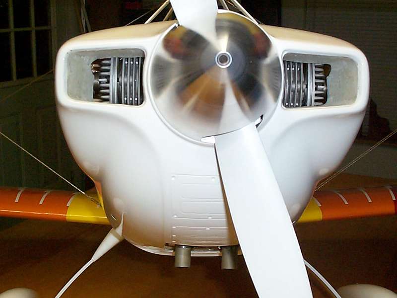

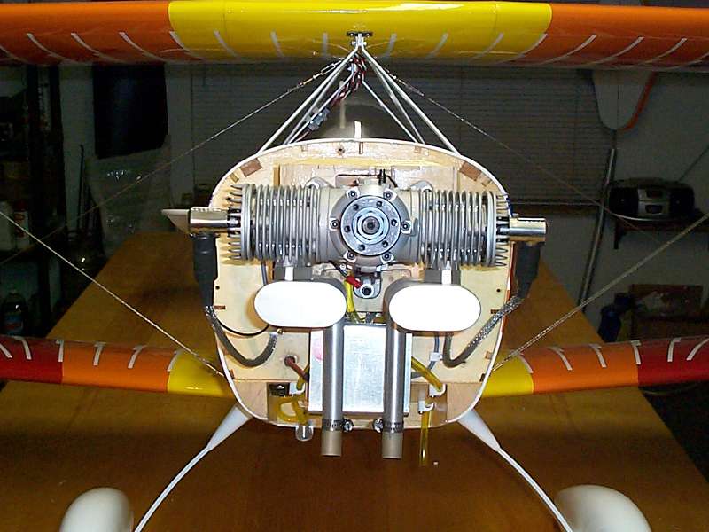

Putting an RCS 44 twin in mine. Ran it today for the first time with a 20x6-10 for a couple of minutes. I will run it again tomorrow with a Pro Zinger 20 x 10. I'll post pictures soon of the install. If I can recommend an engine for anyone, stick to a single cylinder!!!! A lot of work otherwise.
Paul

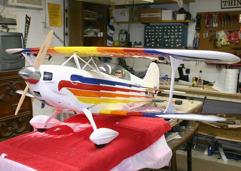

I have a 3W-75 in mine with a 22-10 3-blade.
Wight is a little over 18lbs, throttle mgmt is a must!
I have over 100 flights with mo problems!
