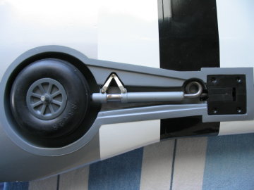

These are spring air #704 retracts with lite-flyte products struts. They are excellent for this plane. I have had no nose over problems with this gear and they are rock solid. Will cost about $230.00 for gear and struts.

Did you have to shim the gear to get the wheels in front of the leading edge. Any thoughts on how this set up will work on grass?

They will be excellent on a grass strip. I cut out about 1/8 inch on the front gear rail so the gear would move forward a bit. Was very easy to do. Took about 1/2 hour to install this gear.

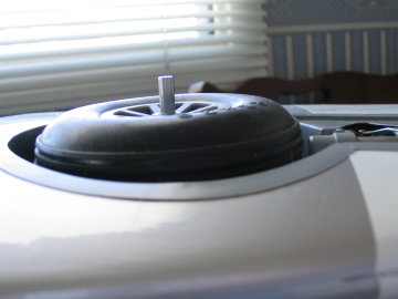

I posted this is another thread but I think it will be OK here also. I am building right now and have turfed the stock wire landing legs in favour of thicker wire ones frfom Spring Air Retracts and then installed the Robart offset #653 Oleo strut. Problem now is the wheel sits too high in the wheel well. Looking for a narrower tire.....any suggestions?
