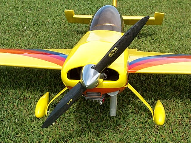

I flew this plane all summer with the CG set at 5 5/8" with everything in the stock position. Really like the way it flies and does 3D great.
Here are the pics.
