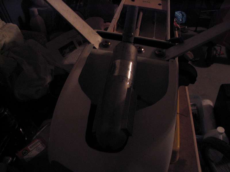

I'm using an Irvine .53 with a header exention...the extension was to help the larger muffler clear the bottom of the fuselage...made the muffler appear to hang slightly lower, but still looks very nice. You can see in one of the pictures that I cut a significant amount of cowl away to let airflow escape...NO PROBLEMS with overheating.
