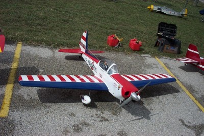

Default Picture
I have a pic of the Chipper that I did a few yrs. ago
