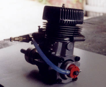

Super Tigre 91
Have two of them on the VQ P-38 and no problems. Believe me, I am very picky about reliablity on a P-38. Am using 15% fuel, and Master 13x8 three blade props. Also, I like the three blade props. Have Jtec Muffler, inverted style.
Hope this helps. Also runningf four more on twins, but not inverted.

Twinman,
as many G91's as you have maybe you can help me. I have one on my VF 66" Extra 300S. It runs great! The first start of the day needs alot of prime but from then on it will start with a flick of the finger. The problem is, it will idle down and run good for maybe a min. then it goes into a lower idle speed and depending on how fast the idle was set it may or may not continue to run. It is like it has a high speed idle and a low speed idle but you never know when it is going to go to the low idle. It makes for either a hot landing or a very scary low slow and dirty stall landing. I changed to a perry carb and even put a new Super Tigre carb on and it doesn't change. Running a 14x6 or 13x7 prop doesn't change it either. It only has about 3/4 gallon of fuel run so maybe it just needs broken in, I don't know. It is mounted sideways and am using PowerMaster 15% nitro 18% oil Any ideas?
While your waiting on Twinman to answer I'll put in my 2 cents.
I had a Super Tiger .90 in a TF P-40 inverted.
1. Ran totally stock including carb.
2. Ran 15% red max fuel
3. 13.5x8 Graupner prop
4. Ran great, started easy, (mine would flood easy so look at your plumbing set up to see the tank center line).
5. Used a hemostat to shut off fuel when shut down because fuel would siphon out due to tank level.

JDS Thanks for the info.! I have the engine out of the plane and will be running it on the bench this weekend. I have the manual and tried adjusting it to the book but no luck. It runs great, good response and all just the idle is not consistent or even close. I tried switching plugs from Fox to OS it seems to like the #8 plug the best. I am going to install the perry carb. and start over with the adjustments and keep a log of everyhing, good advice, Thanks!

Hey, it's thanksgiving and I am tweeking my VQ P-38.
I really cannot add to the above comments. It does sound like an air leak. I would also consider checking the back plate gasket and the older ST's had a front plate also. Turning the bearing plate allow counter rotation.
I would really go to 15% fuel or check your fuel. Hey, you don't have a check valve in the muffler pressure line do you? Don't. I have also found the ST's may or may not like after market mufflers due to loss of back pressure.
If you decide to change the carb, and I really do not feel this is necesssay, but I did it for more power. Here is a post I did for my club newsletter about getting more power.
Good Luck,
Twinman

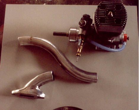

Exhaust Modifications
1, Many engines can benefit from increase exhaust flow. Larger mufflers and tuned pipes are several good and expensive methods.
2.A properly set up tuned pipe on a two stroke can and will (I have tried it) gain upwards of 1200 RPM. Draw backs are cost and a rather "peaky" engine. Peaky is defined as an engine that increases RPM normally and then instantly screams up 2000 to 3000 RPM! Not good for many smooth maneuvers, but impressive. Watch out for this jump on take off, or the plane will dart sideways. I finally decided not to peak and only gained 600 rpm on a 14x6 and left it at that.
3. If you fly many of the OS brand engines, you will find a conical shaped cone inside the muffler. Unbolt the muffler, and remove this baffle. Reassemble the muffler and retune the engine.
I have found no increase in .25 size engines, but have seen 300 RPM increases in the ....40 size and larger. Yes, it is slightly noisier, but not objectionable.
4. Another trick that I have found simple and cheap is to add a second outlet to the muffler. Find the hollow threaded rod used to secure the light socket in lamp shades and the two small flat nuts. Drill into you muffler case ( if you have a muffler that you can dissemble) for the hollow threaded rod. Tighten the flat nuts against each other to lock the hollow rod in place. (Note, One inside the muffler and one outside)
Results: On a Supertiger .40 a solid 300 rpm. Note that this decreases the muffler back pressure and cause lean conditions in some engines or applications. It is also slightly messier than stock. This can be improved by using two of those silicon exhaust deflectors ( and it looks neat!) As a side note, the sound quality changes to almost a twin cylinder sound due to different exhaust outlet timing.
5. While on the subject of those silicon exhaust deflectors- Yes they do keep the airplane cleaner, however, they also cost around 200 RPM or more, loss of performance. If you must use them, then use the largest one possible to reduce loss of performance due to increased back pressure, or go to the twin outlet idea.

I know all about the peaky Supertigre's on pipe.
I have a G90 piped and pumped and low and behold, the supertigre carb is GONE!
Why because it's a pain in the rear to get a reliable midrange.
I swapped it for an ASP 108 carb and never looked back
The idle is super slow and super reliable, and the top end picked up roughly 200-300 rpm from the larger venturi.
OH yeah, and an OS F plug seems to help the idle.
Here's the Supertigre with my custom header and the ST carby which lasted one trip to the field before being relogated to the "crappy parts" box.
