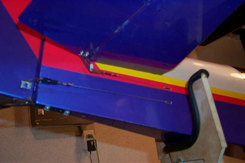

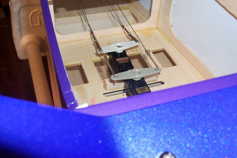

Instruction tells you to put the elevator servos and rudder servo off centered, one on each side. But I find that the pull cables will rub a bulkhead unless servos are centered as much as possible. Besides, centered pull-pull setup will minimize differential in elevators. There is still a little. Unless you mount the elevator pull-pull servo horizontally, there will be some differential with the 2-piece elevator. So I did a little custom mod...
And of course, the upper one in the image (lower in plane's perspective) is rudder, the lower one in the image is elevator.

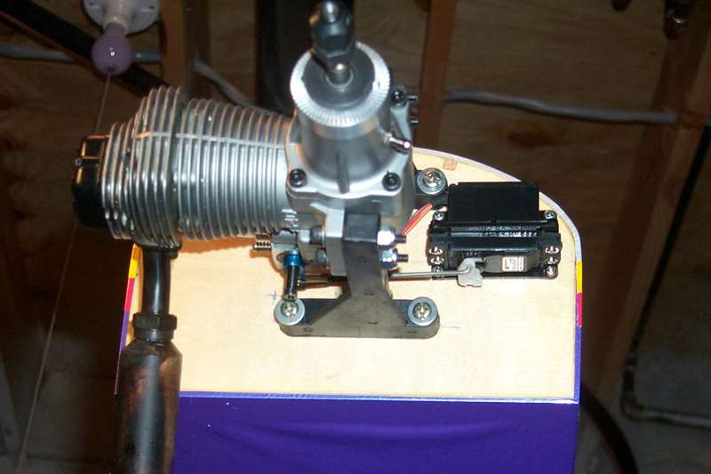

Mounted the throttle servo on the firewall.
Reinforced firewall w/ pinewook stocks. I did this because I know of someone who shaked the firewall loose w/ a YS 120 just during break-in.

Why did you decide to mount the throttle servo on the on the firewall? Was it going to come out tail heavy? Have you ever done it that way before? If so have you ever had reliability problems with the servo?

Oh, I just don't like the slop of a long, unguided pushrod.
Some .40 profiles have the throttle servo right behind the engine, and they use micro servos. I think a standard BB servo should work fine for 155.

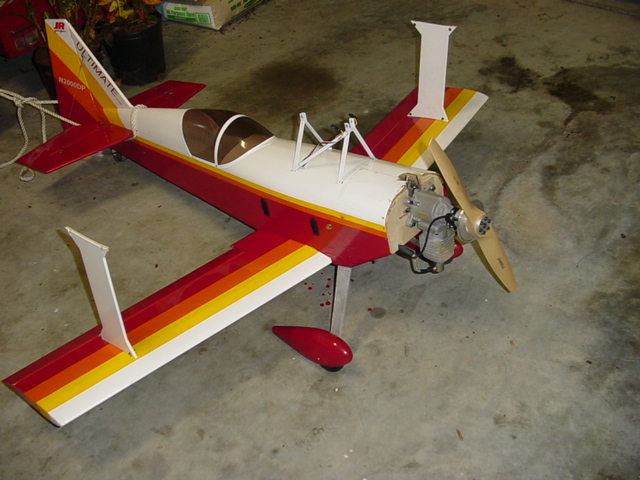

Old 12-21-2003 | 12:01 AM
My Feedback: (31)
Posts: 7,415
From: Kannapolis, NC
Default RE: DP Ultimate pics please
Frankenthumb:
I did all of those engines the Satio 180 1st, i thougth this is great excpet the cleaning that was required after those flights. This made me switch to the RCS 1.4; at 12 3/4 lbs the 1.4 just did not have what it took to do anything other than fly around like the plane was a Great Planes spacewalker. I could only get about 200-250 feet of verticle. So off came that set up and on with a OS-160; that is one powerful engine and very good gas mileage. I did this for quite sometime until i folded my wing on my Desert Aircraft 77WS funtana. I hated having the zdz 40 sitting around so i pulled the ultmate down and went to wrok putting that zdz in there with a can set up. I like that deal and the power is great its like flying it with the os 160 excpet with a 20 inch prop.

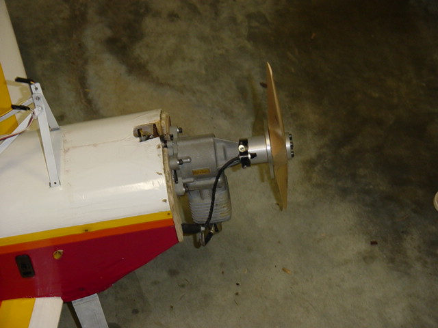

this is a very quiet set up i might add
