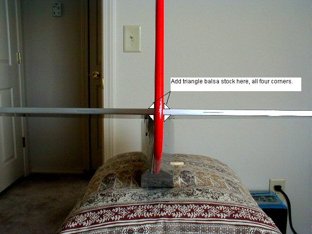

I would use 1/4" triangle balsa stock for the tail surfaces. Use four pieces, one on each corner where the fins meet the fuselage, top and bottom. See pic:

In the first and second pics, you can see where I would put the triangle balsa. In the third pic, the red dot is where I drilled a hole to put the silicone caulk in to balance. Drill the hole in line with the wing spar, so that adding the caulk won't mess up the front to back balance of the plane:

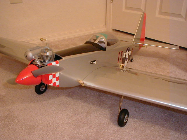

I put up pics of my setup on the other LT P-51 thread in the Fun Fly forum...
http://www.rcuniverse.com/forum/m_13..._1/key_/tm.htm
I only put tristock under the tail. Seems to be fine, and you don't see it at all when it's sitting on the ground.
