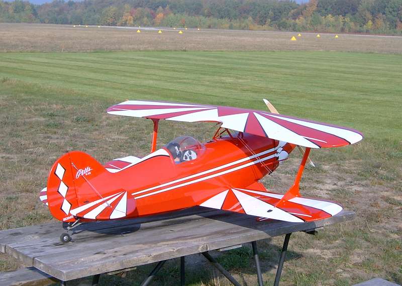

Mine has the Moki 2.10-perfect! It will be flying before you get to full throttle; mine got squirrely at full throttle-increased the right thrust when the firewall glue popped loose-PIN IT! The cg can go back more without causing problems-that will help inverted, knife edge, and point rolls/slow rolls.Good luck...JIM
