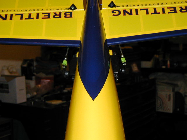

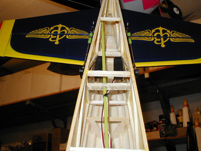

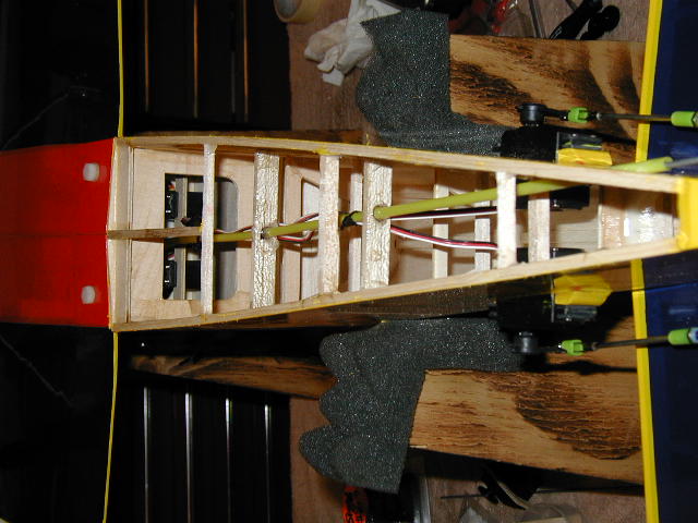

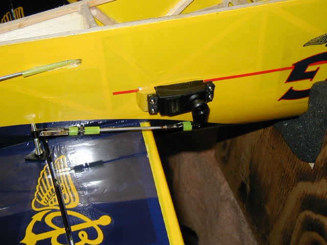

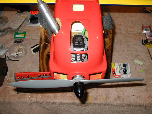

Just about finished my cap. I did some mods to the plane ...the cap had no x braces in the rear portion of the fuses so I opened it up and I'm glad I did some of the braces were not glued so I fixed that and added some extra braces Plus some 1/16th ply for the servos to mount in the rear of the plane instead of servo tray .....Also I used a GP 60/ 120 engine mount ...After I fitted the engine mount I trimmed the ends of the mount to make a better fit and to reduce the weight...I installed a OS 91 FS in it ...It fit great....JW
