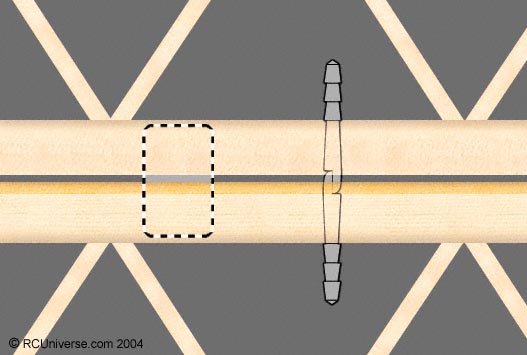

Hey guys....I like the Robart hings points and am considering using them on my J-3 ARF instead of the Ca hinges. Any opinions on just drilling holes where the slots are and epoxying them in? I would think the epoxy would simply wick into the slots further strengthing the slot. Any ideas would be appreciated! Time is not of the essence as it's so cold here in Pa. I won't be finishing this bird until mid spring anyway! Thank you. Bill

Good Point... That is what I was worried about. I also just though about the fact that the ailerons are buit up barn door type and not solid strip type. That means that there is definitely no material in the ailerons to work with, however, if you really wanted to use these hinges, I suppose you could open things up and add some material - but this is probably not worth the effort in my opinion. I plan on nice and easy scale flying for mine so I am not too worried about the hinges.

Why complicate an easy installation?? MinnFlyer has also demonstrated why you should stick with what the plane was designed for.
On a scale plane such as the J-3, there is no reason at all to go to hinge points. The surface loads are low, and so are the speeds. I use CA hinges on every one of my planes up to 1/4 scale and never have problems. Even on my large CAP and Giles with 40CC engines and speeds approaching 100MPH.
If you want a bullet proof, good looking install, try using the CA hinges and then using thin V-shaped strips of clear ultracote to seal the hinge gaps from underneath. You will never have a problem with CA hinge failure or surface flutter again.

On an aerobatic plane with a lot of stress on the ailerons, I would suggest to change them to hinge point. I did that on my Christen Eagle, and glued the hinge points in with Gorilla glue, which expands and creates a plug behind the wood. Works great and is plenty strong. Did a test on a 3/4" balsa and could not pull hinge point with pliers.
OK, as for the GP CA hinges : They are crap quality and break after some use(sometimes after only one or two flights). They simply look like they have been cut in the middle with an exacto. I would suggest you use the 1/4 scale hinges (blue colored) from Radio South. These are the best CA hinges out there IMHO. You could also mark the center line with a crayon to keep it always flexible (to much CA will harden the hinge, and that is why they break).
