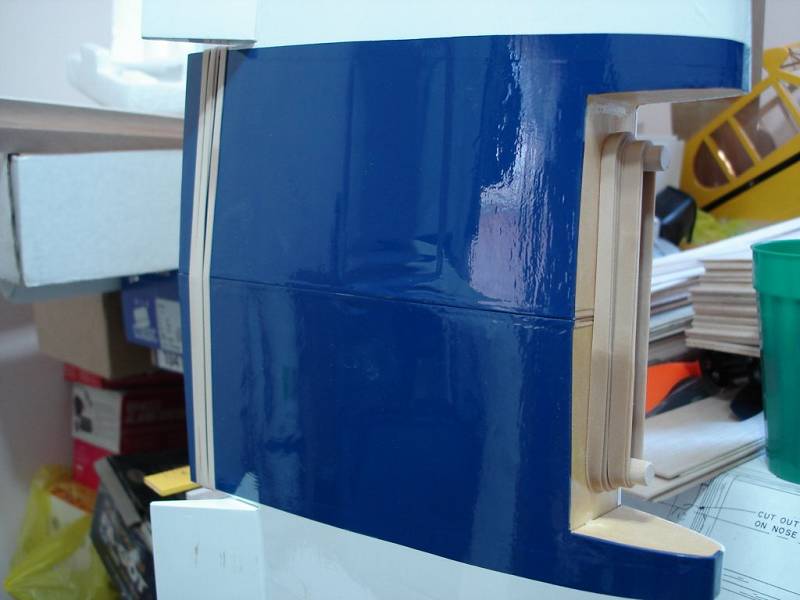

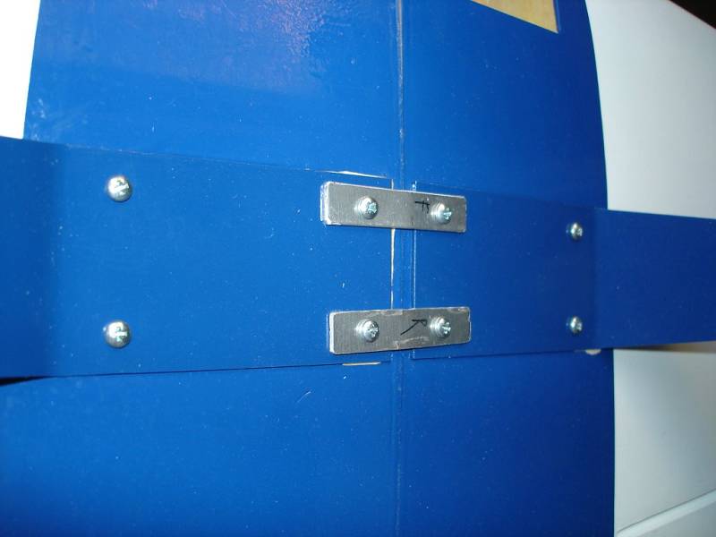

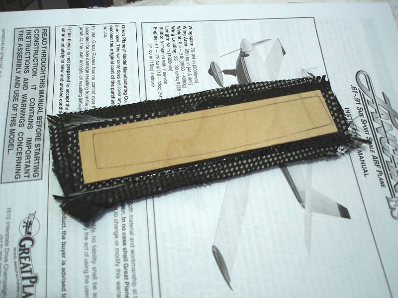

Hi,
Here are the modificaitions I did to combat any potential wing failures. Its a thin wing and any additional strength is advantageous.
I didn't like the light ply joiner that came with the kit. It wasn't thick enough and wobbled front-to-back and up-and-down in the joiner socket. I believe this has a lot to do with the wing failures...no solid mechanical bond. I decided to fabricate my own out of aircraft ply. I sandwiched three layers of carbon fiber, the middle layer at a bias to the outer layers, between aircraft ply with 30 minute epoxy and clamped overnight. I traced the outline of the original joiner and cut out the new joiner. I sanded it to snug fit the joiner box with just enough room for epoxy.
Also, if the covering is not removed from the wing roots, they won't make solid contact with each other during epoxying. There isn't much surface area to begin with since the ribs have lightening holes. A razor plane made quick work of this. I estimate 1/4 of the wing root surface has covering on it. I used rubber bands around the leading edge dowels and around the flap openings at the trailing edge to clamp the wing together during epoxying.
The split landing gear also contributes to wing failures. A hard landing directs all force to the wing root. I made some straps out of aluminum to connect the two gear sections together. Now all I have to do is fly it. Hope this information keeps other Lancairs from suffering wing failures.

Casniffer, you have made some very good mods that don't require a lot of work or extra expense. They should increase the strength of the wing joiner joint. I lost one of my Lancairs due to pilot error on landing (got her too slow with too much flaps - stalled - power on recovery resulted in a snap). If is build another one, I will certainly use your mods, however, my Lancair is built exactly as the directions indicate - no problems with well over 40 flights.

Gerac7,
Did the wing fail at the joint or outside the joint? Did you remove the covering on the face of the ribs? Did you test-fit and notice if the wing joiner was loose in the joiner box? Did you use 30 minute or 6 minute epoxy when you joined the wing? Was your first landing a little hard? I know this sounds like an interrogation, but all these things are valid, important questions.
About 1/4 of the glueing surface area of the wing root is lost because of the covering...and since its on the outside of the root makes it even worse. The manual doesn't mention removing the covering. I re-read the section on joining the wing. If the wing joiner does not fit snug in the joiner box, you are depending on the epoxy alone for strength. As soon as the joiner is subjected to enough stress, the epoxy fails causing the joiner to slip, resulting in the covering peeling away from the wing root. The rest is academic. 6 minute epoxy doesn't penetrate the wood like 30 minute. If the joiner is snug, it should not move and the wing should be able to withstand more stress. Fiberglassing the center section would increase the wing's strength as well.

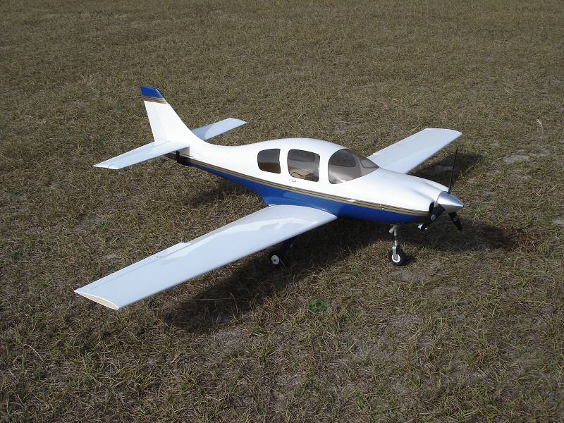

WooHoo!
I flew my Lancair this morning for the first time and it was fantastic. Had to put some down trim and a couple of clicks of right. It had about 25 degrees of flap and lifted off sooner than I expected. Tracked very well. With full flaps, landings are slow and require a bit of power until you're on the ground. Looks like my mods held up. I would like to make the wingtips removable...I have a good idea on how to do that. I'll put the wheel pants on this week to see if I like them. We fly off grass.
