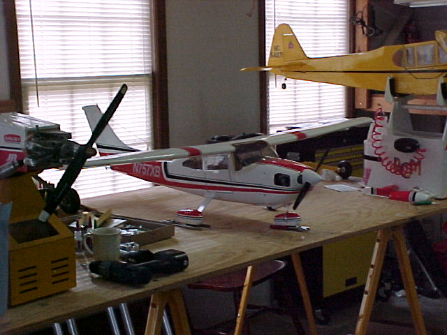

I can't help you on your pull/pull question, But I just finished my cessna and I used Dave Brown pushrods on rudder and elevator.
Sorry to answer your question with a question but are you having any problems with the landing gear splaying out?

I dont quite follow you about what you are asking. splaying, not fimiliar with that term
Old 02-11-2004 | 10:04 AM
Deadeye's Avatar
Posts: 4,516
From: Dutton, MT
Default RE: GP Cessna 182 control surfaces?
I think he means bending outward, or bowing. Sounds as though his gear is soft.
Old 02-11-2004 | 10:14 AM
Hill202's Avatar
My Feedback: (24)
Joined: Jan 2004
Posts: 1,351
From: Peachtree City, GA
yes, thats what Im talking about. I don't know where I got that word from??

The main gear spreading is a result of bouncy landings. Land softer. Making the landing gear stiffer would just make the belly of the plane rip out instead of bending the aluminum. Its much easier to straighten the aluminum than to rebuild the fuselage.
The Pull-Pull or going to 4-40 pushrods on the .72 4-stroke powered one is a very good idea. The 2-56 (or is it 2 mm on that one?) pushrods are really inadequate to that size engine.
