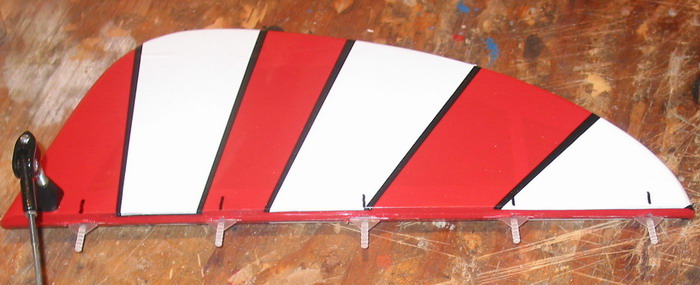

I have a DP extra from the 2nd run. I have not flown it yet, been working on it for over a year. Yes, Im a bit slow! I did make a lot of mods, due to remarks here on line and also mfg. mistakes. My DP Extra has Zenoah G-45 on the nose, and I know someone that used to have a Fuji 50 on one that flew just fine. You see, if you want to mount the elevator servos in the tail, you need a heavier engine in the front. I did not want to install pull pull for the elevators. This aircraft has had flutter issues, at least alot of people have complained. There were many reasons discussed, from "twisty" or flimsy ailerons, to needing two servos and the list goes on. Here is my setup:
Robart hinge points for ailerons
Robart hinge points for rudder
B&B 1/4 scale CA hinges for elevators
Hanger nine titanium rod links
Rocket city hardware
Hitec 945 metal gears aileron, elevators, and a Hitec 5645 digital for rudder.
The reason for The CA hinges in the elevators is due to the stab tube limits installation of the robart points. The robart points need to be cut down, at least two of the points. It leaves little hinge in "meat", and no room to add a hinge block. This is why I went with the heavy CA hinge for the elevators
I also modified for Rocket city hardware. You will need to add a hard points on all surfaces on the top if you use Rocket city hardware and run the screw from the top through the bottom. DP has only a hard point installed on the bottom as stock. The rocket city hardware may not be necessary, but I feel better about it. The rudder already has two hardpoints installed, and does not require mod. I also sheeted my ailerons with 1/32 sheeting top and bottom to "stiffen" the ailerons. I have made many mods, some needed and some well I feel better about. Also, I had a warped right panel out of the box. I fixed that problem, and relized one wing was sanded very heavily compared to the other. It was quite thinner than the other panel. It was really weird. Needless to say, I fixed all the problems, (as it still was quicker than trying to get a replacement from DP ha! ha!) which required me to recover the wing panels. Thus the reason I went ahead and added the hinge blocks ect. So it depends on what you want to do. If you use CA hinges, you should probably try the B&B 1/4 scale CA hinges or the Radio South 1/4 scale. Seems like people like those. I know the B&B hinges are very strong and thicker than most I have seen. Its a beautiful plane, and it will fly this spring! Whew hoo!!! Oh yes, be sure to seal the gaps in the surfaces!

I used DuBro 1/4 scale hinges all around on my DP Extra. I'm completely off CA hinges these days. It is true that the elevator joiner tube can get in the way and you must consider this in your hinge installation.
