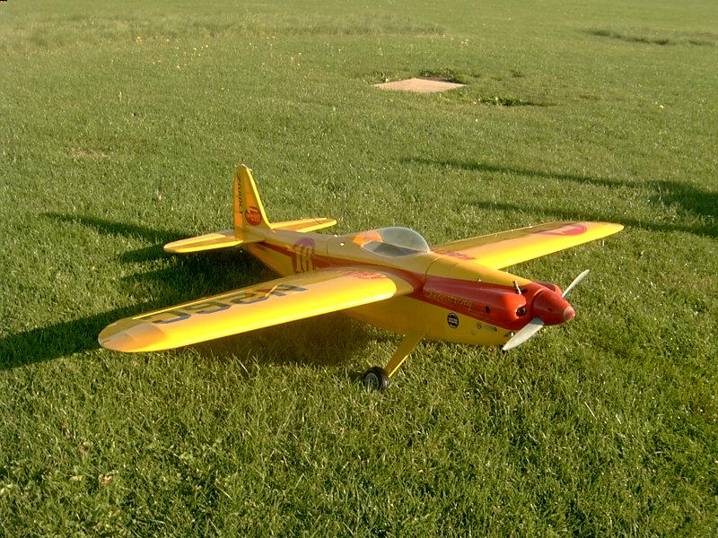

I have the Shoestring with a Thunder Tiger Pro 61 with a pitts muff and it has plenty of power! Yes, more will fit! I know you speed Monsters want to get that 100 MPH speeds. Mine is very fast with the 61. I played with the props to get a little more out of it... To say that it is under powered with the 61 is not true... It flies fine with athourity, with plenty of power. I never put a gun to mine but I must get 80 mph out of it. When I fly at the field I'm as fast as anyone. We do not have races at our field, but we do play. The shoestring is an excellent plane and flys great... I have mine set a touch nose heavy so it does land HOT! Once it touches down on the grass it stops like it has airbrakes. A MUST DO!!! Reenforce the landing gear area... If you do not it will break! I fly off grass and took the wheel pants off and put on bigger tires.
Have Fun

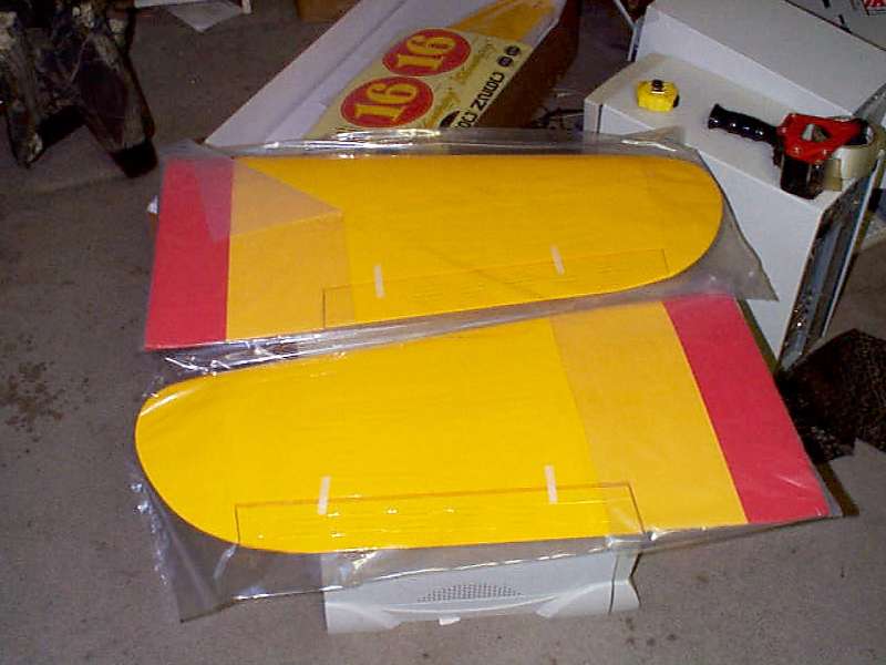

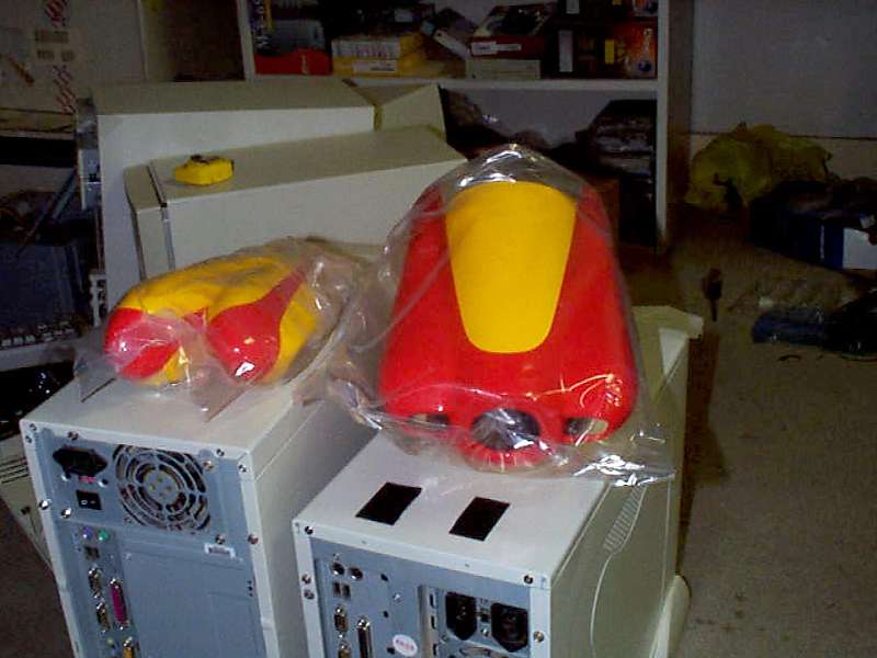

It has arrived! Here a few pics of the product. I am floored by the quality of this ARF. Superb work Great Planes!
Luke[8D]

NICE, ain't it!! Only complaint I had was my large "16" decals were a little wrinkled and hard to get on straight. "If my plane doesn't look perfect you're standing to damn close"![>:]

Primary inspection shows a few wrinkles. I suspect they will draw out easily under a little heat and were probably the result of a very cold transit. All in all I am very impressed with the quality of this ARF.[8D] The parts are individually wrapped and seperated by cardboard inserts where necessary. Hardware out the wazoo. Geez, so many pieces, so little time.

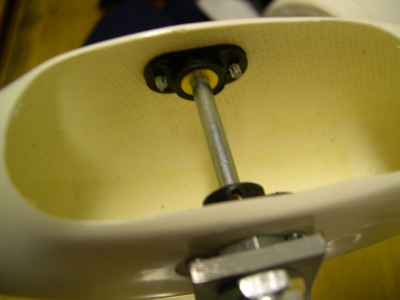

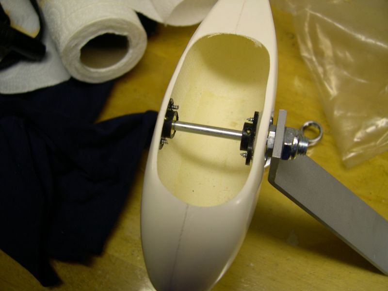

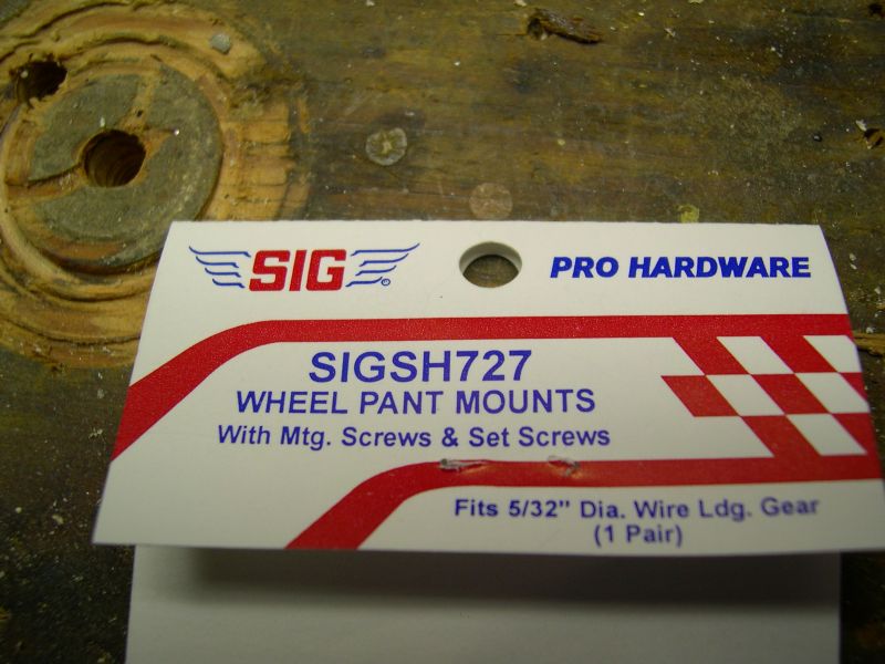

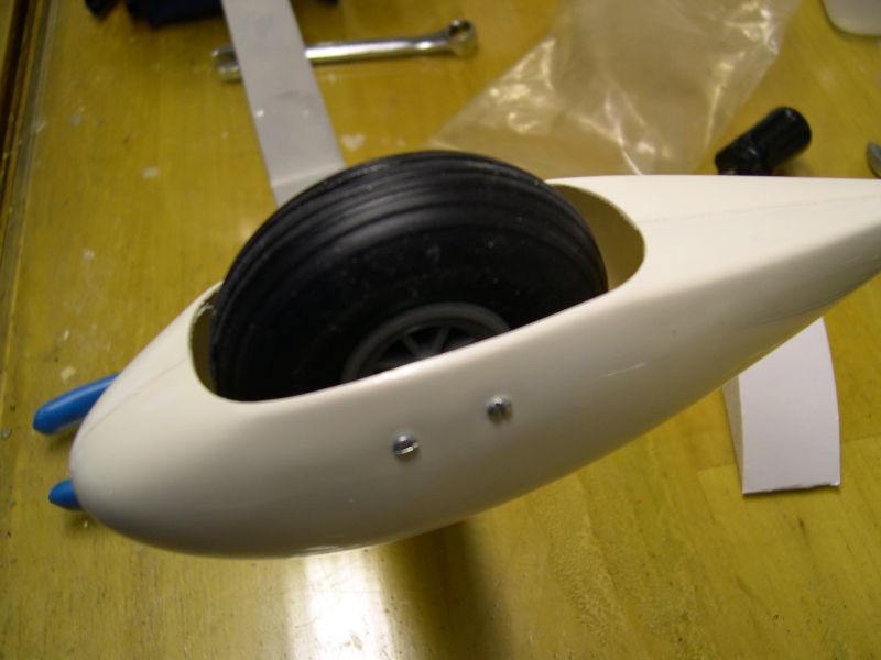

A few pics on how I mount my wheel pants. I use Dubro 5/32 axles. I get longer axles than I need and cut them to size. The Sig wheel pant mounts are made of brass collars set in plastic and a set screw to keep the wheel pant from moving when screwed tight. I grind a flat area on the bottom of the axle for the set screws. I usually use as large of wheels as I can get in the wheel pants. I use two mounts on each wheel pant to keep them more rigid. The nice thing is if the wheel pant gets bumped hard the plastic mount housing of the wheel pant will break before ruining the wheel pant. When that happens just remove the broken one and replace it with a new one. Pics do not show set screws installed yet.
Don't let the wheel rub the wheel pant anywhere or it will act as a brake. Might have to put spacers on the axle to keep the wheels from touching the sides. I fly off a grass field and don't have any trouble as long as the grass doesn't get to long. If it gets that long everybody has problems wheel pants or not. "Waiting for warm weather!!!"
