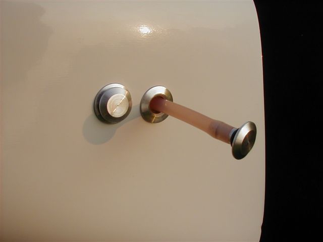

These are fuel dots. The sleeve on the airaft is retained by a nut from the inside of the aircraft.

Yeah these are the ticket. You don't have any goofy custom fueler if you get these. Just unplug the dots (don't lose them) and start fueling. Madsion products makes some called the Miracle fueler. In medium or large tube sizes. They also come with a T. I'd like to drill mine and fit them with tiny wires so they can dangle on the fuse while I'm fueling. I can see losing mine if I drop it in the grass or something. Regardless they are the ticket.

Thats the only draw back. If your at the field without extras, its a big drawback. Quick fuelers are slick. And the "goofy custom fuel tip" fits into any tube as well. Joe

I have had nothing but bad luck with several brands of quick fuelers. On the other hand, I use DuBro and H9 fuel dots and they work great. Since I only take them off when fueling, losing them isn't an issue.

Fuel dots are worry free and trouble free. It is impossible for them to fail.

Hey Richard, I got the idea of how to do my Funtana Cowling from you. Thanks man, what a nice system. Your're right there ain't NO way those dots are coming off. They take effort to remove and that's a good thing.
