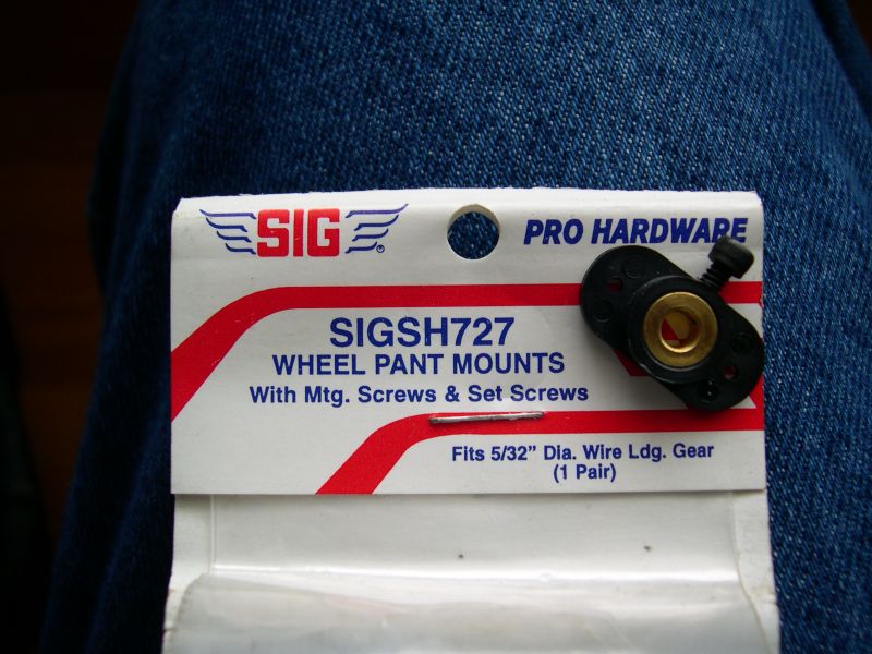

Mettler did they change the SIG part number? I looked up the part #SIGSH727 and the picture they supply is diff. than the ones you have. Any ideas?

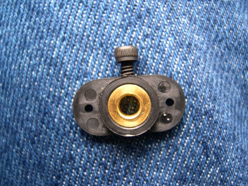

Don't know where that picture came from but that is the correct part #. Here's some more pics.
1- front of the package and the mount minus the screws. Seems I lost them!
2-Back of the package showing the mounting. I use two on each wheel pant but the axle only fits into the second wheel pant mount and not all the way through the wheel pant to the outside.
3-close up pic.
Probably wouldn't hurt to add a little extra fiberglass inside the wheel pant for a little more support.
Hope this helps.

On the planes that have aluminum landing gear and wheel pants, the wheels pants are not screwed the aluminum landing gear but are held on the axles with the Sig wheel pant mounts which have set screws. I grind a flat area on the bottom of the axle for the set screws so they don't rotate. Once in awhile if the wheel pant takes a hit the plastic housing of the wheel pant mount will break. That little bit of give usually saves the wheel pant. I just remove the broken mount and replace it.

Skribnod, the Sig wheel pant pictured on their web site is the sigsh728 which is a wood mount that goes inside the wheel pant and then is bolted directed to an aluminum landing gear. The other ones listed are like the one I pictured in the earlier message and come in 4 different sizes. These slide onto the axle and are attached to the wheel pant and held in place with a set screw. Don't know why Sig doesn't show a picture of those. Hope this helps.
